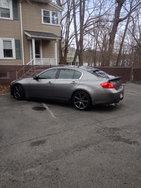

Dropped on swifts also, an my alignment is always a little out.
