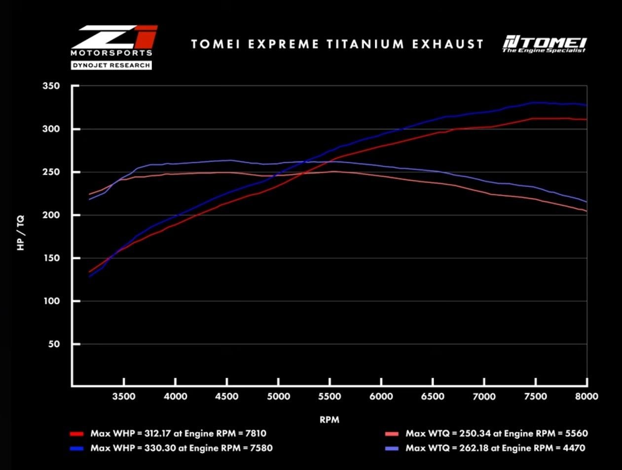

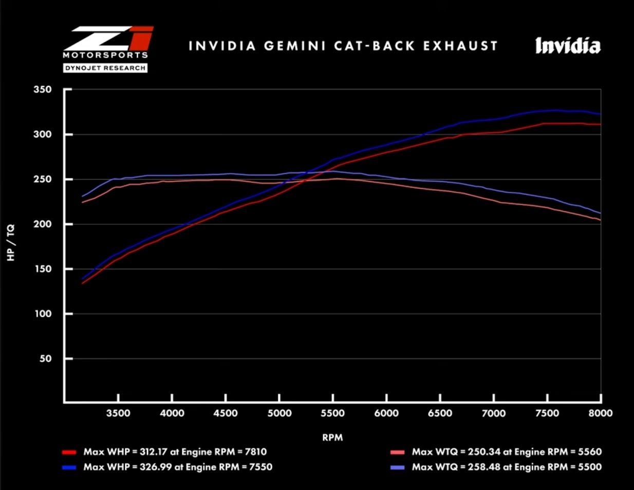

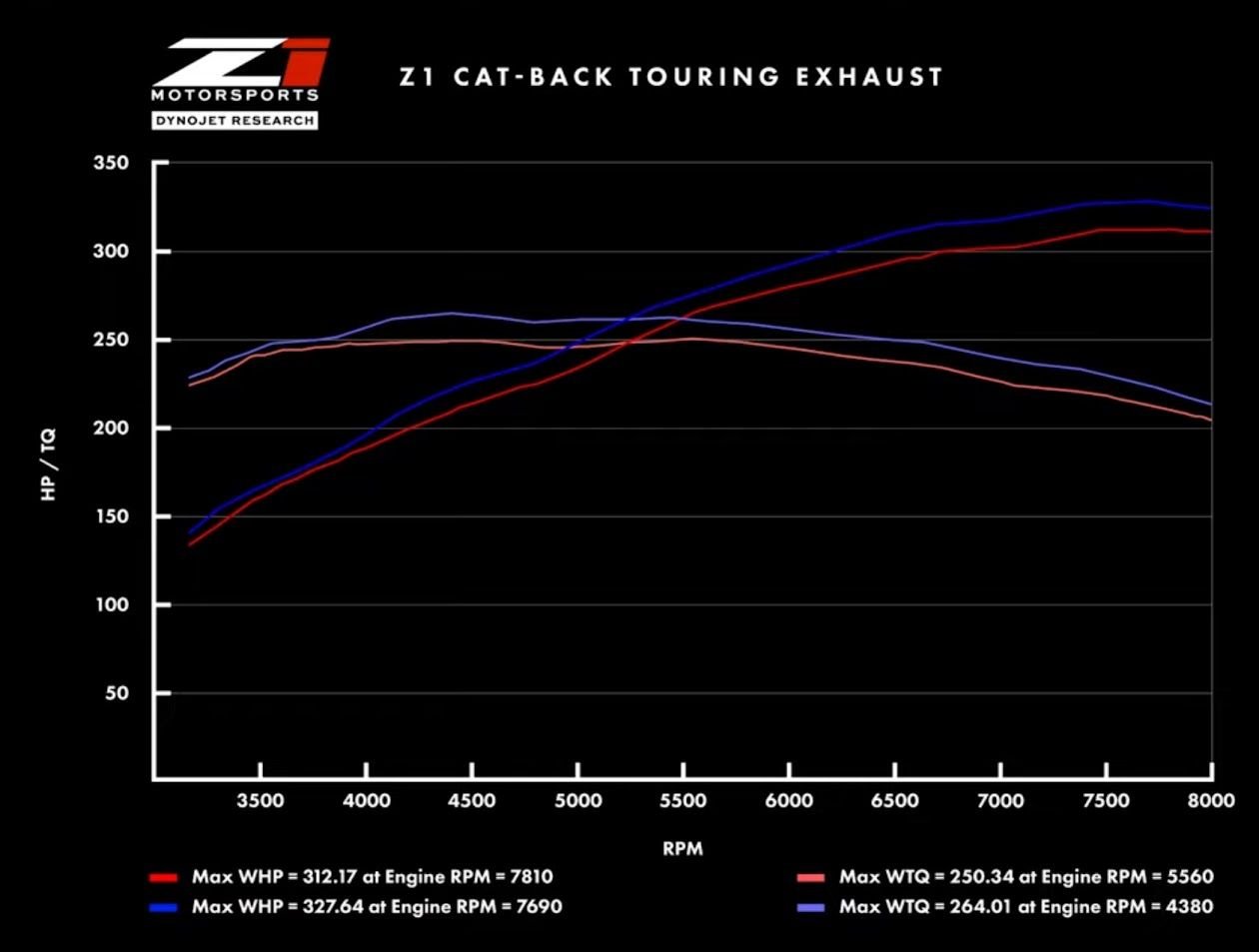

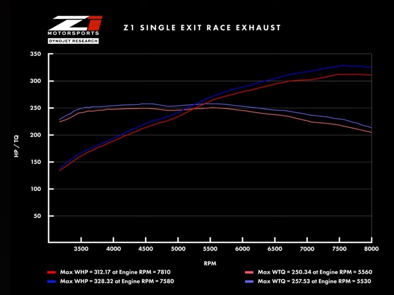

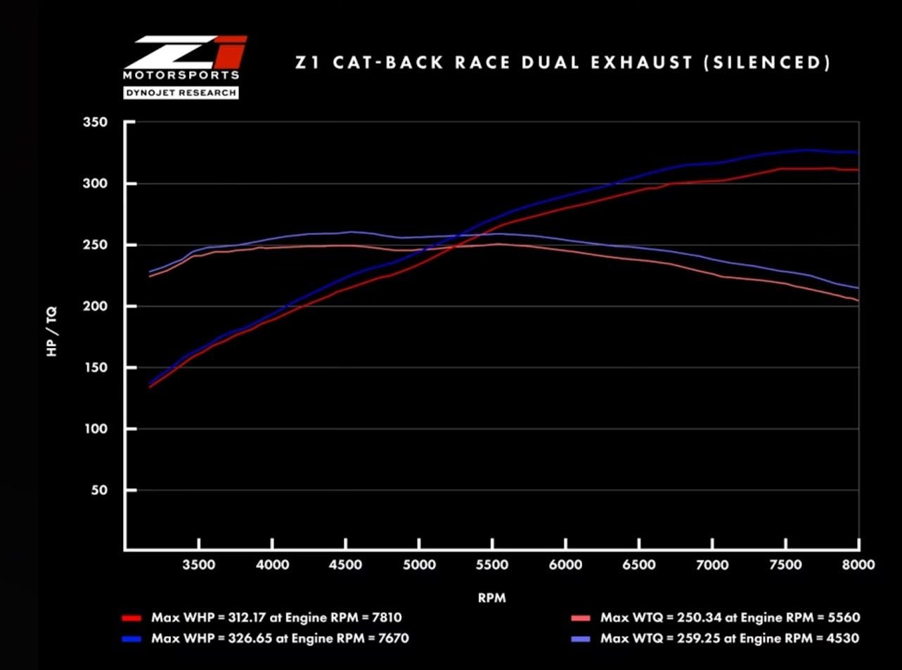

Z1 did an awesome video comparing multiple exhaust with sound clips and dyno. The range of exhaust included single exits and duals of different diameter.
I'm going to post the dyno numbers of each as a comparison
This comparison definitely shows that singles do provide the most gains for out platform.
Dual style diameter don't seem to have much difference in gains between 2.36" to 3.0", but 2.25" might be too small.
Tony at Motordyne did a study that saw 2.5" y-pipe primary diameter provided the best peak power and best average torque. 2.0" y-pipe primary diameter yielded the highest tq but low on hp. 2.25" primaries were better but not as good as 2.5".
https://motordyneengineering.com/sca...pressure-myth/
Baseline was 312.2 whp / 250.3 wtq
Tomei (3" single / paired with tomei y pipe) = 330.3 whp / 262.2 wtq
Z1 Race Single (3" / paired with z1 resonated y pipe) = 328.3 whp / 257.5 wtq
Z1 Race Dual (3" y-back dual early split with silencers / paired with z1 resonated y pipe) = 326.7 whp / 259.3 wtq
Z1 Touring (3" y-back single with late dual split / paired with z1 resonated y pipe) = 327.6 whp / 264.0 wtq

Invidia Gemini (2.36" x pipe dual) = 327.0 whp / 259.8 wtq

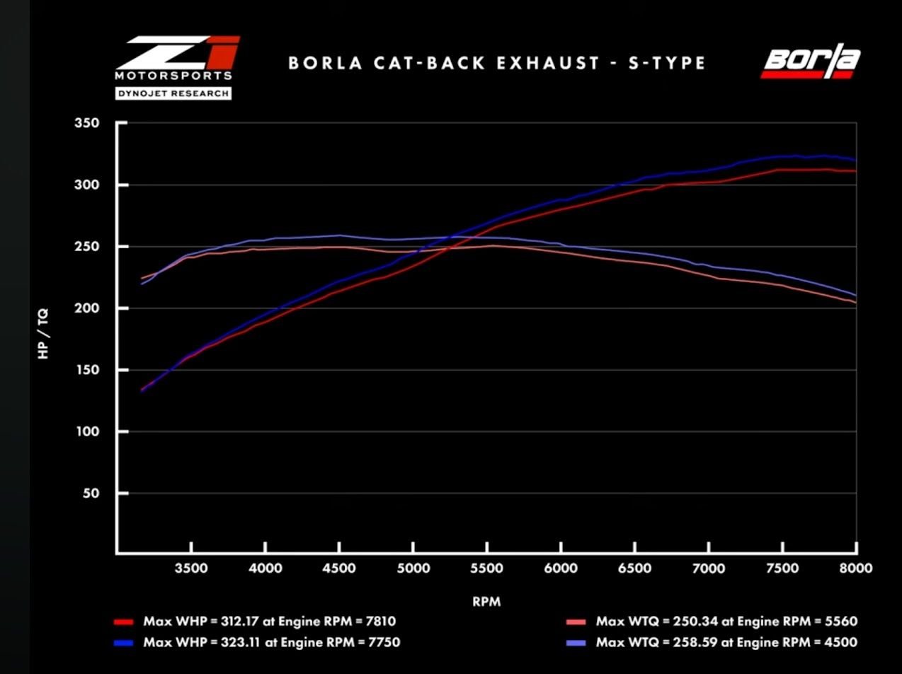

Borla (2.25" h pipe dual) = 323.1 whp / 258.6 wtq

This guy eviscerates the Borla kit. Yikes! The HKS seems really nice, and sounds familiar.
Fun video, but entirely a marketing promo for Z1.

Nice post @projectpanda13
"horsepower is what people buy, torque is what they drive"
With that said, I think there is a typo in the Z1 Touring catback and the 364 wtq should be 264.
264 is still impressive. Amazing how close all of these are to one another.
thanks for catching that.
Yea, for the most part, all exhaust will make roughly about the same. Its best to just focus on achieving the sound an individual wants.
