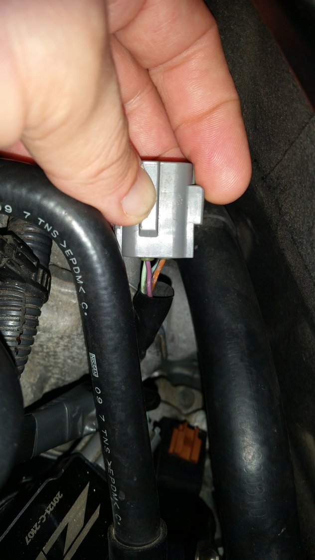

Alright guys, I am about 99% finished with his job but I've hit a snag. I've found one connector that doesn't seem to fit anywhere. It's 4 wire, on the driver's side by the rear spark plug position, and doesn't seem to have much slack or anywhere to plug into. Everything else fits in fine and easily. Any ideas?

Can you see what colors the wires are?

Dark green, light green (or yellow), purple, and orange. Everything else is plugged in (MAF, coil plugs, throttle body, everything behind the upper manifold).

No guarantees, but that looks identical to the connector for the A/F (air fuel) ratio sensor... commonly referred to the front or pre-cat O2 sensor.
Edited to add image from FSM:
Closely verify your wire colors, however, if in doubt report back.
The pigtail from the sensor likely dropped down. Just route it back up and you should be good to go if that is the mystery connector.

Ok, I'll check that out but my wiring looks a bit different.

I'm going to assume that LG = Light Green, V = Violet, W = white, and Y = Yellow

That is correct. Just check your AF sensor... If it's connected, then we know that is not it...

Yep, you nailed it! The sensor dropped so I had to fish it out while scraping my knuckles. All plugged back in now!
