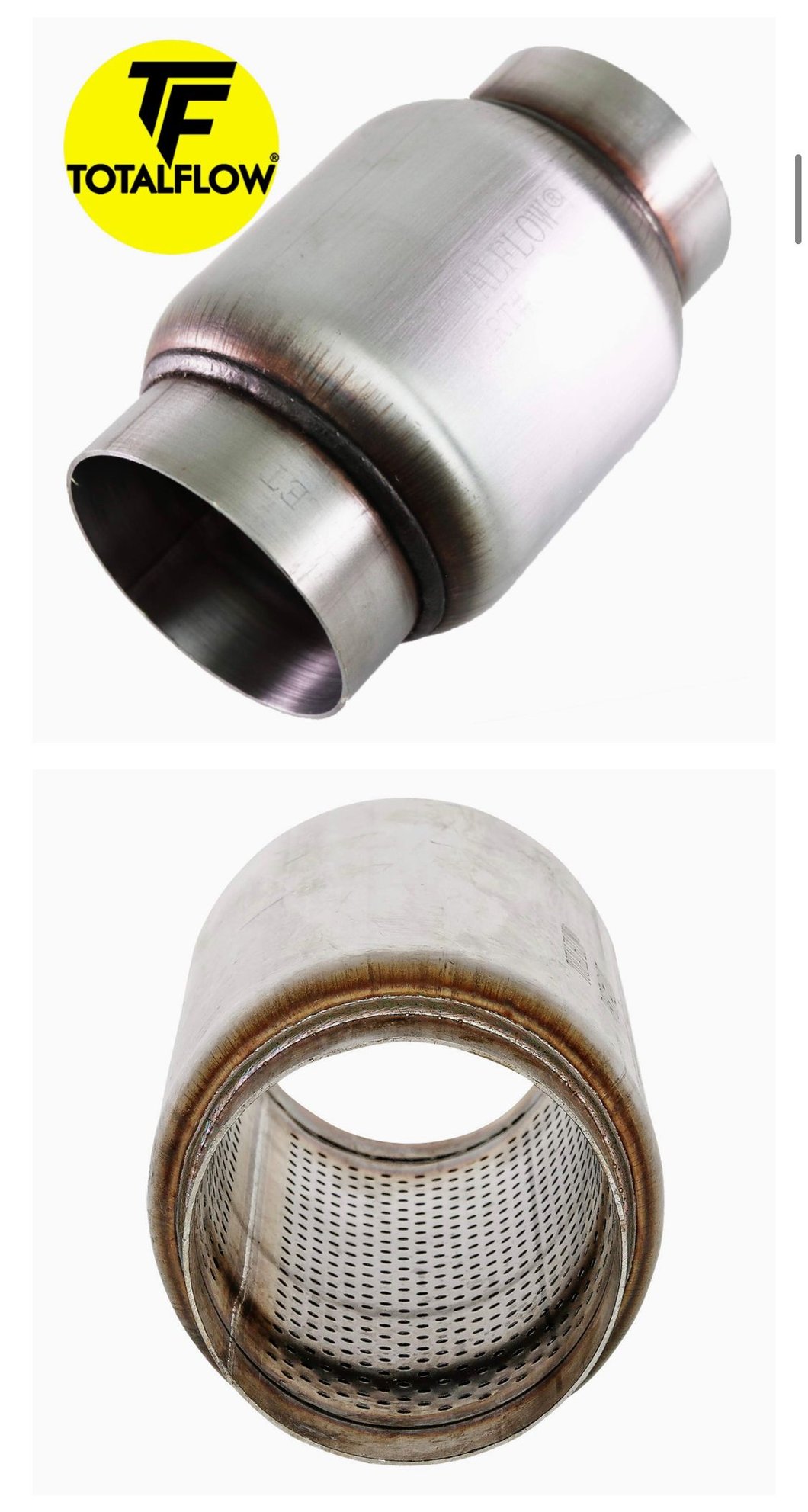

Im going to try and modified the top speed y pipe with a resonator or maybe two mini ones replaces the flex pipe, not sure if that’s a good idea or not? I ordered two 2.5 inch mini 6 inch and 3 inch 6 inch. Few different ideas see if works or not play around with it. If not I’ll just get the Motordyne XYZ-Pipe. I want this to look good. I’m pretty picky when it comes to my cars

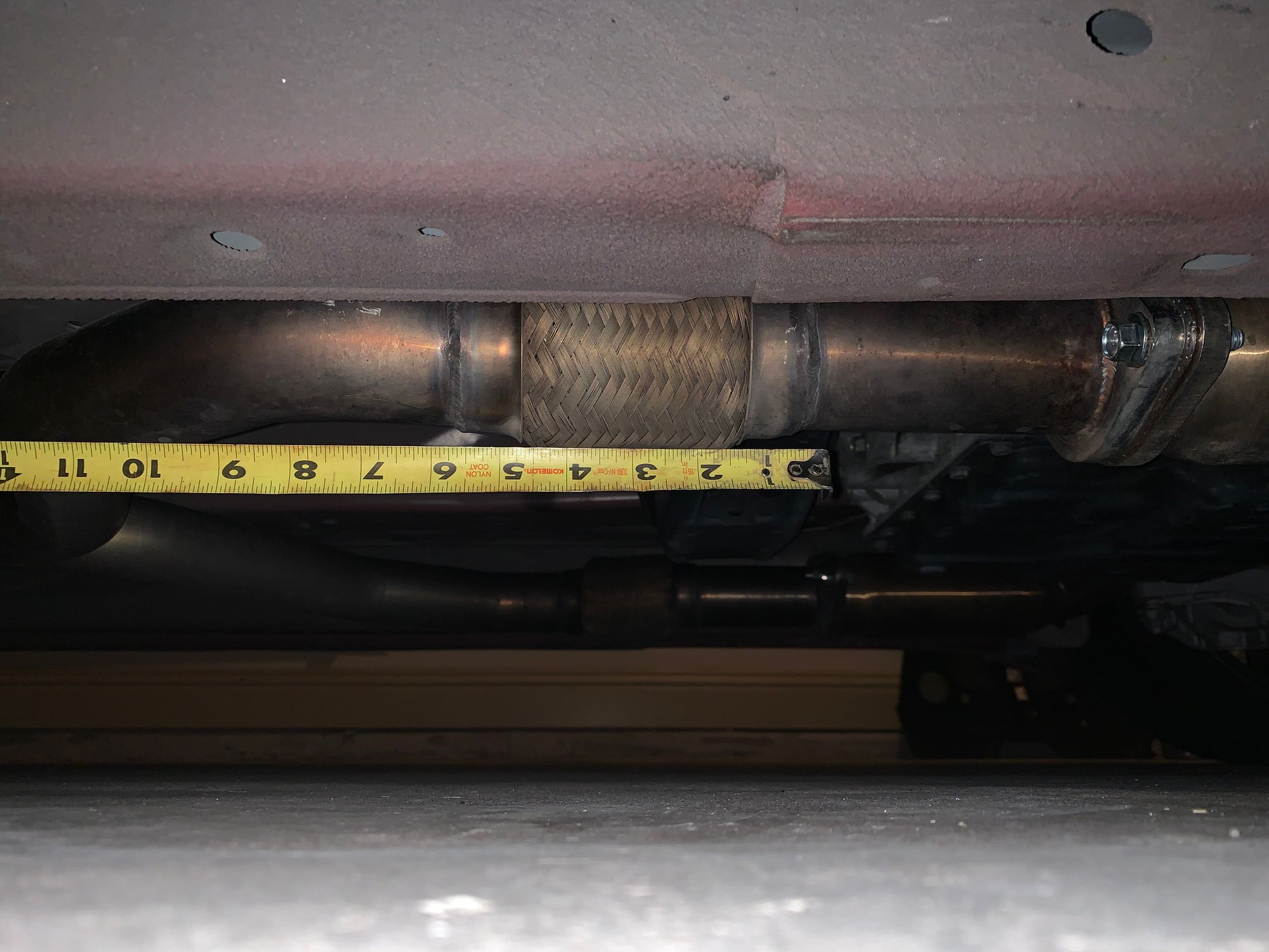

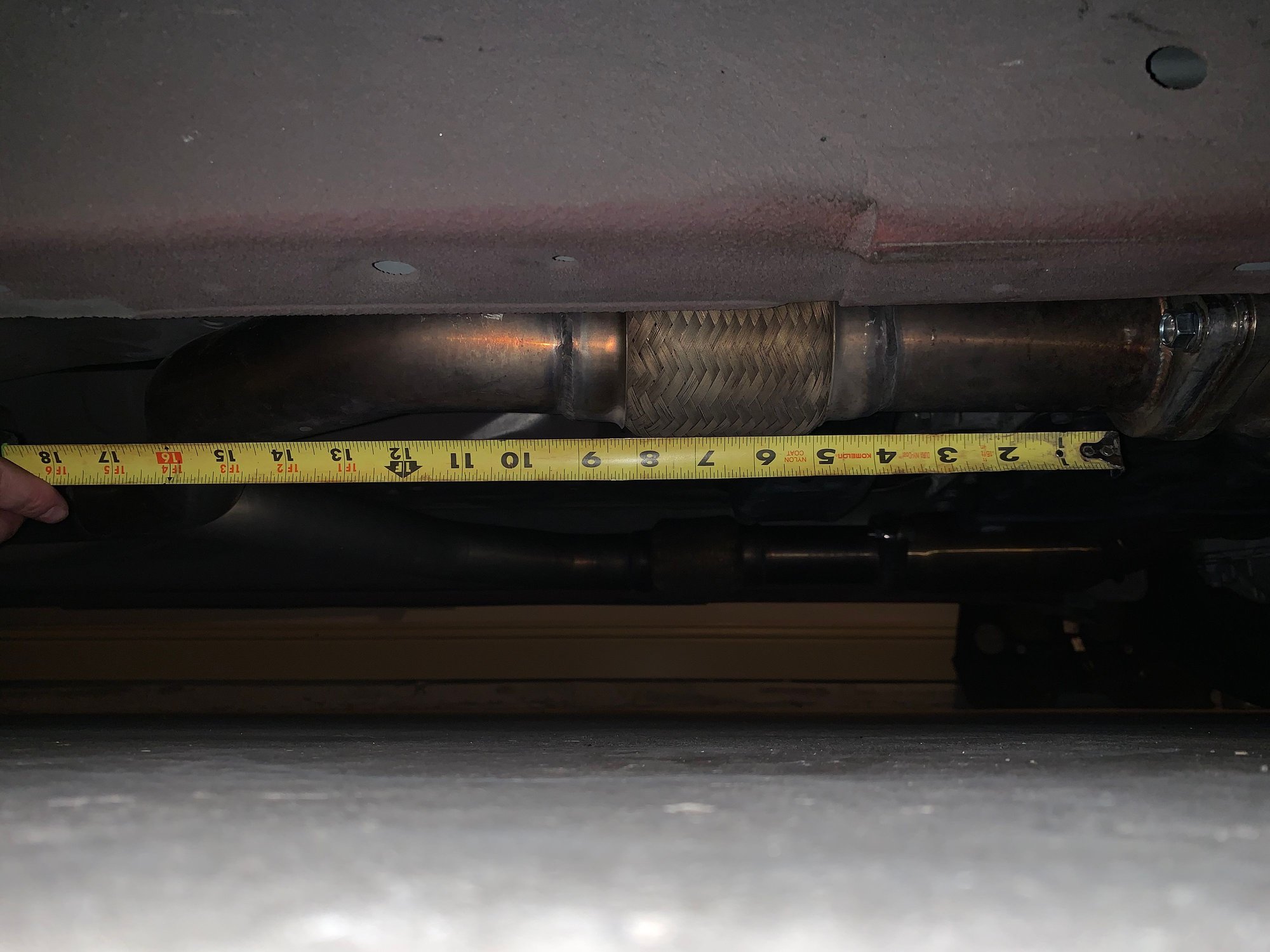

RMB5190, I was super excited for the test pipes till I heard the rasp, it did really open the car up. Anyways time to fix it. I’m cut the flex pipe out and replace them with the 6 inch mini on both sides. Here’s my idea with few pics.let me know if you think this will work,Thanks for the help

I took some more measurements and I think the 6 inch would be perfect fitment but is it enough to stop the rasp,or try and go with 12 inch ? Let me know what you guys think. I’m thinking I will not need a resonator on my new signal exhaust cat back if so that would be 5 resonators

Bigger resonators WILL kill the rasp; so I can't say whether or not the smaller guys would do the job. Here's were I installed mine (Yellow) - 12's required a pie cut (1 on each) right where the bend leading to the flex section is:
Flex section came in handy getting everything to match up for me.

Allright thanks for help. I’ll just go with the mini s since already ordered and shipped. See what happens. I’ll let you know when it’s finished worked or not. I went with those because of the good reviews on them. High quality, kills rasp nice exhaust sound.
