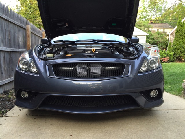

So to make this quick..
1. I installed my Takeda a couple of months ago. No problems whatsoever.
2. Swapped the single filter for a custom dual filter setup last month. No problems.
3. Removed front end ducts to cut out the rad support for better tube fitment.. Problems.
Car started right up, no issues. Drove around the block w/ the bumper off and got about 1/4 mile away and the idle started bouncing up and down and the car started to stutter. Pulled over and it stalled out. Tried to turn it over again with no luck. Then it turned over on the 2nd attempt but idled extremely rough. Third time it started right up and no problems since. Still have the Service Engine Soon light illuminated though.
Codes are:
P1233 - Change fuel line system
P1238 - Electronic throttle control actuator B2 short to ground
My guess is that cutting the duct out allowed for a significant enough increase in air flow that the A/F ratio was incorrect long enough to set the code. I'm just not sure why this didn't happen the first time I installed the intakes or new filters.
Any ideas?

In a nutshell the driver's side throttle body is not happy.
First simple checks:
(1) Check for any worn, loose or disconnected wires around the driver's side throttle body
(2) Make sure battery voltage is more than 11 volts with the car running
The next step is to troubleshoot using section EC of the factory shop manual, page 1022. (link: Infiniti G35 / G37 Factory Service Manuals - NICOclub)
Note to all: You can't trust most scan tool definition of the code. They are not always accurate and it can mislead you. Use the factory shop manual and look the the code to get the ACTUAL definition.
Post how you make out and good luck.

Based on the codes and details above I would clean the TBs, look for possible debris from cutting the shroud.
Reset the ECU, possibly reset the tb idle pos.
Check the connectors.(don't unplug them though)

Will post back with an update later this afternoon. Again, appreciate the help.
Looks like I ingested a little piece of plastic. The throttle body does a self check from wide open to full close after every shut down so it must have broken free after the 2nd attempt to turn over the car. A little cleaning and an ECU reset and I should be good to go. Hopefully that little piece of debris didn't get lodged anywhere :/

Problem solved. Cleaned the ETB and reset the ECU. Drove it for about an hour and didn't have any hiccups or MIL's.
Unfortunately this was completely user error. When I was cutting the rad support out for the intake, I didn't stuff a rag in driver side intake like I did for the passenger side. I did check for debris and swept the driver side out with a rag but something must have shot in there :/
On the flip side, the car runs much better. Without cutting the rad support, I had a terrible intake resonance after about 5k and up until redline. Apparently it was the pinched silicon elbows causing it.
