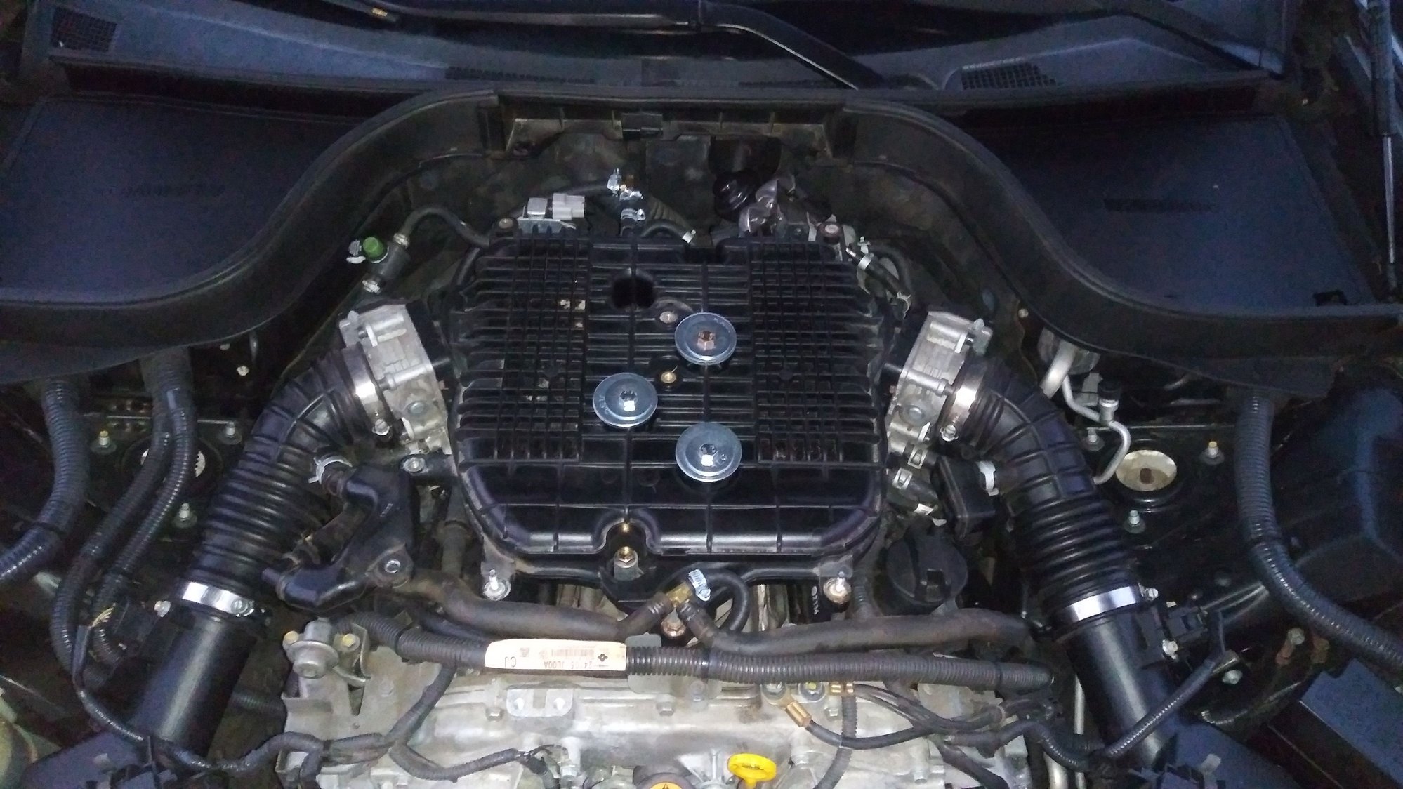

Hey Panda, I personally measured the volume of each manifold with water and the HR is slightly larger.
VQ35 intake has slightly more volume, 6000 ml vs 5700 (VQ37).some of this has to do with the HR manifold not having the map pressure boss.
That's interesting and pretty cool.
I wonder if the HR being overall wider added the additional volume.
Could the additional volume also from the runner lengths vs the chamber?
Thanks for adding more information. Wish I had this to add to my video when I was making it.
Yea that could be, I haven't really looked into all the differences when I did the comparison. But HR is slightly larger (vol wise) and yes smaller runners in the same package will allow for more water vol. Since those runners are taking up less physical space vs VHR though it wouldn't be a whole lot.
37VHR Volume
37VHR Volume
35HR volume
35HR volume
are those caps readily available at the hardware store?
Sorry just saw this, negative I 3d printed it. I just uploaded it here if you can print
https://www.thingiverse.com/thing:7065780
