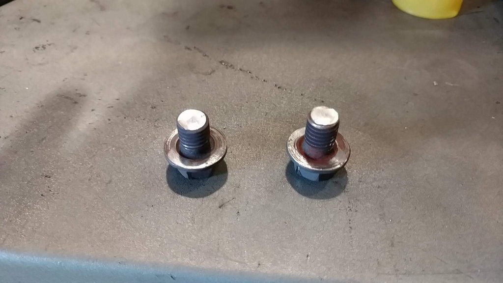

I was able to get the demon bolts off without any penetrating fluid. I couldn't figure out how to get the can of PB down there to spray. 24" breaker bar was enough to snap the bolts in half.
Made the demon bolts my be-atch :)-h9wrb5jh.jpg
For the four lower bolts, I soaked in PB for 20 minutes or so. This was much easier because I had the car on a lift. Same breaker bar broke them free without any issues.
If I were to do it again on another G/Z I'd use a syringe, that ATF/Acetone Mix works the best but hard to isolate it to just the bolts when using a spray bottle.
