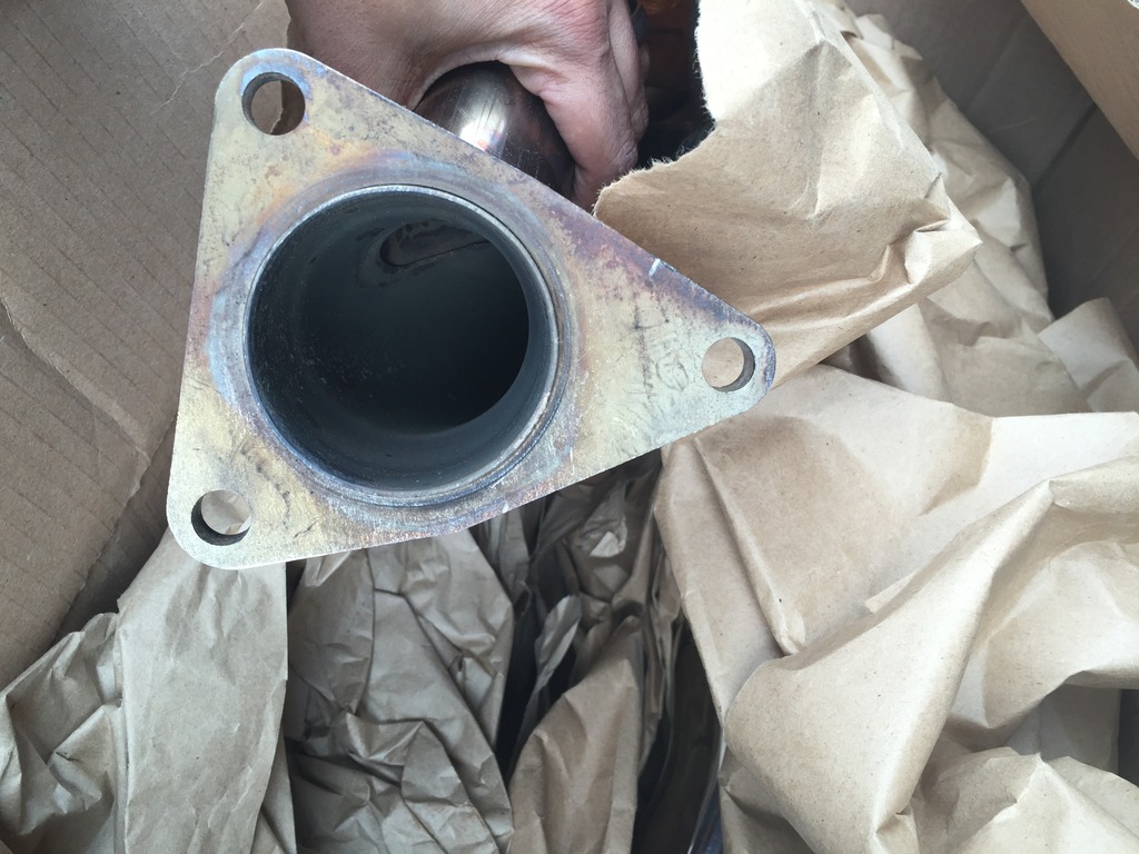

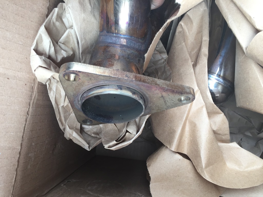

got a set of art pipes but i have a gasket question. here's the header end

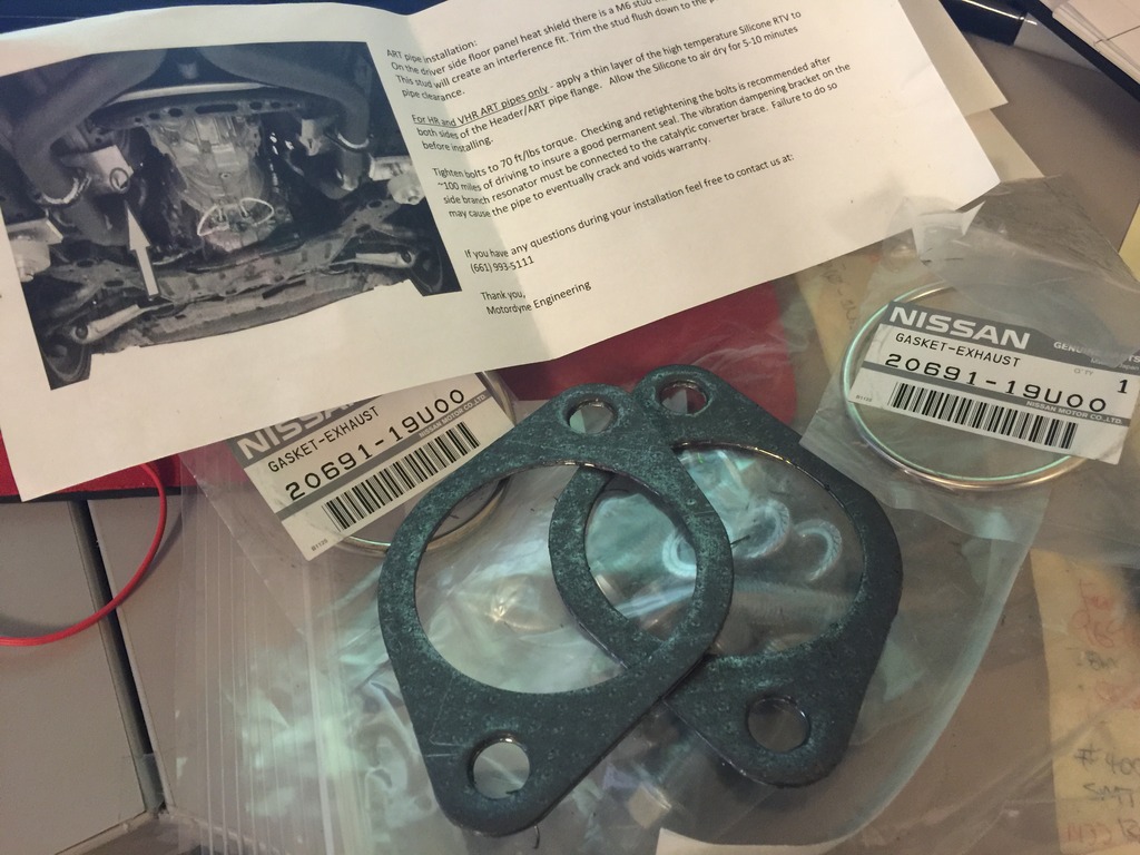

it didnt come with hardware so i got the hardware kit online for $40
now here's where my over researching gets me in trouble.. the documentation on the hardware kit stated to use RTV but from this source ( link )
Originally Posted by Motordyne
Yes, they now come with a stock metal crush-gasket ring seal.
No more RTV.
which is what i got in the kit.
but from here ( link ) it appears in one of the pics that the installer is using the crush ring seal together with a Z1 gasket.
I'm not opposed to using the gasket, i just want to know whats the proper way to install the pipes.. will the combination of Z1 and crush ring interfere with each other?

I used a crush ring with my stillen HFCs. No exhaust leaks from the header to the cats. (Cats to mid pipe was a different story lol)
I'd say you're safe with the crush ring. The part that extends past the flange on the cats goes inside of the header pipe, it's a snug fit.

Wish I had the lip on the pipes. Looks like mine are V2's so they dont have that and even with the Z1 gasket I don't think I have a fully leak-free seal.

well that sucks, have you tried RTV with it?

Had mine installed yesterday. Reused my z1 gaskets as well as some rtv. This reminds me I need to get some oem gaskets for the y pipe.

Did yours have the lip?
Old Feb 18, 2016 | 09:59 AM
Baby Jumpman's Avatar
Baby Jumpman
iTrader: (18)
Joined: Jun 2014
Posts: 510
Likes: 66
From: Long Island
Yes it did.

didnt use the crush ring?
Old Feb 18, 2016 | 12:17 PM
Baby Jumpman
iTrader: (18)
Joined: Jun 2014
Posts: 510
Likes: 66
From: Long Island
No. I bought them used so no hardware, just reused what I had.

get some of these and see if it helps
Amazon.com: Genuine Nissan 20691-19U00 Exhaust Gasket: Automotive Amazon.com: Genuine Nissan 20691-19U00 Exhaust Gasket: Automotive

I initially used RTV to seal, I don't know if I did it wrong or what but it completely failed. I am now using the Z1 gaskets only and still have rasp. Right when I put the Z1 gaskets on the rasp actually went dramatically down, but it has returned so I suspect the leak started again. Maybe next time I should use RTV on the gaskets as well.

did yours have the extra lip as pictured?
Old Mar 7, 2016 | 06:27 AM
takeapieandrun's Avatar
takeapieandrun
Joined: Jun 2015
Posts: 515
Likes: 58
From: Bay Area (925)
No, and I suspect thats a big culprit.
