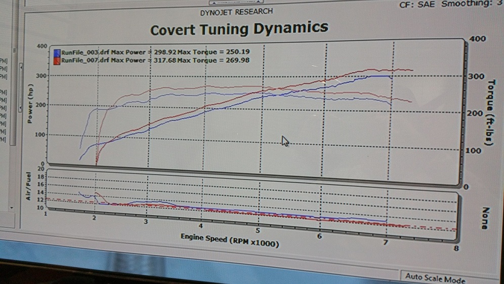

I wanted to make a new thread to inform everyone about a buddy of mine porting OEM Throttle Bodies for the G37 and 370Z platforms. This is all in one day, Dyno sheet is from 10/30/2014
Details: Full CNC port to 63mm, new bigger CNC butterfly plate from brass stock, the shaft is thinned down by a CNC with new flat head screws installed and torqued to spec, all disassembled and reassembled for $280 for locals and $295 for non-local.
Note: I do not drive my car in the winter so when we installed these we bypassed the coolant lines from the TB's.
(BLUE on Dyno sheet) The Throttle Bodies were the last mod that I have done. Prior to the new throttle bodies my numbers:
304.87 HP
256.86 TQ
STD
Mods: Motordyne Art Pipes, Motordyne E370 Shockwave Cat-Back Exhaust, Motordyne Intake Manifold, Stillen Gen3 Intakes, Uprev Tune.
(RED on Dyno sheet) Numbers after the new TB's and retune:
317.92 HP
269.98 TQ
SAE
Mods: Motordyne Art Pipes, Motordyne E370 Shockwave Cat-Back Exhaust, Motordyne Intake Manifold, Stillen Gen3 Intakes, Uprev Tune, 63mm ported TB's.
Dyno: Dynojet
Dyno video:
Dyno graph: AT BOTTOM
I HIGHLY recommend!
**Notes: Do not be alarmed after you install the TB's and you start throwing codes! You will need to do the throttle positioning reset and a ECU reset. I would dyno pretty soon after these are installed to ensure your A/F is on point. Great new mod with documented power increase!
Let me know of any questions! Happy modding!

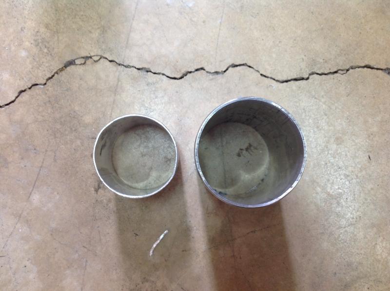

Max. Anymore and the tb will be to big for the mani hole, you'll have a horrible step the air hits instead of a smooth transition. Also, the mani can only go to 63mm or you port into the silicone gasket ring section. You port into that and you lose the seal. Also, no point in going bigger if you can't get the air in. Stillen gen 3 are 2.35" ID, same as the OEM TB size. No point in doing such a large TB unless you plan to run a 3" CAI pipe. I personally made a 2.75" OD CAI setup to match my TB's, ported upper and ported lower mani all port matched of course
My CAI pipe vs the same size as stillen.
