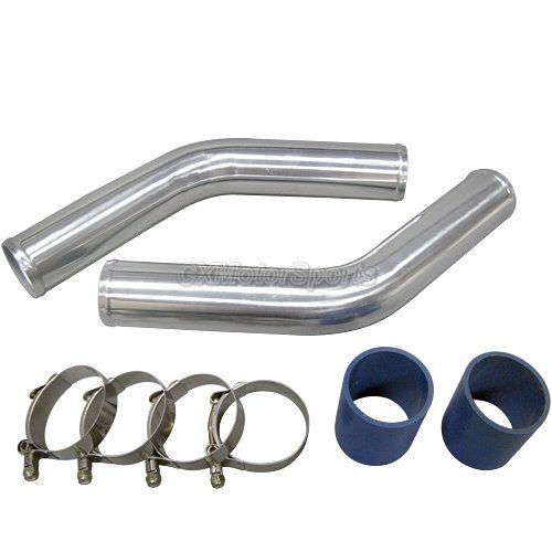

Ok so been thinking a bit on what I was going to do. Finally bought some piping and air ducts, The ducts are either going behind the grill or I'm going to cut the front lower grills and mount these behind them in between my LED fogs, From the side on my air box where I cut them out( Side in the wheel well area) What you guys think? Lower Grills( I have a NON sport 09 Sedan) or behind the front grill AKA Still and Takeda? An benefit feed the box from two different spots? I know I may need more piping depending where I go but its a start.

I think the best approach would be placing the duct as low as possible and making the piping as vertical as possible, (straight up to the side of your box). Im in the same boat now designing (<$150) the cold portion of my cold air intake build.... and to think Im only doing this to prevent spending $300+ for a CAI.

Yea me too, all tho I'm into it so far of 96$- an the side you mean the side I cut in the wheel well area ?

Cool project. I would go behind the upper grill like other CAI since you probably don't want to be vacuuming water from puddles.
Do you plan on getting post MAF silicone tubing as well? Would love to see a dyno when you're done
