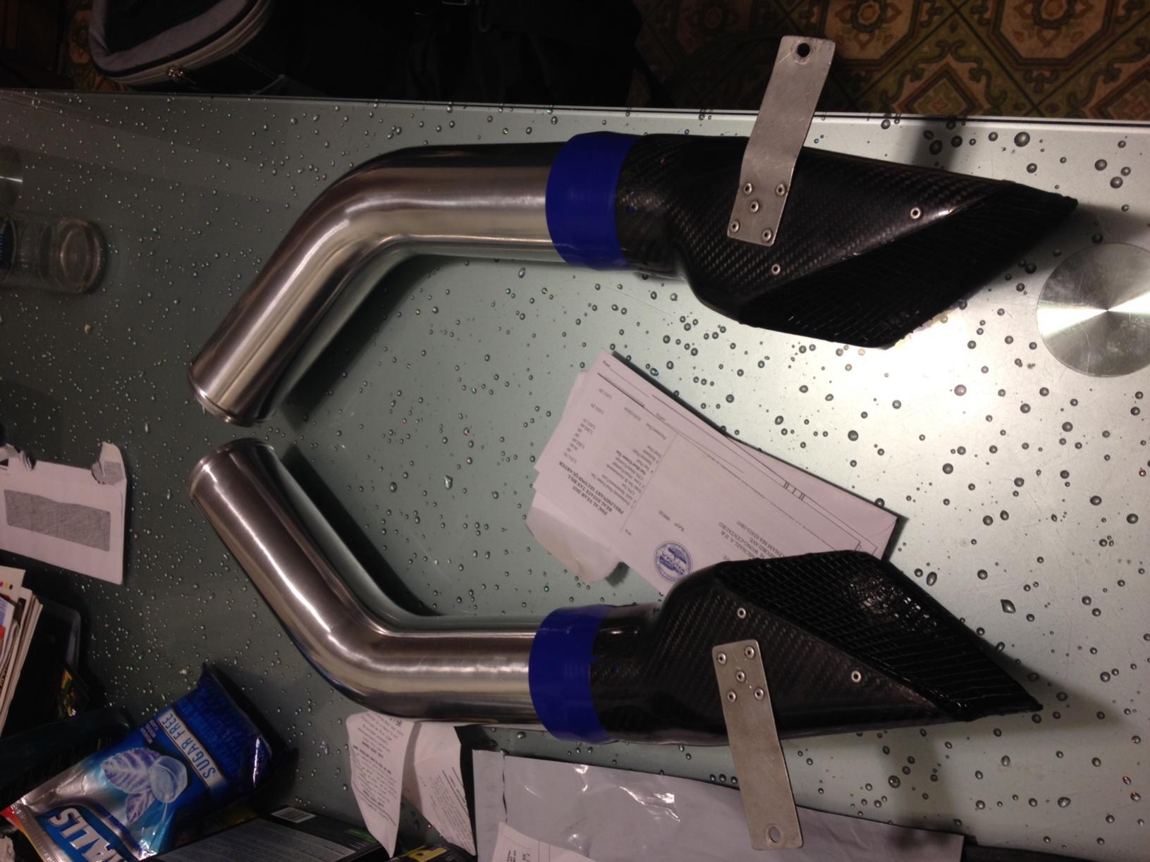

I didn't get anything at Lowes or HD they had CRAP LOL,
I bought the CF Saleen brake ducts on Ebay. I also have a set of spare brake ducts off a E90 BMW.
The intake pipes( Didn't use them yet- I can sell them to you?) CXR racing-Ebay
And the silicone elbows and air ducts( Spectre) from Amazon
I can sell you the intake pipes and the E90 brake ducts if you want. You'd only have to get the silicon pipes
