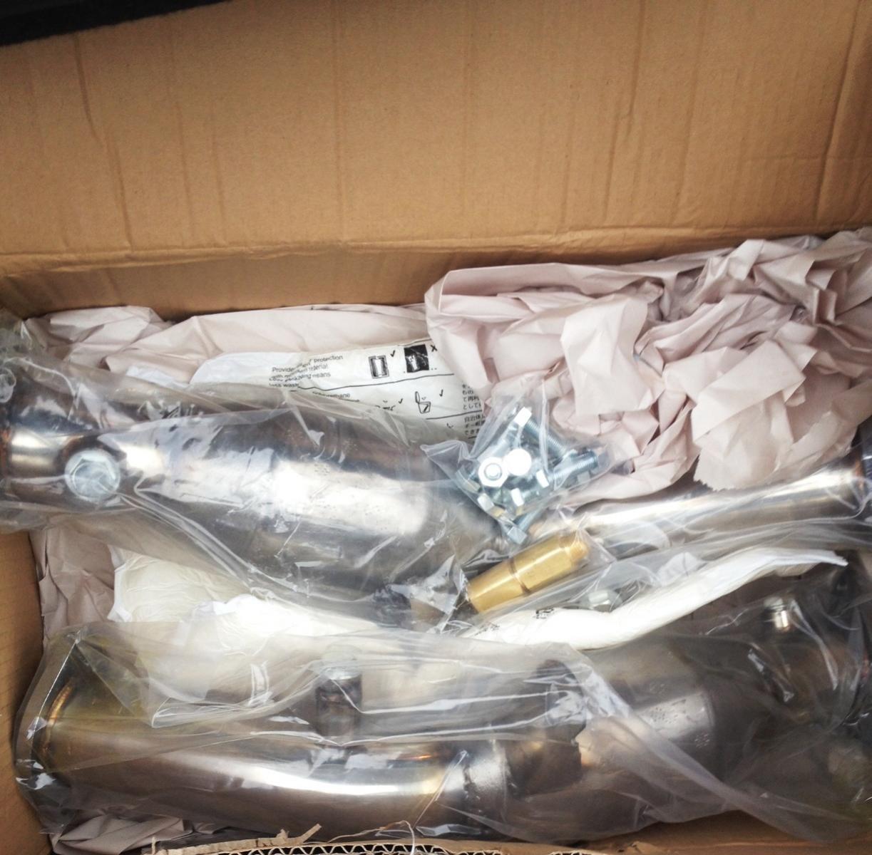

Not true there is difference in cel count and were the bung for the 02 sensor is placed. Some people the cell count is important and the O2 sesor bung. For me both are nothing stupid loud( Z1 are 300 Cell) and the O2 extender so NO CEL light. I have to pass emissions in MA so to tune the CEL out is not an option for me. An Noise it noise

That is true that there's different cell count, but these are just different core fillers from Vibrant. Cat cores are never made by the companies you buy HFC from. The 02 censor bung is in the same exact spot and of the same exact size on all of the HFCs I've seen although I don't calim to have seen all of them.

The O2 sensors are not really moved just moved back from the exhaust stream. If you look at mine and the use the bottom one you can see the sensor will be moved back from the stream,
An would the cost would be pretty close to what these cost anyways. :/
