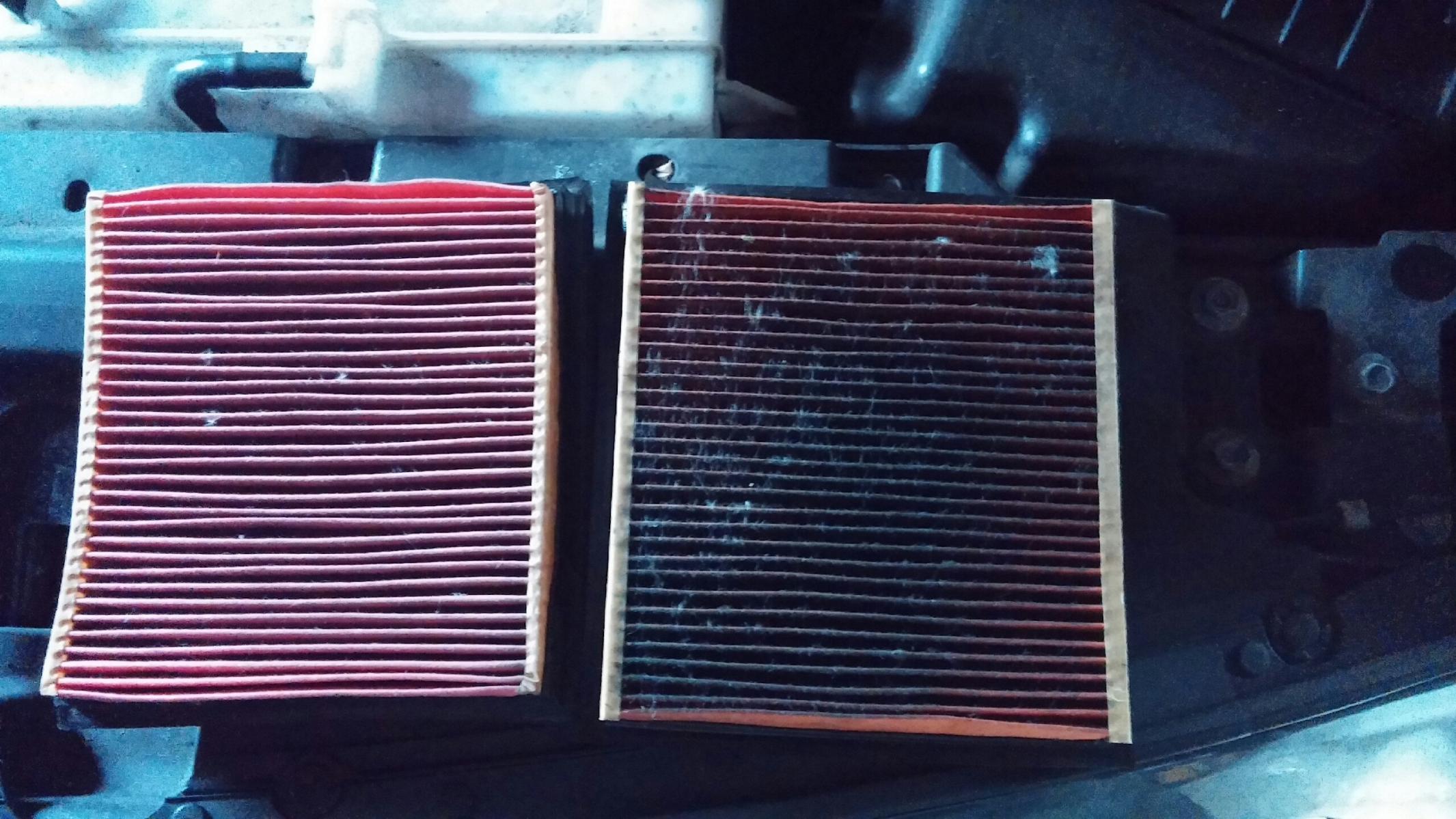

1 air filter much dirtier then the other
Noticed the driver side air filter is black and much dirtier then the passenger side air filter. It doesnt look like normal crud, more like a black, burnt look. I will try to attach file. is this normal? possible the driver side gets more dirt, oil crap then the other? Indication of some type of leak? Can a shock or something like that leaking cause that. I have heard a low hum from the driver side since i got the car last year. Dealer replaced both wheel bearings in front and i still hear the hum. Both dealers (one i bought it from and infiniti dealer here) say its tire noise, but i hear it from the new Mich. pilot a3 sports also. Any opinions, thanks!1 air filter much dirtier then the other-filters.jpg

Did you change them of the dealer? looks like the drivers one was not changed. I have seen one dirty than the other ( passenger was), but not that dramatic?
I would have to agree.
I change mine every 10k miles
They are not exactly the same but not nearly as dirty as your one filter.
If yours were changed at the dealer the person doing it may have gotten distracted and missed changing one of them.

This is the 1st time I changed them. I got the car from a Nissan dealer and they were Nissan filters so I think they changed them when they got it. Gonna look at them again and see if I can tell what the black is. All else seems normal, the tire noise is still there but no worse then the 1st day a year ago. No visible oil or dirt outside the cover. I will let y'all know. Thanks for the response!

My guess would be that who ever changed the air filter thought there was only one.

I looked at them to show wifey and noticed the dirty one was a Nissan and the other a cheap aftermarket from China so yeah someone only changed one.. I am not the bonehead lol! Thanks guys!
