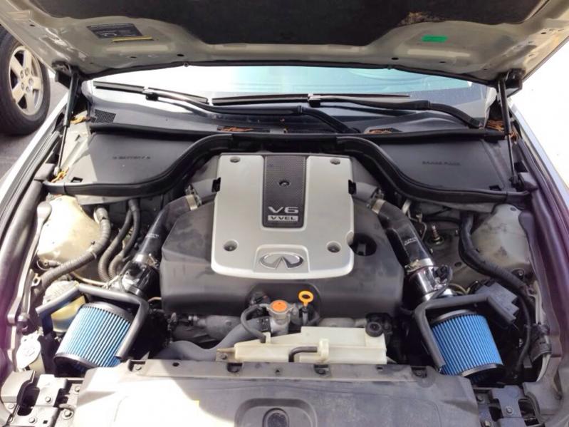

Yea my friend was telling me that he uses a short ram intake that only has very short metal piping combined with stock silicone hps tubes that replace the stock rubber tubing, and they are also straight tube design. In addition it also has a decent heat shield. Here is a shot He thinks they improve but I'm still asking.
These are the injen Sri intakes combined with hps tubes. They are similar in design to the r2c it seems.
