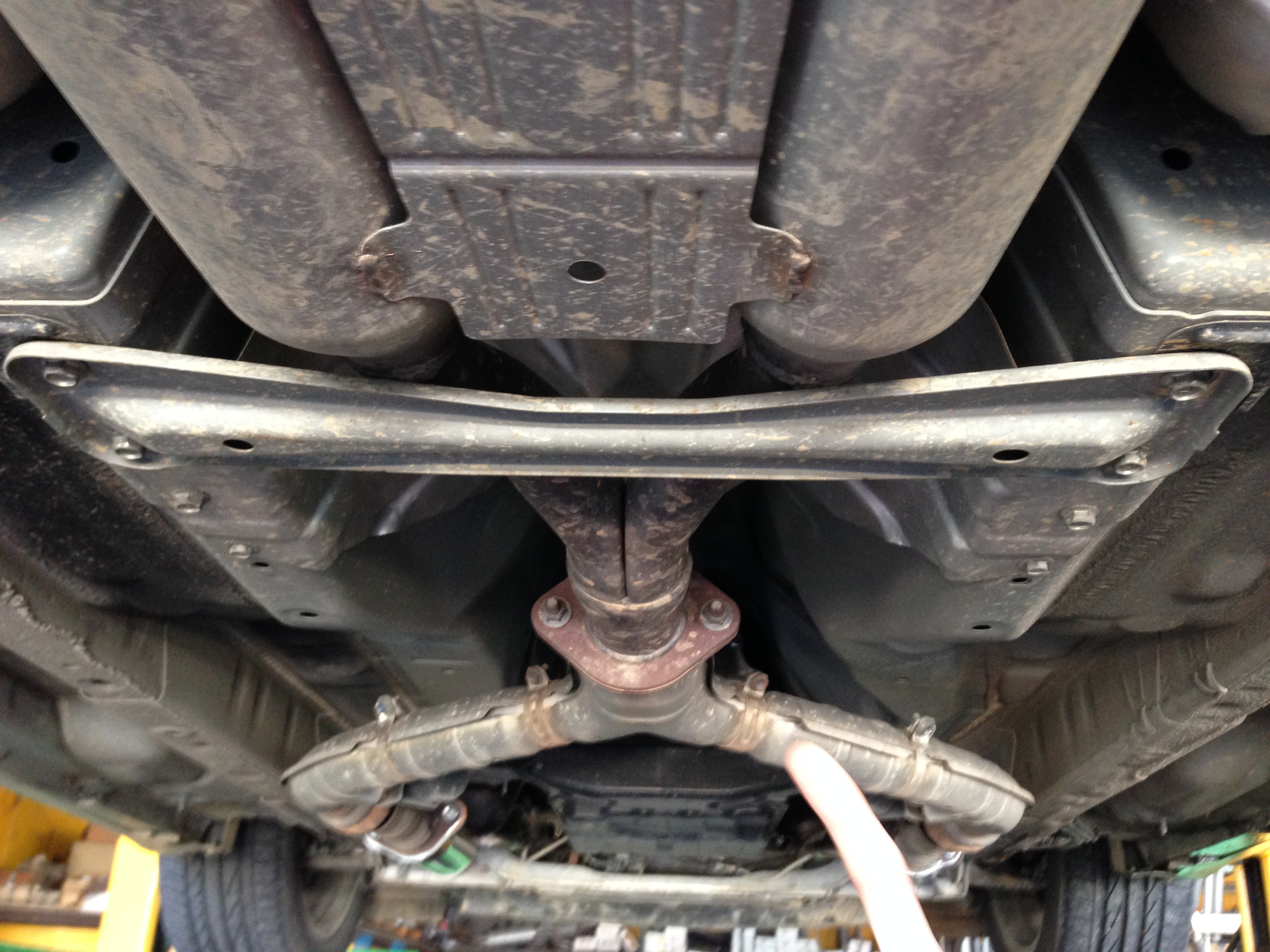

did you eliminate this metal part in front and rear of car? I think there are two of these and it caused rattle when I installed some RHFCs since it was too tight.

I actually did not. Are we able to remove those? I mean would it cause to do anything to the car?

But am i able to remove that bar without anything happening to my car? and did you remove yours as well?
Yes nothing will happen. I removed mine since it was causing rattle and vibration.
Old Feb 16, 2014 | 10:29 AM
Likes: 4,951
Might be better to keep them on but possibly put a couple washers in there to give it a bit more clearance if it was a clearance issue. These unibody frames seem to require quite a bit of cross bracing to keep everything solid.

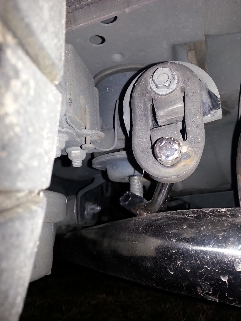

Yeah. I actually looked under the car today its not that. But next to the hanger there is a bolt that is hanging down. And its really close to one of the pipes. I think its vibrating off of that... I will post a picture later. Only way for me to take a picture of that is lifting my car..

Im actually having this same problem. From the back of the car, not the hanger closest to the tips but the one closer to the tire the hanger is hitting a bolt. both sides of the car. Still trying to decide what to do. Ive temporarily put a piece of rubber hose in there. let me know what you do. Anyone else has this problem?

Just like this on both sides.
