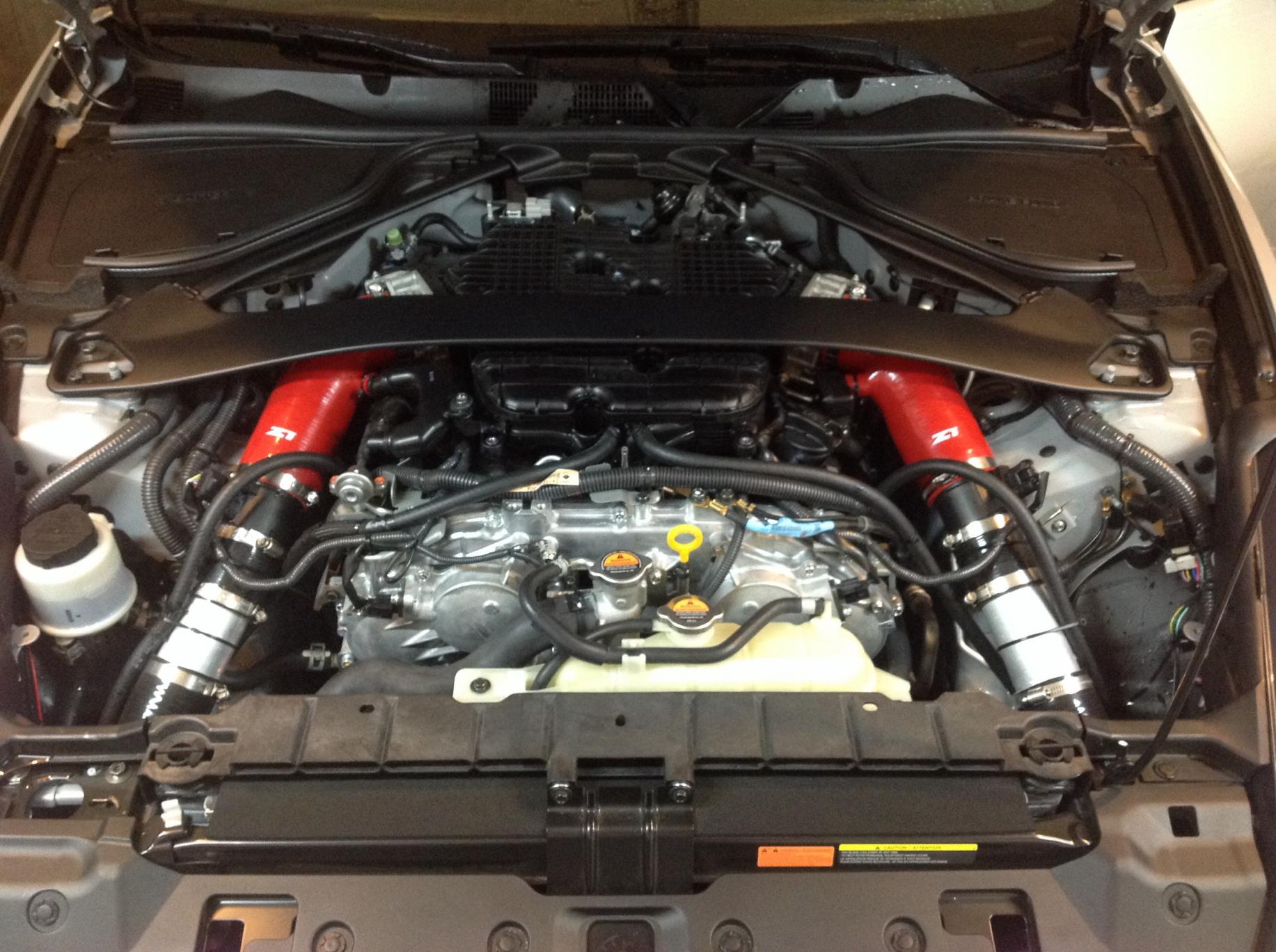

You can always make your own gen 3
Z1 post tubes
OEM MAF housing cut off of the OEM air box
2.5-2.5" straight coupling
2.5" piping, about 8"
2.5-2.5" 45 degree coupling
More 2.5" piping, about 7"
2.5-2.5" 90 degree coupling
More 2.5" piping, about 4"
2.5-3" reducer coupling
3" piping, about 3"
K&N filter same as stillin
About $200 or so spent. Silicone is better than all aluminium for coolness and where a coupling is, it's slightly bigger inside to run more air. Doubt it does anything power wise but I like it.
Z1 post tubes
3" piping, about 3"
Looks good! With the silicone, you don't get the heat soak from the aluminum pipes. Probably runs more consistent in traffic, Gen 3 suck in traffic.
