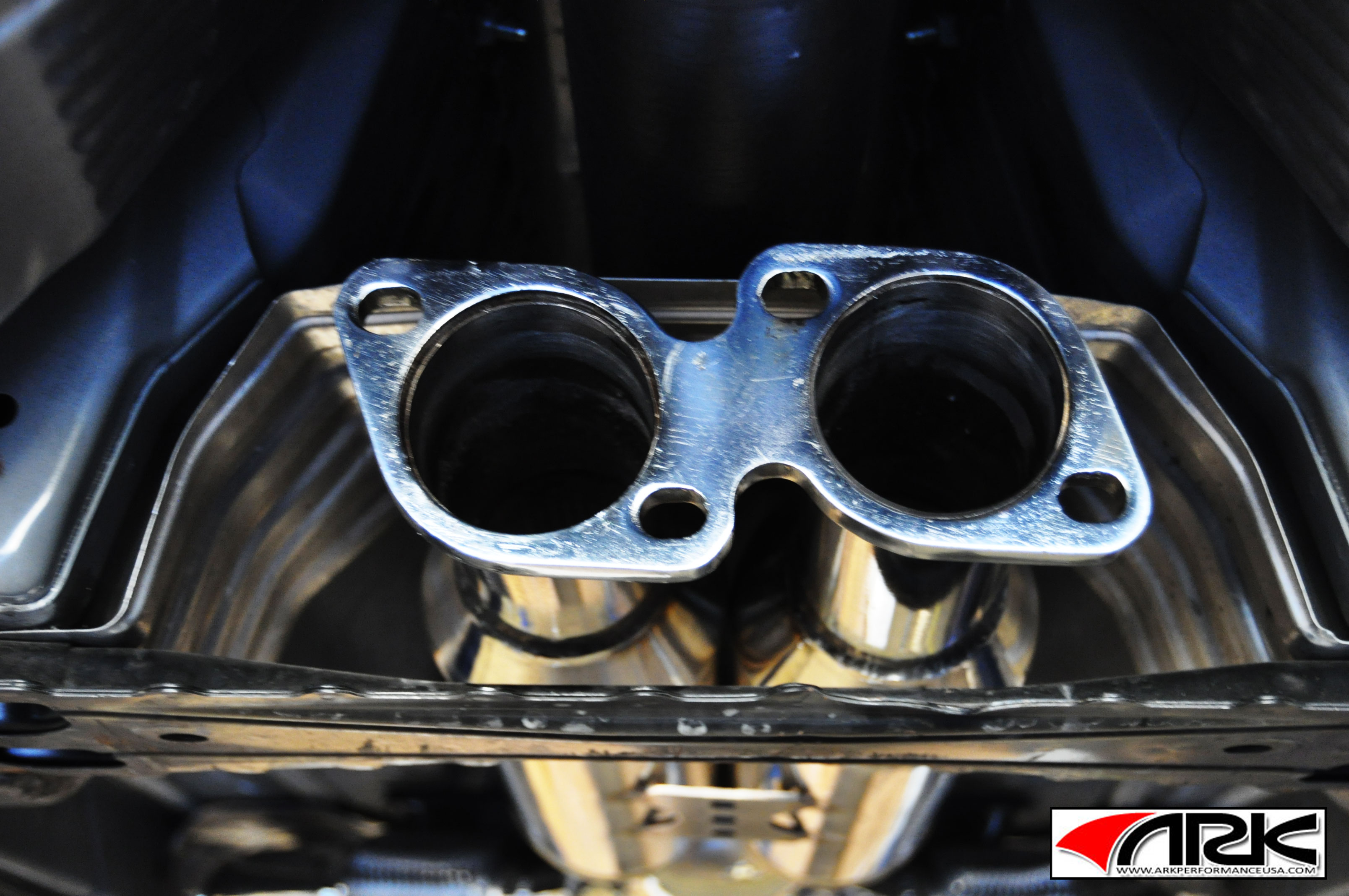

hi guys. sorry i haven't updated recently, been busy with family for Thanksgiving, but I am currently getting the issue resolved with Alex from Ark. I took some pictures and sent them to Ark. So far from what I have investigated, there IS a leak due to two respective phalanges not meeting up flushly.
My friend and I saw that the welding was done unevenly such that the bottom portion of one of the phalange sticks out, making it slanted and impossible for the top half to meet while crushing the bottom. I have done all that i can with the gaskets and positioning the exhaust in different ways.

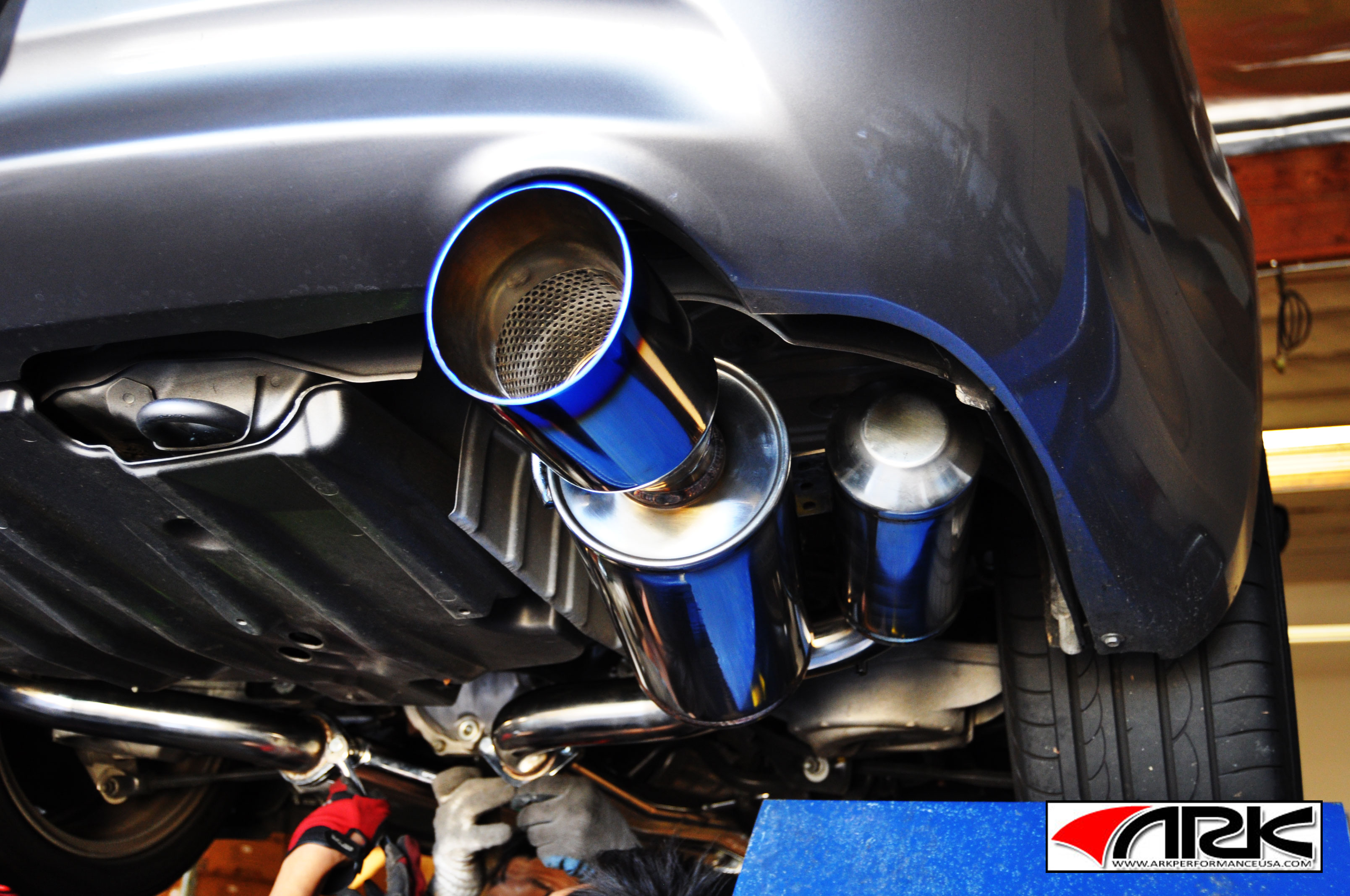

11/29/2010 : SEDAN INSTALLED PERFECTLY : TOTAL TIME WITH LIFT. 23 MINUTES

So is the Black bar in the picture the bar we should remove to get rid of the rattling? Because i Just installed the ark exhaust on my 2011 sedan and i'm getting rattling around 2000 rpm and at idle...

Originally Posted by supra2k
Did u have to remove that black bar or do anything?
YES, Pls remove cross bar and replace oem bolts to hold heat shield. And than problem will be gone.
