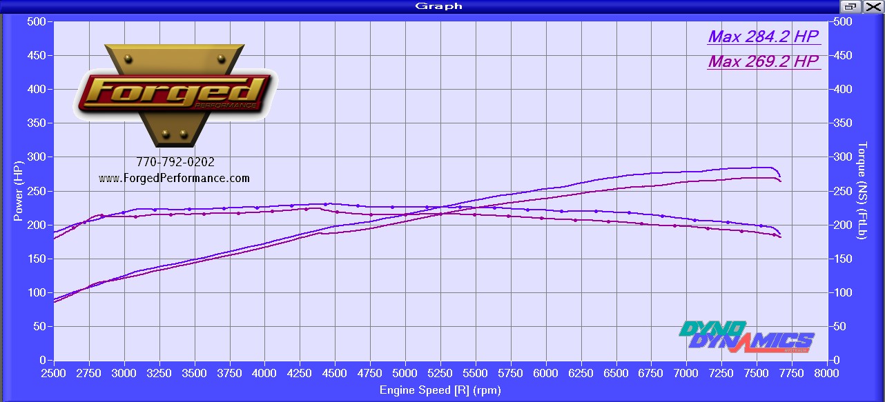

well here you go people, my dyno runs before and after with cobb accessport stage 2 reflash. My car has at time of these dyno runs 14,500 miles on it. Mods are stillen gen 2 intake, headers,hfc, dual exhaust. The wheels and tires are stock, suspension is stock. Testing was done at Forged Performance on a Dyno Dynamics Dyno which usually shows 10% lower reading than a Dynojet dyno. The car posted 241whp stock, 252.6whp with stillen gen 2 CAI and dual exhaust, 269.2whp with addition of headers and HFC. After cobb accessport stage 2 reflash 284.2whp. I plan on data logging the car and having Forged Performance and cobb custom tune car when the software becomes available. Here is last dyno sheet. Enjoy

view attachment and enjoy. Mileage dropped about 4 MPG after reflash

This is a combined dyno sheet from the last time the car was tested with just addition of headers and hfc on 3-30-08, 269.2whp. And with cobb stage 2 reflash on 12-17-08 284.2whp. The car posted 274.6whp on 12-17-08 before reflash and 284.2whp after reflash. There is a 5whp difference between the two testing sessions (3-30-08 and 12-17-08) I think this is due to weather conditions and ecu compensation. Anyway I hope this helps somebody. I think the accessport is cool and very useful and I am looking forward to custom tuning the car for the most NA power possible.
