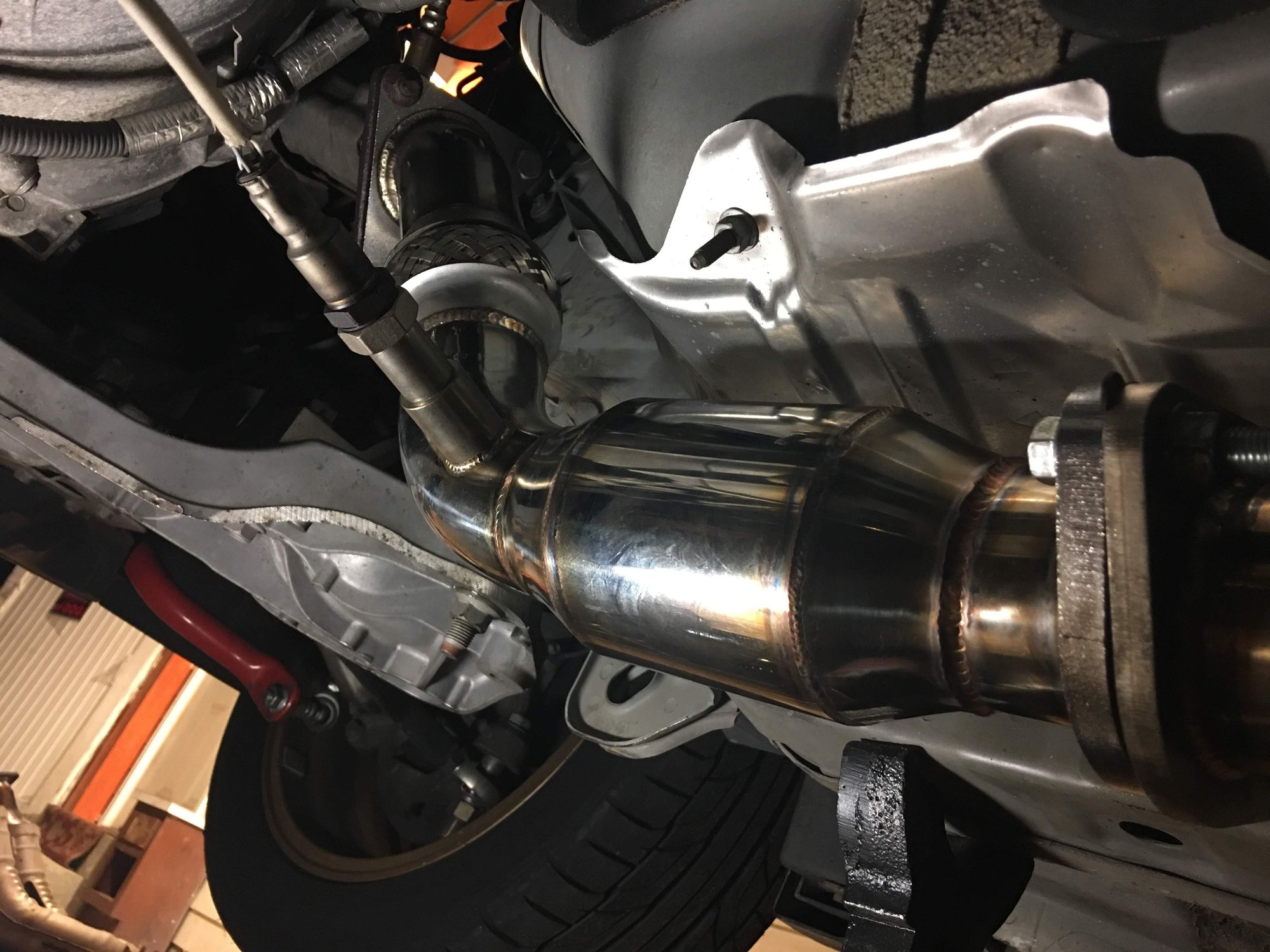

Great, your CEL is off after reset? I JUST ordered these units BC straight is not an option for me. ALL HFC are back ordered. Also looks like you have some nice lower ctrl arms and sways.
after installing the pictures test pipe, I never got a CEL so I didn’t have to reset anything. I drive with those for about a year. Swapped to z1 test pipes for a bit, didn’t get a CEL. Then shortly after that, I swapped to Motordyne Art pipes and also never got CELs.
if you do, despite using the defoulers, you could try stuffing some steel wool right before the sensor. I’ve never tried that and only read it as other have. Some defoulers also have a small pocket to specifically put steel wool in there.

These are the 90° fittings with spacers drilled to accommodate two new NTK O2 sensors. No more CEL after 9 months of living with it blaring on the dash and rich condition after about 250 miles and 8-10 starts! Still rich though at 12.2ish/no cats. Need a tune.
