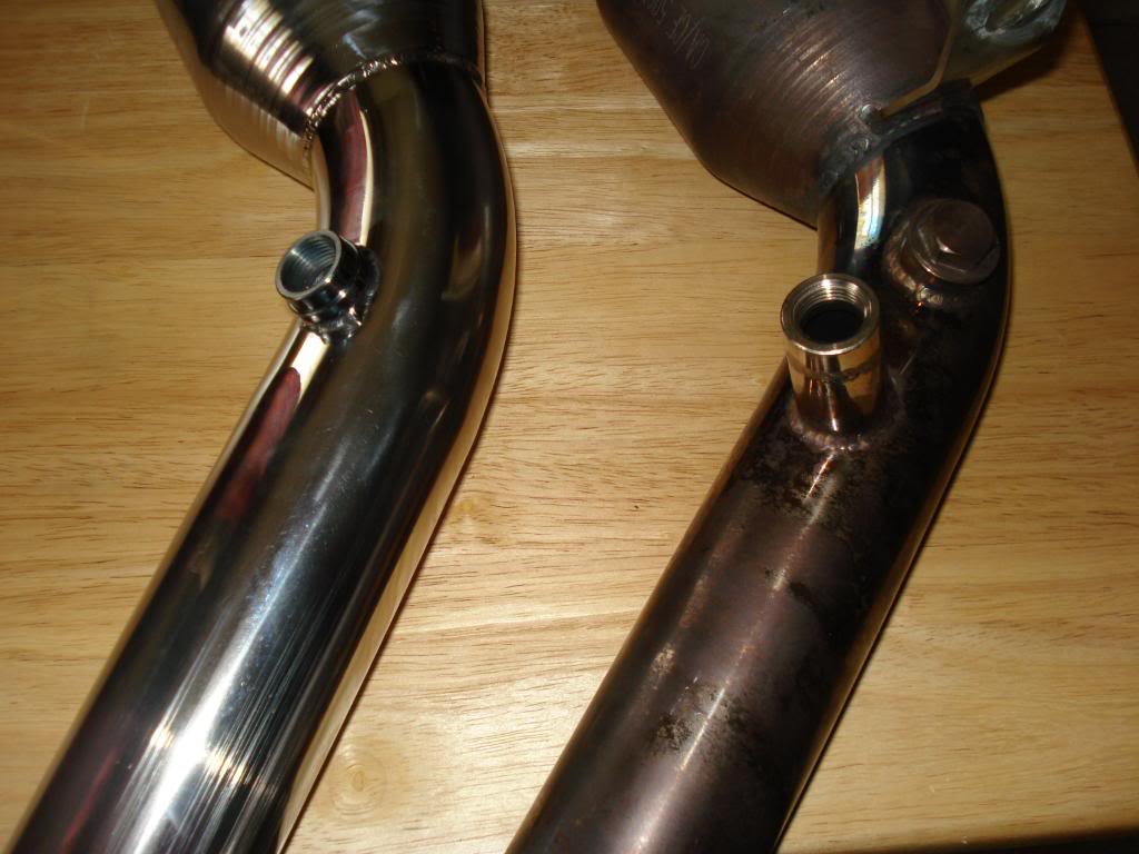

Notice a difference here... The Berks O2 sensors are further out from the piping and the flow of the exhaust.

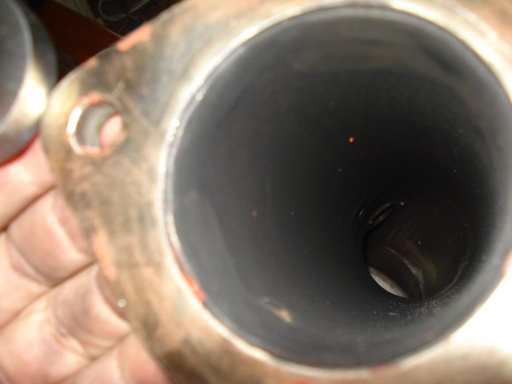

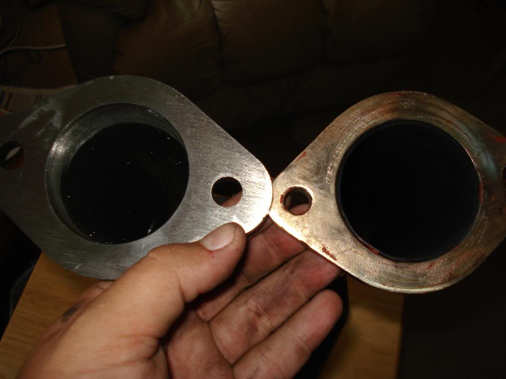

Notice the Lip on the Berks... Im not a welding guru but common sense tells me having a lip would disrupt the flow just a bit...

Another difference is that the Berks HFC have a bracket that connects to the Frame of the car.... The Fast Intentions HFC do NOT have this bracket... however I have been told the bracket is not needed and from installing these myself... I would have to agree that its not needed as there is no play whatsoever in the Cats when they are bolted in to the car. But its there.

o2 Bung Spacing - is a little further out from the exhaust flow

Flanges - look a little better than the Berks
Perfect Smooth connections from the Flange to Piping

I dont know alot... but I think your wrong... because from what I have been told the "nonfoulers" move the o2 sensors farther away from the flowof the exhaust which makes the Car not throw a code...
i may be way off but i think thats what I was told...
