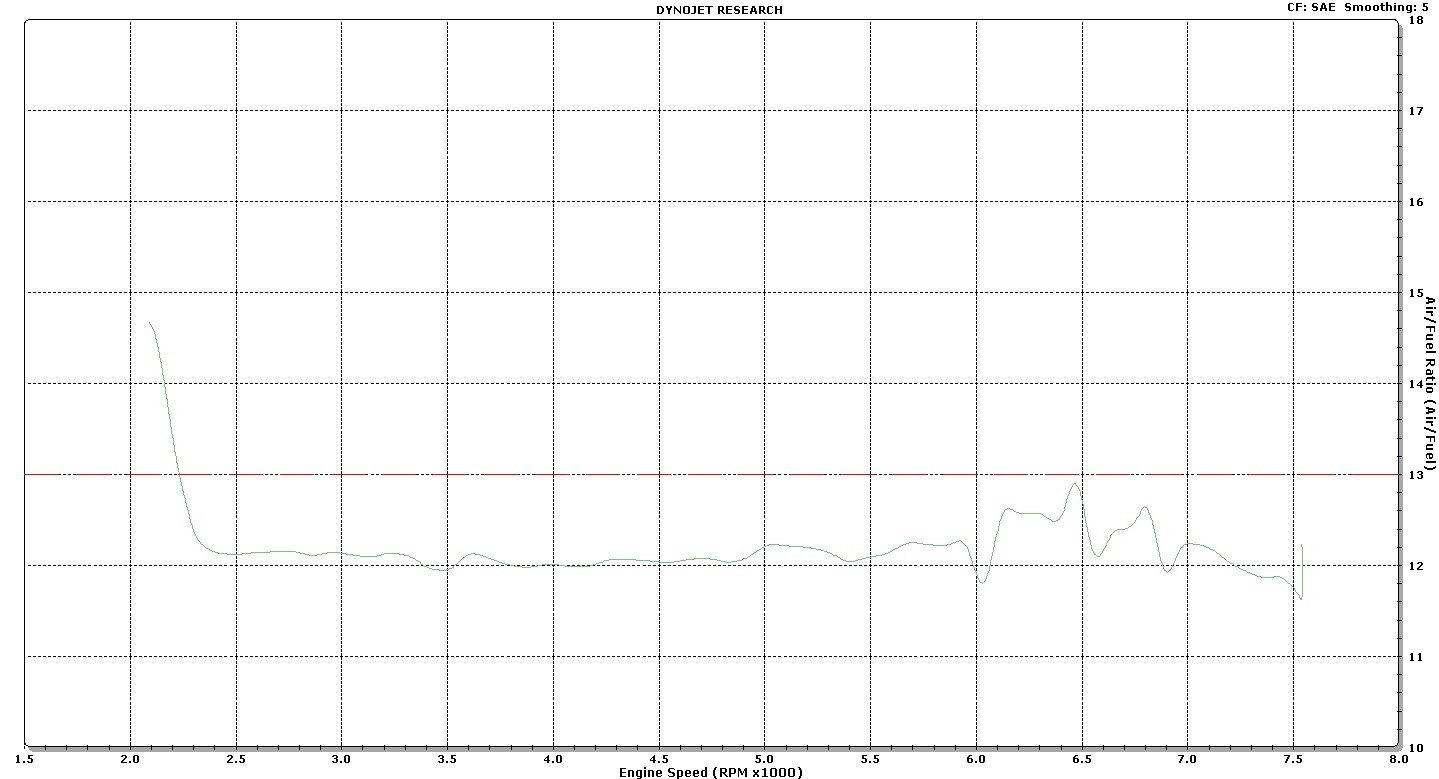

Posts: 3,346
From: Colorado Springs, CO
Originally Posted by shumby
bboy. how meny miles did you put on your car after you installed the HFC's and when you did the dyno? I am just trying to get from you post is the 13:1 to be expected after this install and stay that way or was the guy telling tech's to come over because 13 was good but abnormal and not seen on other cars? I hope the question is clear i know is sounds a little convoluted.
Shumby, I am mistaken. The optimal air/fuel was at idle and I cannot remember if it was 12 or 13. I just remember the techs showing everyone due to that and the power curve. I had other customers taking pictures of my engine and the shop asked if I would like to go to their drifting event to try out my car. I finally found out how to view the other categories on the dyno file like TQ and air/fuel. I thought it only showed HP but finding this Keith's comment makes more sense. I didn't even notice that the air/fuel bumped up like that because I noticed the air/fuel ratio evened out whereas in the runs without the HFCs they fluctuated. The 3rd run did look better though for air/fuel but the other 5 runs I did on the dyno (2 on this dyno and 3 on a previous dyno) didn't look as good. I have attached a pic of the air/fuel for the 2nd run. That is how the rest of my previous runs looked. I dynoed my car at like 4500miles. Both dynos were done on the same day within an 1.5 hours of each other so no miles extra on the car. So as far as the 13:1 goes I don't know. I will need to dyno my car again to see what the air/fuel ratio is at. Again, sorry about my mess up.

Great results BBoy. Thanks for putting in your own time & effort (and $$) to get some 3rd party dyno's.
About your A/F's. 12:1 is PIG rich for a G37. They will typically run ~14:1 in the lower RPM ranges and then 13:1 from mid range to redline. I've seen this time and time again on the dyno. The ECU may trim the fuel tables back a bit to closer to 12:7-13:0, but you should never see 12:1 @ full load on this motor. You guys are putting too much emphasis on just AF curves and not timing tables as well. You can make more power on a richer curve and vice versa.
If you guys notice what we do with all of our dyno tests, we make sure that we get at least 2 identical runs back to back so we know the ECU isn't making any more changes. Then change ONE part, re-test until we get at least 2 identical runs again. We ALWAYS use the same tank of gas, same day, same dyno, & if possible we don't even unstrap the car from the dyno while we do a parts change.
After all that we AVERAGE the gains accross all 4 runs. 50% of the companies in this industry will spit out the lowest & highest numbers to inflate what their parts are actually doing. Dyno's were first brought into this industry as instruments to make people honest, but now many manufacturers are using them as tools to fudge numbers like before.
