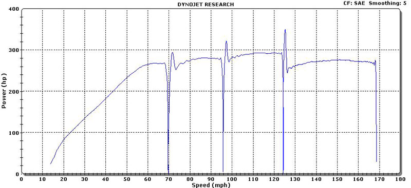

Hello guys, MaxToTheG37 requested that I come on here and give you some information regarding dynoing on a Dynojet Dyno.
Having read through this thread, one thing that seems to keep getting asked is what gear to dyno the cars in. The rule of thumb for a naturally aspirated car is always the 1:1 gear. The theory behind this is that in a lower gear, HP/TQ is being used to accelerate the inertia of the drivetrain faster than the tires, so more power will be lost through the drivetrain than in the 1:1 gear. The same holds true for overdrive gears...more power is used to overcome the intertia of the drivetrain than in 1:1, as the gearing takes away torque multiplication. Here is a graph that illustrates the point. Shown is a 2nd, 3rd, 4th and 5th gear run, known as the all-gear pull.
In the case of bboysteele's car, as mentioned above, as long as the before and after runs are run in the same gear, the dyno will show repeatable and consistent dyno runs, although the peak numbers will typically be lower than what would be found in the 1:1 gear.
Looking at the dyno runs that bboysteele attached to one of his posts, the biggest thing I see affecting the power increase is the air/fuel ratio. If you view the dyno run using our WinPEP 7 software, you will see that the air/fuel ratio after his new cats is almost a full point leaner than the previous runs. This is likely due to the efficiency of the aftermarket cats versus the restriction of the stock ones.
For peak power, most tuners target 12.9:1-13:1 air/fuel ratio when tuning. Seeing that his car made around 12:1 with the stock cats, then around 13:1 after the new cats, I would attribute most of the power gains to this.
As I am not familiar with the G37 tuning and ECU capabilities, I can only give basic information on what normally happens. In the case of most cars, they have a "target" air/fuel ratio that they attemp to achieve. When things change, like changing to aftermarket cats as above, the air/fuel ratio may change for a short period of time, as the car samples O2 sensor readings and tweaks the short term and long term fuel trim values. Typically, with some driving, you will find that the car will identify the lean or rich condition, and adjust to match it's target A/F ratio again. The only way to keep the power gains associated with the power made by A/F ratio changes, is to program the ECU to target those values instead.
Hope this helps.

Thank you for the explanation DJ_Keith. If I understand the last part of the post, basically the gains will be nullified by the ECU's programming once it gets used to and adjusts for the leaner A/F mixture. If that's true, I may wait to get exhaust mods until a reliable ECU reflash is available.
I can't say how much of the power gained is from A/F getting closer to what it should be, or how much was from the cats. The only way to know would be to let the car "learn" the fuel trims and re-dyno. Air/Fuel should be back to what it was before (around 12:1). Then, the gains left would be from the restriction loss only.
Thing is, there will also be some inconsistency in the vehicle that you can't account for. Normally, we'd like to see testing all done on the same day, as close in time as possible.
