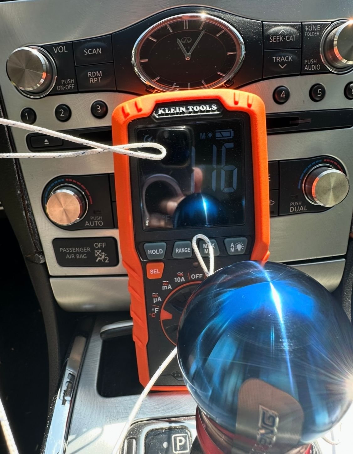

Well, after 30+ years my trusty Fluke multimeter finally decided to give up the ghost. So, as I had to get another unit and I know I don't have another 30 years in me I went with a basic one. Tomato / tomahto...
As I said I would here are some readings from today's trip. I tried to take pics with the clock to show passage of time relative to temperature change. All temperature readings are in Fahrenheit (°F).
Unlocked the car and the internal temp was 116° and outside ambient 93° (not including humidity/ heat indices):

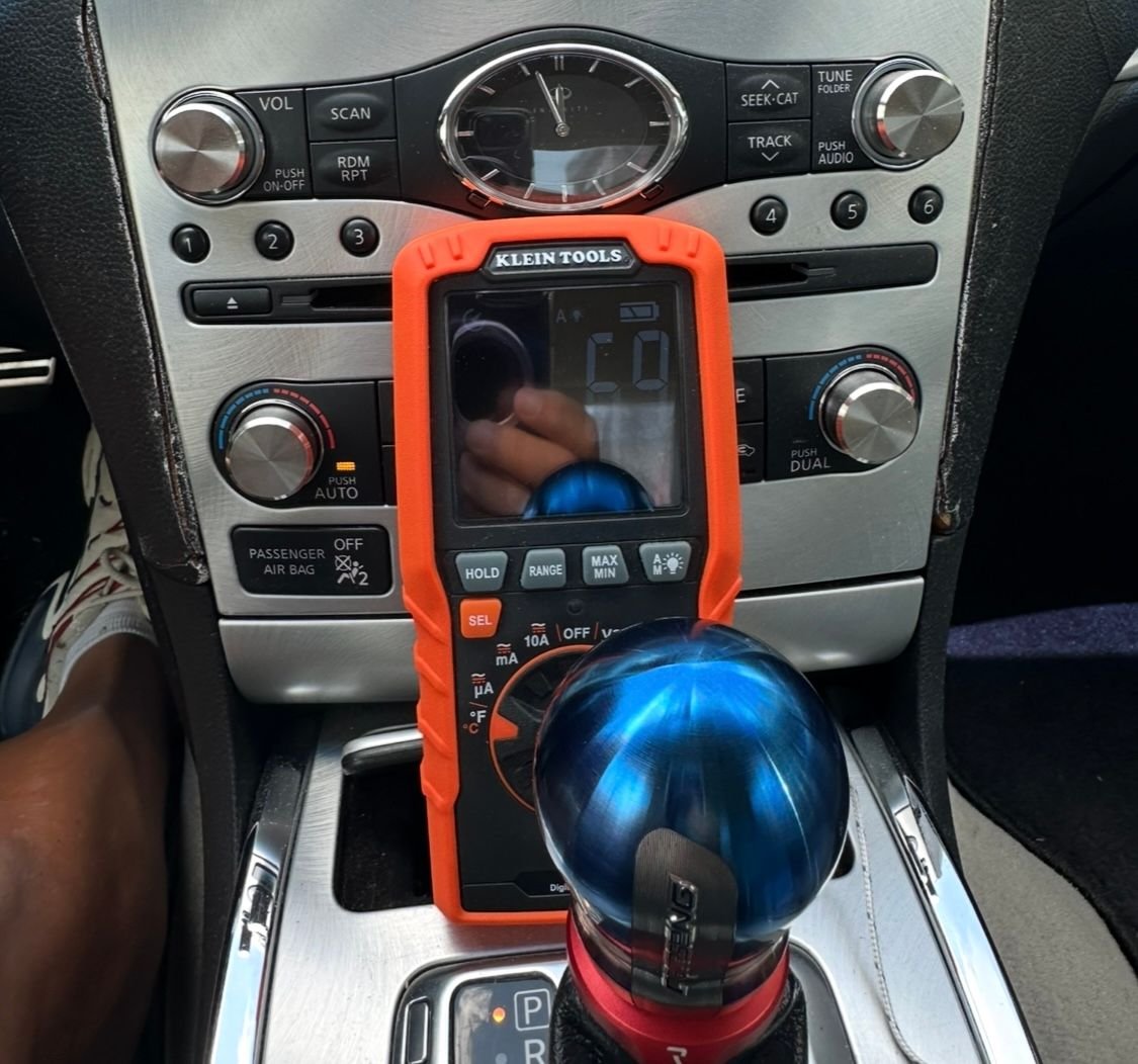

Car at stationary idle with temp dial set to 60°/ AUTO/ fresh air OFF the outlet/ vent temp was 57°. At this point all 3 fans were at 100% duty doing their thing:
At highway speed vent temps dropped to 54°:
After approx. 30min. changed temp dial to 69° still on AUTO and fresh air OFF. Cabin air temp (as measured by the center console/ shifter) was 72°:
Arrived at final destination (total trip time just under 1-hr. w/ mixed 60/40 hwy/city/ bloody tourist traffic) the cabin temp was 69°- which is what I had the dial set to on AUTO with fresh air OFF:

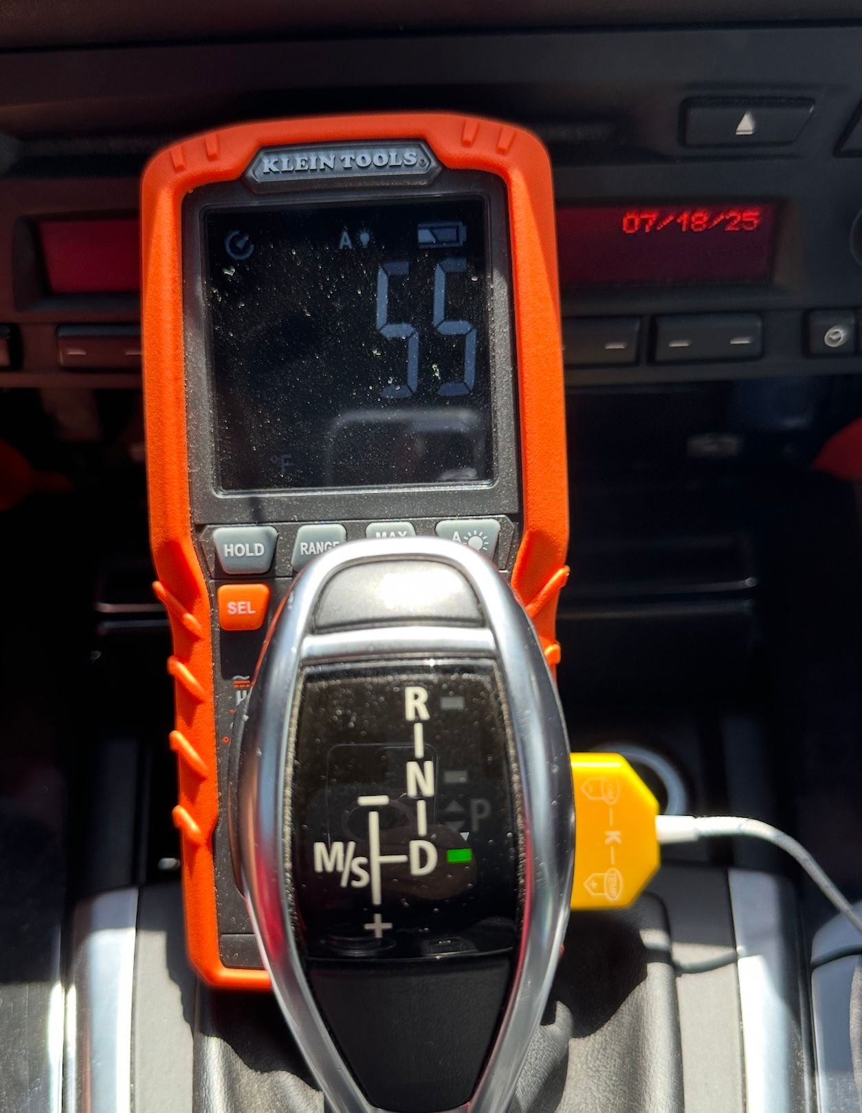

So, for Schlitz and giggles I decided to repeat the above AC temperature test on the Zed/4. I always felt that the AC was not "quite as good" as on the G37 and while I am comparing a apple to a orange (almost literally) turns out I am not as nutty as I thought.
Internal cabin temp was 137º and outside ambient was 95º (though gauge cluster said 94º). Heat index was 101º per the weather app on the iPhone. Miserable to say the least.
After a few minutes with car at stationary idle, with the AC set to "MAX AC" the temp at the outlet vent was 75º. Important to note, the Zed/4 only has one, large radiator fan and while it was at full duty, the temp at the vent was ≈20º warmer than the G37 at the same point in this "test."
After ≈10min. at highway speed the outlet temp dropped to 55º. The extra air flow across the condenser made the difference here. I am assuming the radiator fan pushes "just enough" CFM to keep things going.

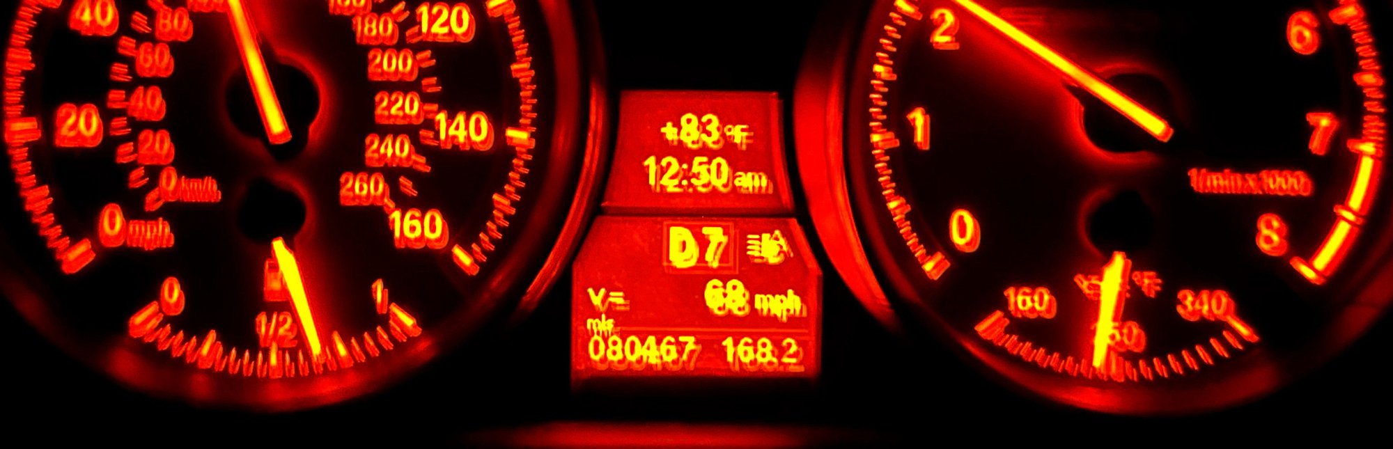

Key takeaways... for one, I am comparing a Japanese Coupe to a German Roadster so take that as it is. One would assume because the cabin is super small compared to a Coupe or a sedan that it would cool faster. Nope. The BMW has a "all black" interior save for the orange pieces and we all know black holds heat. So, perhaps it takes longer for the AC to remove all of that stored heat in all the black plastic trim- and there's tons of it. Then again, the car is a roadster so perhaps BMW just put in a basic system figuring most people drive the car topless which I do when its not searing hot outside.
However, when its 83º at 1am its almost perfect for killing the AC, dropping the top, blast Coldplay's "A Sky Full of Stars," and just take it all in:
Not the best moon shot, but I wasn't exactly stationary The "red stripe" is the guard rail on the road with the tail lights reflecting off.
