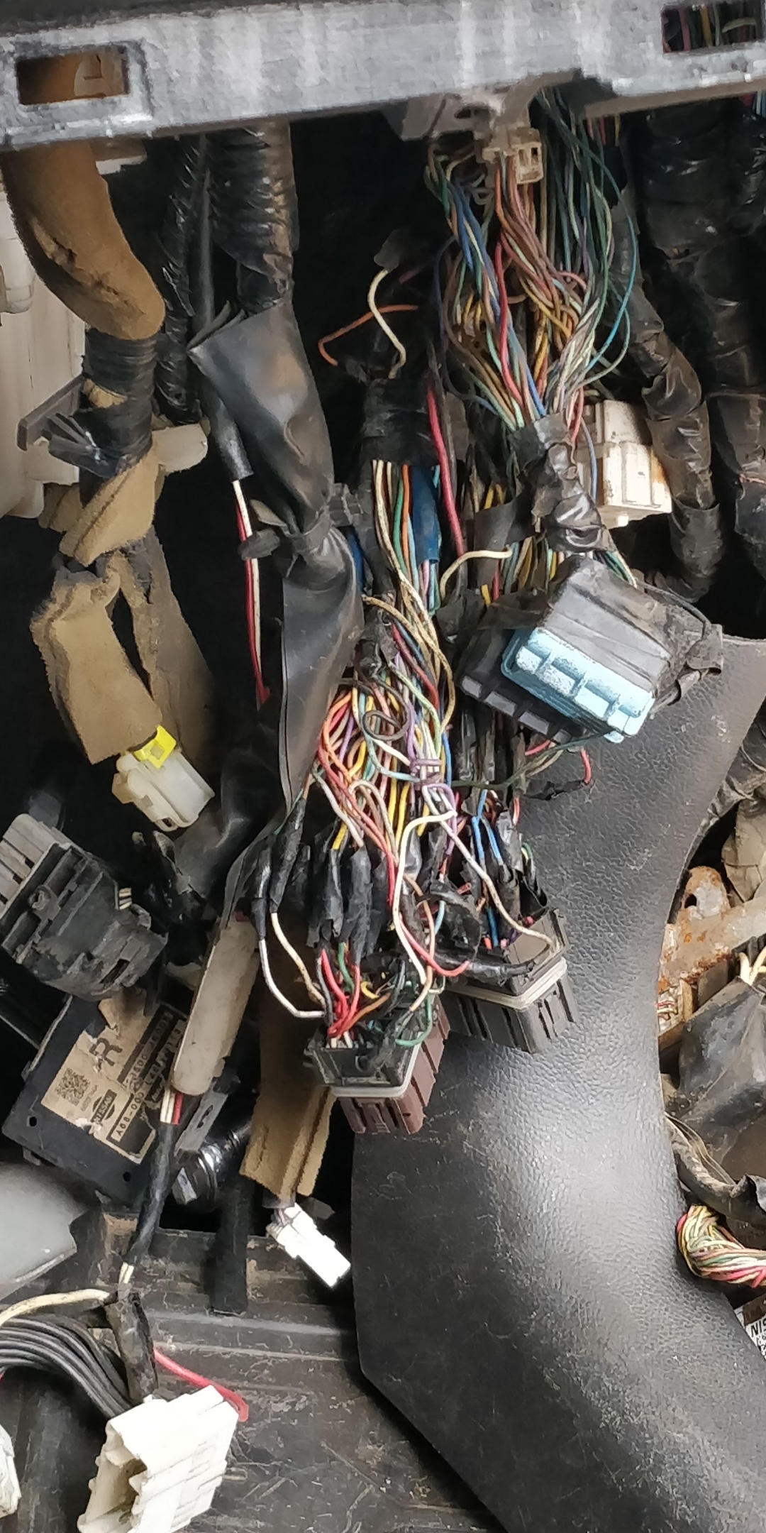

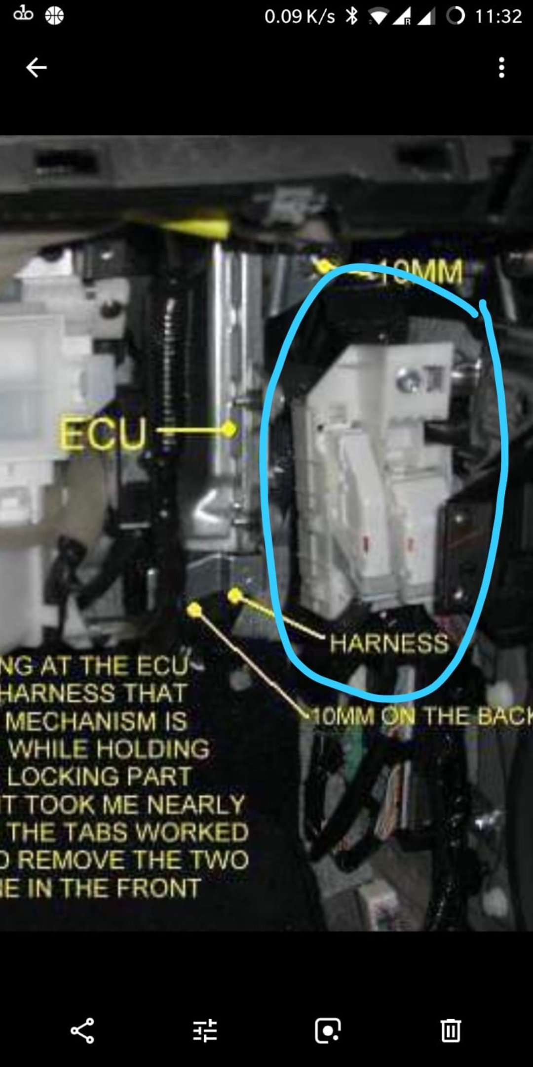

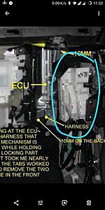

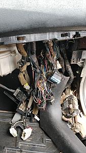

I have very serious extenuating circumstances, I discovered that the connectors leading into the ECU were all severed and rejoined together with another harness head, several wires are left open with no connection, and to make things worse I've been having misfire along with TPS issues. Because voltages are out of order when I was checking with my meter.
I'm mainly looking for the harness set that includes this white socket that's circled. I've determined that it houses 1 connection from the engine room wire and it also sockets wiring coming along the passenger side floor trim. So I would need that group of wiring also.
It truly amazes me how this car is operating, and no wonder I got it so cheap.
