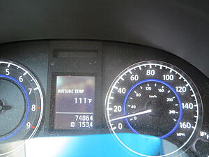

Originally Posted by Bostonreefer
i have seen 109 this summer on like a 90 degree day.... so yeah. as others have said seems to eveb out longer i drive
As others have written the sensor will read high if you've been parked on a very hot day. After you drive a few minutes it will read the same as on my IPhone
Telcoman
