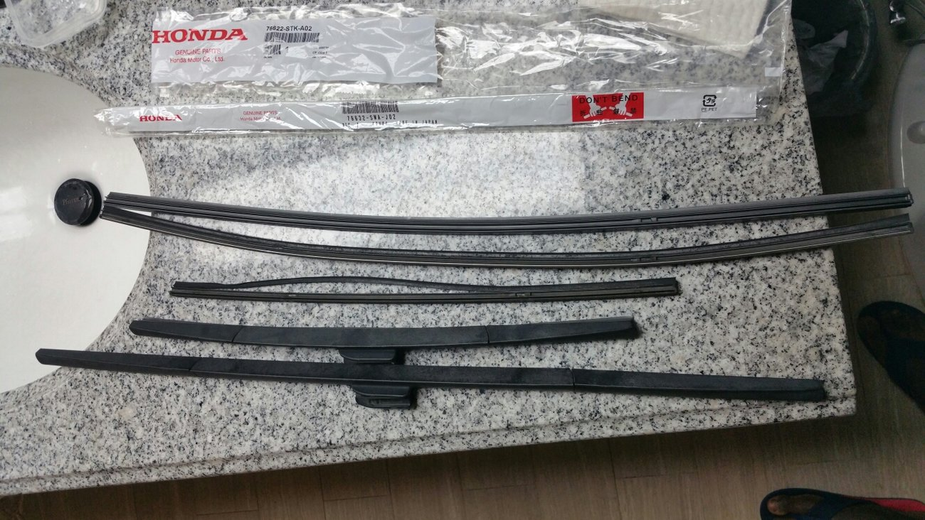

Hey, these wiper refills do not fit on my 2010 G37x. The brand is the same. the lengths are OK. But the base on the Honda ones is too big to fit. I'll try to attach a photo. Honda on the left, original G37 on the right.
Old Mar 2, 2018 | 10:21 PM
JSolo's Avatar
JSolo
Just say no!!!!!
iTrader: (14)
Joined: Oct 2011
Posts: 6,103
Likes: 593
From: People's Republic of IL
You sure you got the right honda parts?
We have both a honda and a g37 in the household (2015 accord). The larger driver side refill is identical to both cars. Passenger side differs by an inch or two.

I had the same problem as unrealguy69 with my 2008 G37s coupe. My guess is that Infiniti changed the design or parts bin part for the wiper beam (the reusable part) somewhere during production.
I ended up ordering a pair of refilles for $44.xx from the dealer that were produced in 2017 according to the bag . They seem to be doing well, quiet, no streaks so far.
My OEM Beam (insert holder) looks different than the two pictured in Guy Gourdet's images (below). My OEM beam does not have the joints at 1/3 and 2/3 through the arm. It is a single flexible piece with a smaller center plastic piece where it connects to the metal arm.
Hopefully this helps a few others. Thanks to both unrealguy69 and Guy Gourdet for the pictures!
