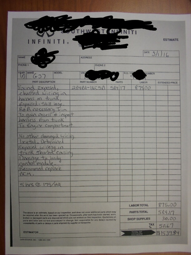

Update..
Car still not fixed... BCM replacement looks like..
So does that means my car is covered under-warranty electrical wise after BCM replacment??

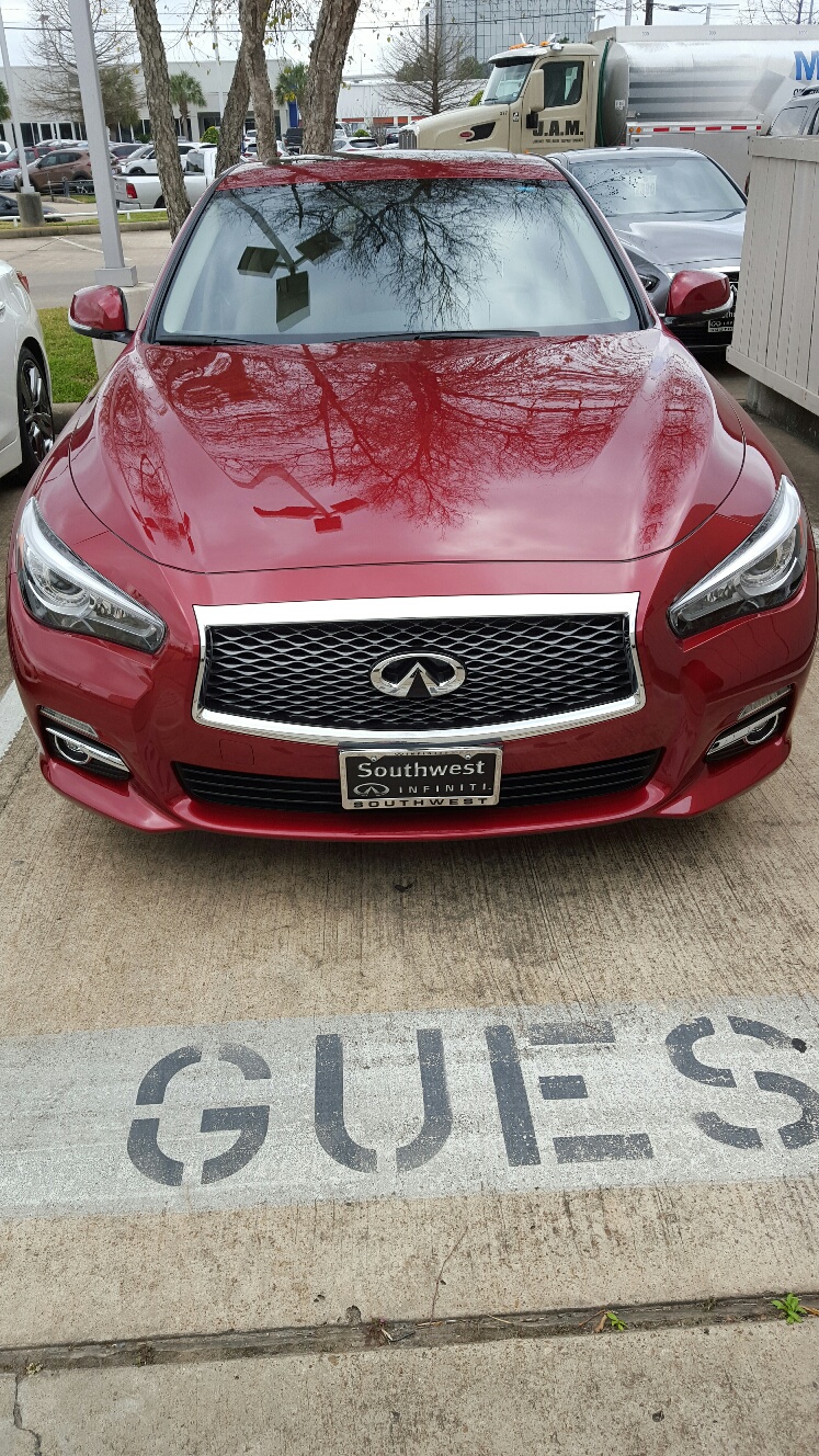

so they set me up w/ the Q50.
inside is way too sportier for a sedan... luv the outside tho.. getting used to the inside features but not straight forward as the G37.
driving wise: no hesitation like the G37 (7AT) on freeway. steering feels like the whole car moves w/ you when turning instead of more like the front. dang the manual sport mode is a beast... didn't realize I was in 1st gear & thought I was in Sport mode only.. sucka is fast!!

So your insurance company just paid $1500 for something that didn't fix the problem. That kinda sucks. (This is all covered, right?)
Bizarre that they think the shorted wiring (which again WORKED immediately after your accident) would have fried your BCM... But replacing black boxes is the go-to repair scheme and I guess these boxes are electronically fragile, so, anything is possible. Sure hope they can solve the mystery.
I don't know about warranty but I would suspect that any Infiniti parts installed by an Infiniti service department to be covered for some period of time.

Yes, thank god & hopefully insurance covered it. the estimate w/ cost was sent over to insurance company for approval.
they found 2 smashed wires. repaired it but still trunk release button doesn't work. guess bcm is the next step so we'll see..

I thought the BCM replacement seemed like an odd decision. Kind of a conflict of interest really - when insurance money is available it's like a green light for the service department to do costly repairs... I hope State Farm goes after them for the misdiagnosis and unnecessary expense. And sure glad YOU are not paying these bills.
This single function you are trying to get to work (as it still did after the accident) involves about 4 components plus wires, so you'd think they could solve it.
