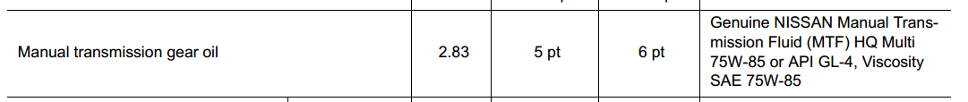

From the fsm:
question: clutch-2d2tdkm.png
From the owner's manual
question: clutch-4jm78ui.png
75w90 is called for for the diff/rear end. We still got another month and a half of winter here in chicago, so no warm up in the immediate future. I suppose you could shift 1-3, double clutch, or allow the car to warm up more. As I understand it, the syncro's are not doing their job which is why it's difficult to get it into gear (1-2) when the fluid is cold. I suppose this could cause a dangerous situation if you need to get the car going quickly while it won't engage a gear.

Originally Posted by Jsolo
From the fsm:
Mine shows something different. It shows 85 or 90. I only chose 90 because it seemed like others recommended it and that's what the shop I brought it to sold me. I can't figure out how to post a screenshot with my phone here but if you go to page 382, you'll see what I mean.
https://owners.infinitiusa.com/content/manualsandguides/G_Coupe/2008/2008-Infiniti-G37-Coupe.pdf

^^My pics were from a 2012 fsm and owner's manual. Looks like they updated the recommendation since 2008. In fact, the fsm (for the 2012 MY) has a revision date of 2/2013.
Either way, it's just like with motor oil, if you're in a predominately hot environment, an mfg may recommend using a higher viscosity oil (although it appears nissan recommends 5w30 regardless).
You'll be fine once the weather warms up, but cold temp shifting on a cold trans will be difficult for the time being. I don't know if my experience with mt85 was a fluke. Perhaps because it's a high performance oil it doesn't last as long or the additives wear out quicker. For now, the stock oil has been working good. It's not buttery smooth when warmed up (about 90% of what the mt85 was), but I can shift the car easily until warmed up.
