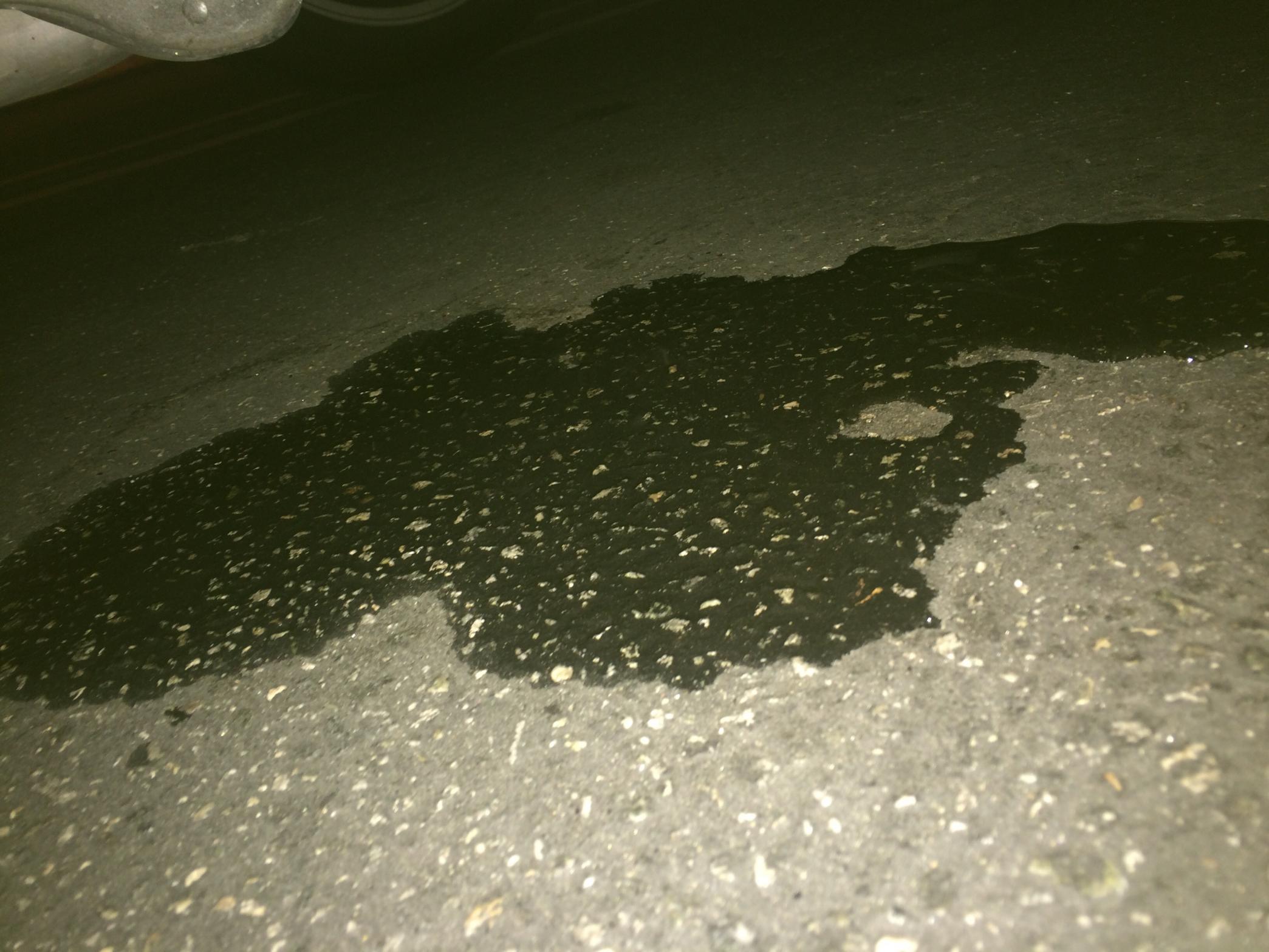

i let ac run for 15 mins i see drip under the car.
i didnt trust the dealer either!!!
Attached Thumbnails gurgling fluid sound from glovebox!!need help plz-image.jpg

That doesn't look like a lot of condensate for running 15 minutes. Check the drain tube for blockage. Get under the car and look for a white piece of tubing hanging down beneath the area where you hear the noise. Ream it out with something and see if you dislodge anything and debris and water come out.

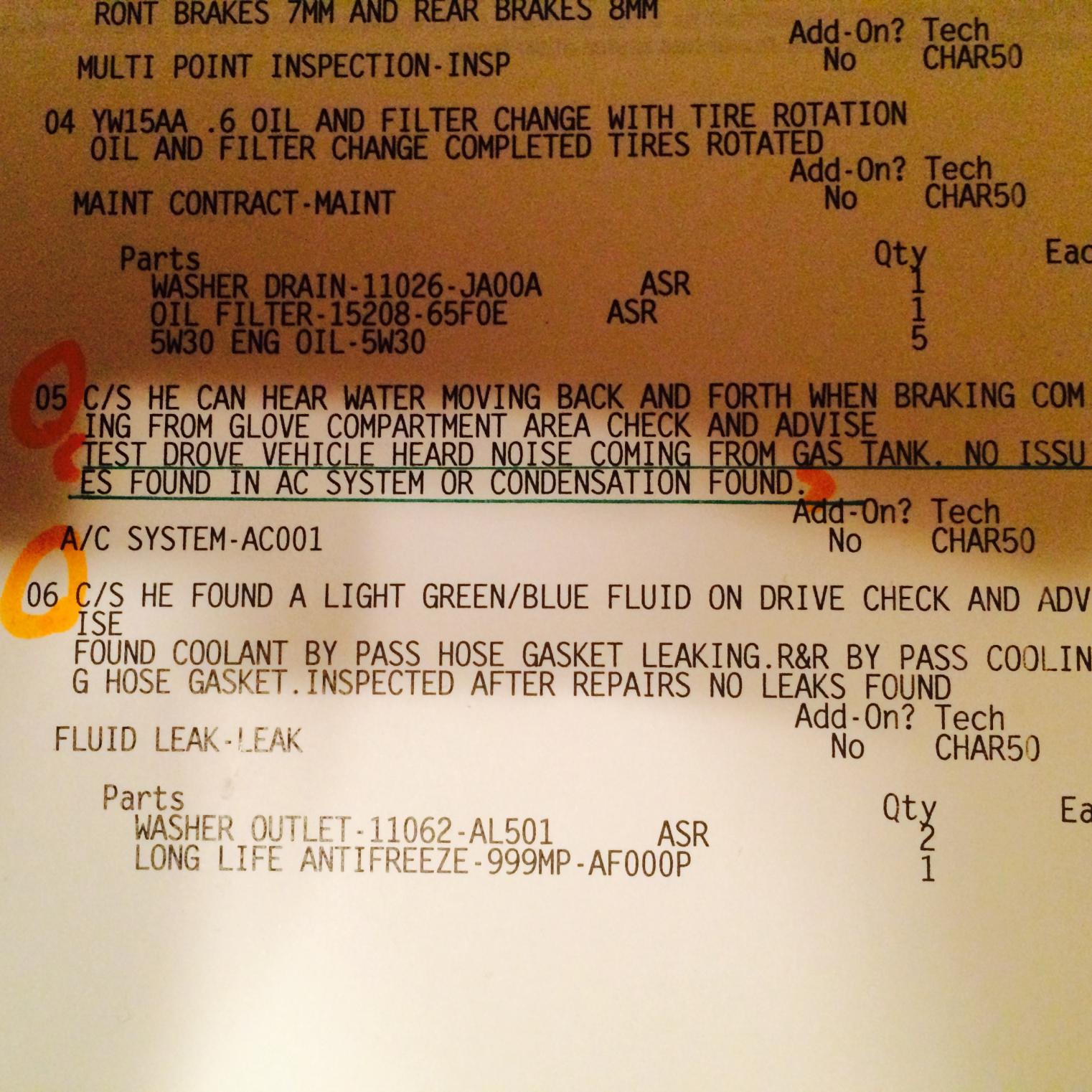

just found out more info from report paper

I had the same problem in my M37...when I hit the brakes sounded like water was in my dash...they tried to purge the heater core and it turned out they couldn't remove the blockage so the had to replace it.
Have them purge the system again but you might have the same issue I had...this occurred around 60k...thank God for the extended warranty.
