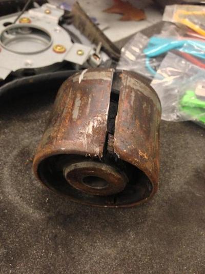

Just like in the picture I dropped the diff out took the sways everything out and I drilled a couple holes into the rear dif bushing stuck a hack saw with a metal cutting blade in and cut the rear bushing out because there was no give. Ill take a picture once I'm off work

I didnt have a press or a tool big enough to pull this out. remember when doing this do it from the inside out towards the rear of the car. If you try to force the bushing out towards the front it will not come out. Same goes for installation it will be put in from the back
I drilled a couple holes for the saw to fit in which would allow for over 1mm to be taken off of the bushing because this thing was not coming out with a hammer

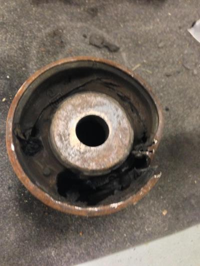

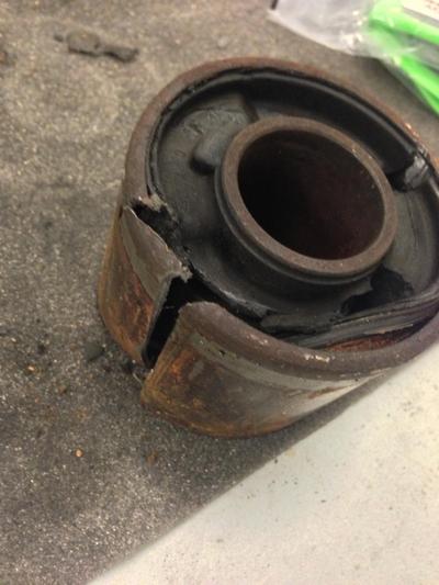

I pried a bit back to give me more wiggle room and it fell right out after a bit of a fight

Just remember to take some course sand paper and sand the inside of the bushing walls, removing all the old rust. This it will make the install much easier

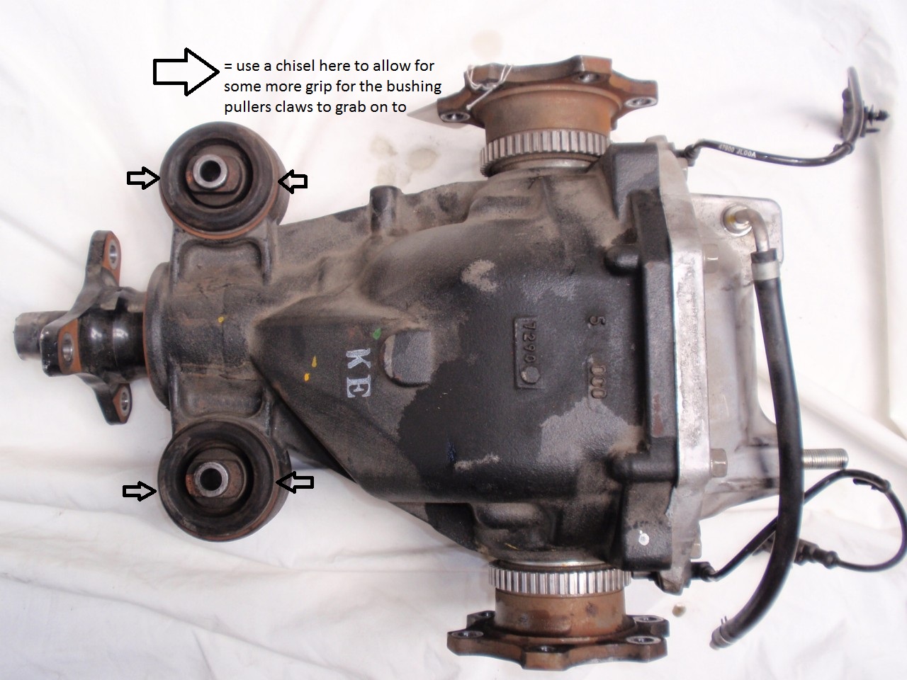

I bet of you took a chisel to the corners and hammered them inward it would work as well but I never tried that on the rear but thats how I got the differential "ear" bushing out. I hammered the chisel right into where the bushing sits with the ear to make some room for my bearing press to get some grip
I used this tool but with longer claws to push the bushing out.
