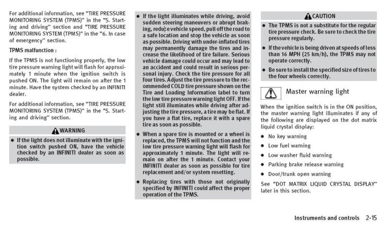

There is multiple meanings to the exclaimation mark. I will read the manual for you.

SO yeah , it's the low tire pressure symbol. i took it to get air but the symbol is still on.. am i suppose to bring it to the dealer? btw thanks for the help.
Old Oct 6, 2009 | 01:00 PM
GeeeeOhhhh's Avatar
GeeeeOhhhh
Joined: Feb 2009
Posts: 7,932
From: Lancaster, California
Just drive on it for a few days from what i hear the TMPS needs to recalibrate itself.
Old Oct 6, 2009 | 01:04 PM
rennnnny's Avatar
rennnnny
Joined: Oct 2009
Posts: 6
Alright ill do that. Thanks again!
