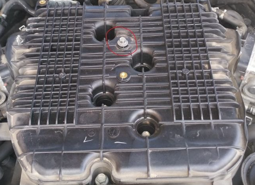

do you have the engine cover on?
i remember i took mine off and the middle bolt in the plenum causes a vacuum leak so that can be an issue
