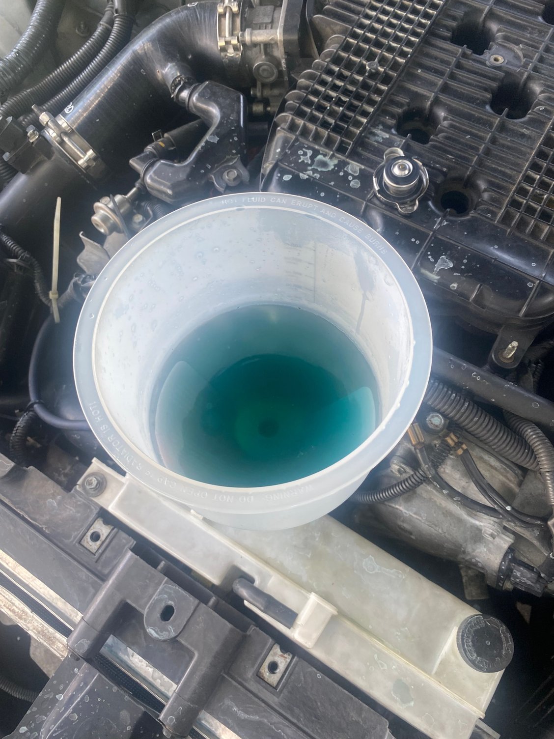

2010 G37x Overheating when idle
I need help trying to figure out why car is overheating I don’t see no wet spots on the ground but my coolant reserve is overflowing I changed the radiator cap Al ready and I just put in a new radiator because I thought it was the radiator but it wasn’t also I just added a new thermostat. So do anybody have any ideas what’s causing my car to run hot when it’s idle at a red light the temperature rises 75 percent up dam near full but when I start back driving it’s goes back half way.
I even bleed the system twice to see if it’s air in the system
another thing my car is running lean on bank 1 and two because of a exhaust leak but I have new y-pipes coming so I don’t know if that’s the case I’m trying to see if it’s a failing water pump.
