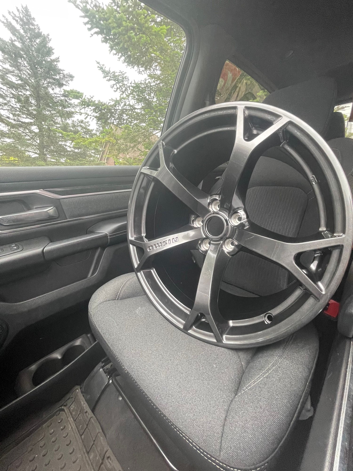

Front 19x9.5 Rear 19x10.5
‘11 G37x I need help figuring out tire size for these new wheels (I’m clueless). I’m running air suspension (airlift 3p) I don’t want to rub or cause any issues. would a 265/35/19 & 245/35/19 tire setup work?

I would suggest 255/35R19 squared.
This will fill the front up more since the offset if high on the 9.5" and the 255/35 will give enough clearance in the rear with the 10.5" +23.
