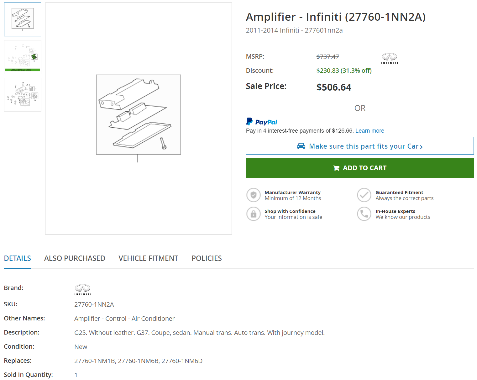

I had the same problem this past Spring. It's a fairly common issue & the remedy ended up being an HVAC module behind the radio that needed to be replaced (see below). Verify that the part number matches your car. These can also be found used on eBay much cheaper but I wound up buying mine new from a local dealer.

I just did the ac amplifier and it's the answer. You can find one in your local junk yard and look online for the list of cross references
27760-1NM6D
27760-1NM6B
27760-1NM1B
27760-1NM2A this is the new number for the replacement of all these oem p/n
