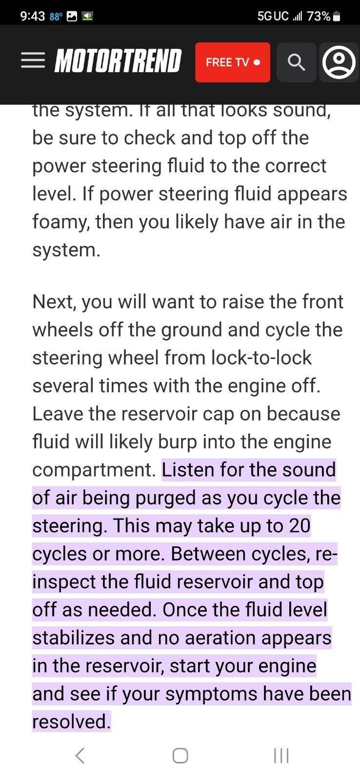

Old Sep 5, 2023 | 09:58 PM
mummy2's Avatar
mummy2
Joined: May 2011
Posts: 985
Likes: 144
From: Baltimore
Originally Posted by TheRob
How do you get air out of the tank? Thanks for replying.
Old Sep 6, 2023 | 10:05 PM
TheRob's Avatar
TheRob
Joined: Nov 2022
Posts: 50
From: Sarasota, FL
Originally Posted by mummy2
Thank you. I'm assuming the fluid needs to be MAX for it to be considered full? Mine is under the max line and at the minimum line. I haven't been able to get the pump
and fluid yet. I definitely plan on doing it this weekend. It's like the car is groaning at me from something in Lord of the Rings when I turn the wheel at times.
Going to drain it, refill with new fluid, jack up the car and turn the wheel to lock 20 times each and I guess report back. Otherwise, I'm guessing it's the PS pump itself. Going to
check videos to see how easy that is and if I can handle it.
Appreciate your reply.
