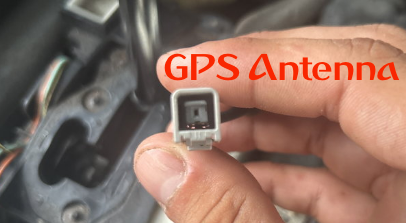

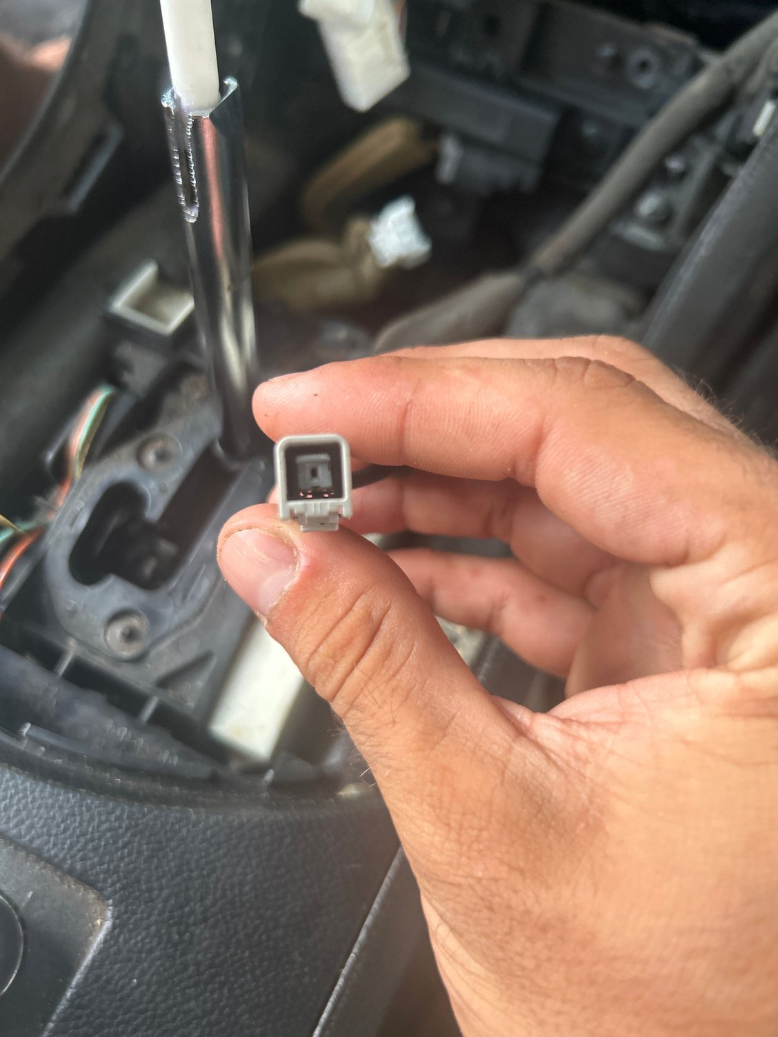

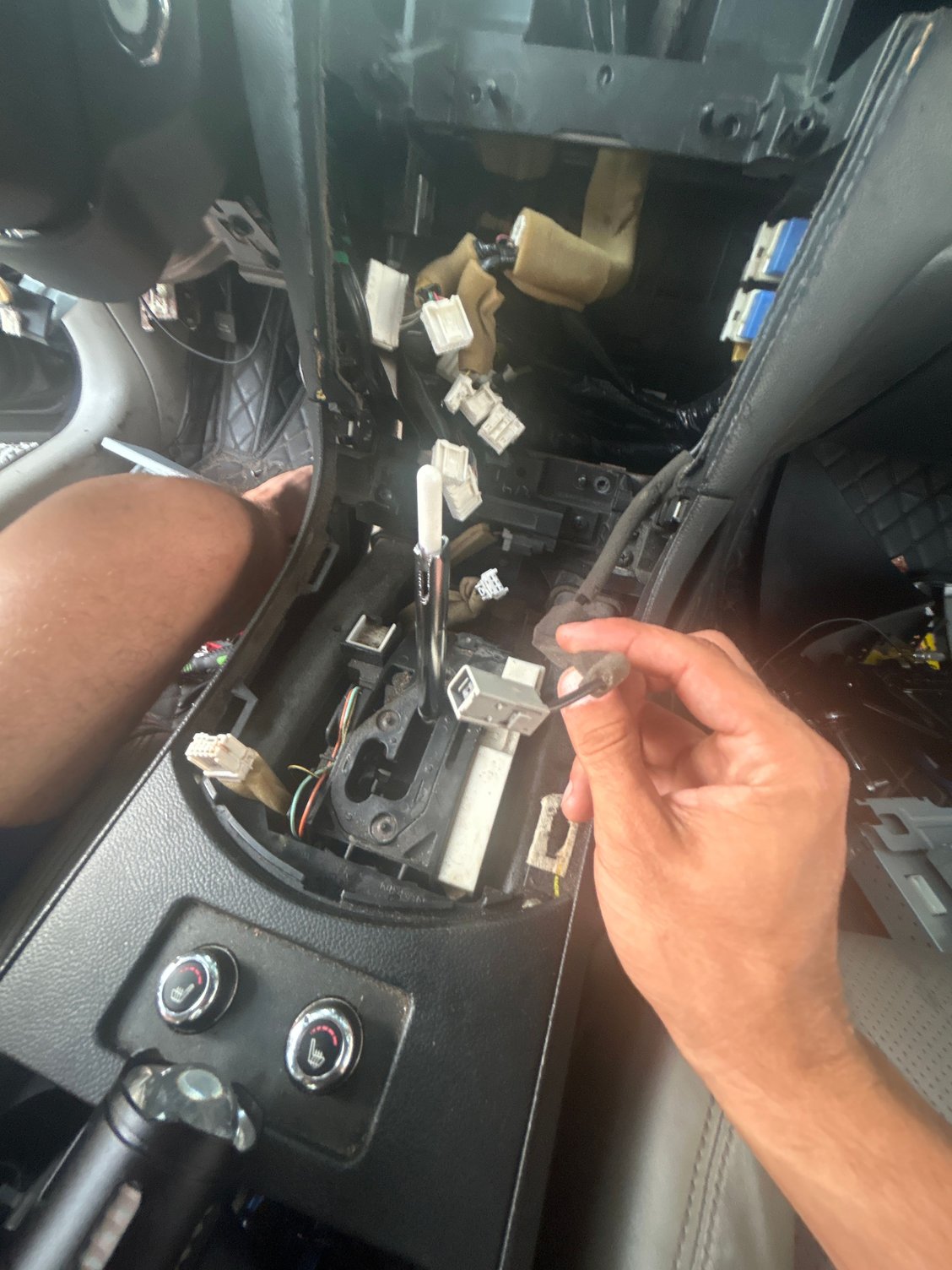

Hello today I was replacing my dash and I Disconected this two cables that I have no idea where they go, if anyone could help me it would be much appreciated it, AC is not working

Ok, the gray one in the first pic is for your GPS antenna:
That gets plugged into the back of the AV headunit.
Can you post a pic of the wires on the second connector? It appears to be for the SNOW mode switch but I can not tell. The wire colors will help. If it is the SNOW mode switch you can leave it unplugged as your car is not AWD.
As for the AC not working, make sure the two connectors marked in YELLOW are plugged into the back of the Unified Meter/ AC Amp- this is the white, plastic box that is mounted atop the AV headunit like so:
Also, make sure the proper connector is plugged into the Preset Switch panel (the clock one).
It is very easy to get these connectors mixed up.
