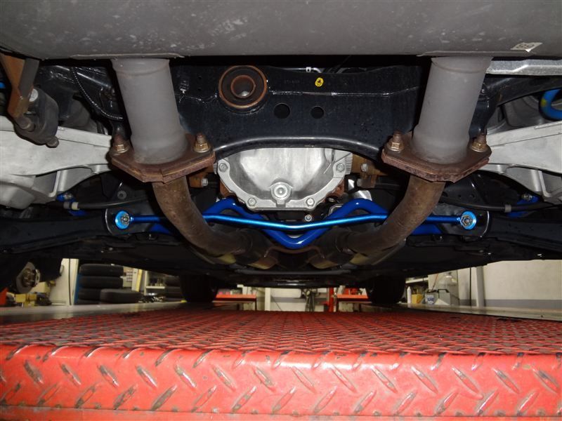

I've been contemplating the diff brace as it appears to help with the preservation of the diff bushing.
I also have a Cusco rear power brace, which is an excellent mod as well, so I'm hoping it doesn't interfere with the diff brace: https://conceptzperformance.com/cusc...-r_p_18873.php
In 3-4K miles I'm at 30K on the diff service, so I may try to install when I change the gear oil in the diff.
