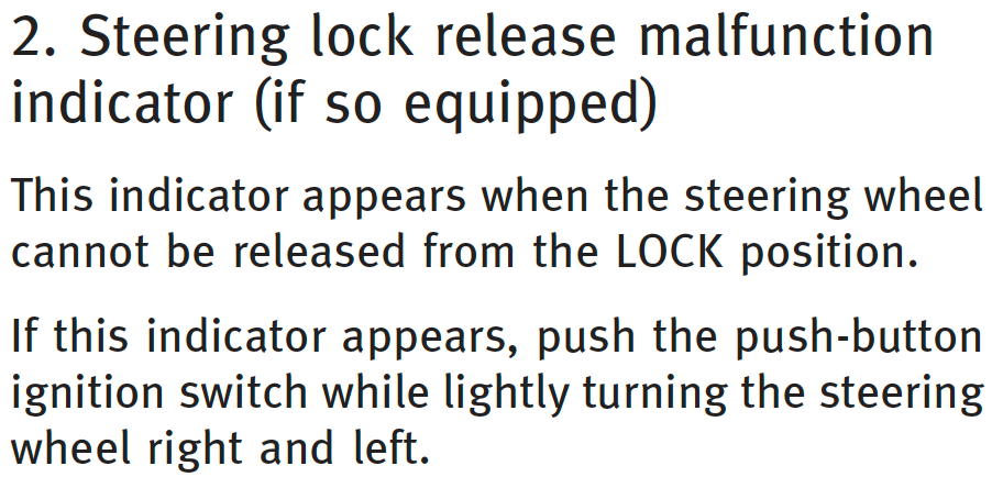

I called lock smith and he couldn’t get it programmed , I also put the the old bcm and ecu back in car , but still no reaction , except it shows the steering wheel on the the dash says move side to side but still nothing , not even radio or ac come on

This?
If the steering lock module (ESCL) is "stuck," which is a common issue for some 2009-2011's, then the car is dead in the water. There are TONS of threads here and all over the web about this issue and potential hacks to fix it. Until that is resolved, nobody can unbrick the car.
Best advice: keep pressing the START button while tapping the ESCL with a mallet- if it unlocks the car will wake up. If not, forget emulators or "jump wire" hacks- they don't work on these cars. Go to a junkyard, or eBay, get another ESCL. Once the car is up and running AND WITH IT RUNNING, pull the STEER LOCK fuse under the hood..
