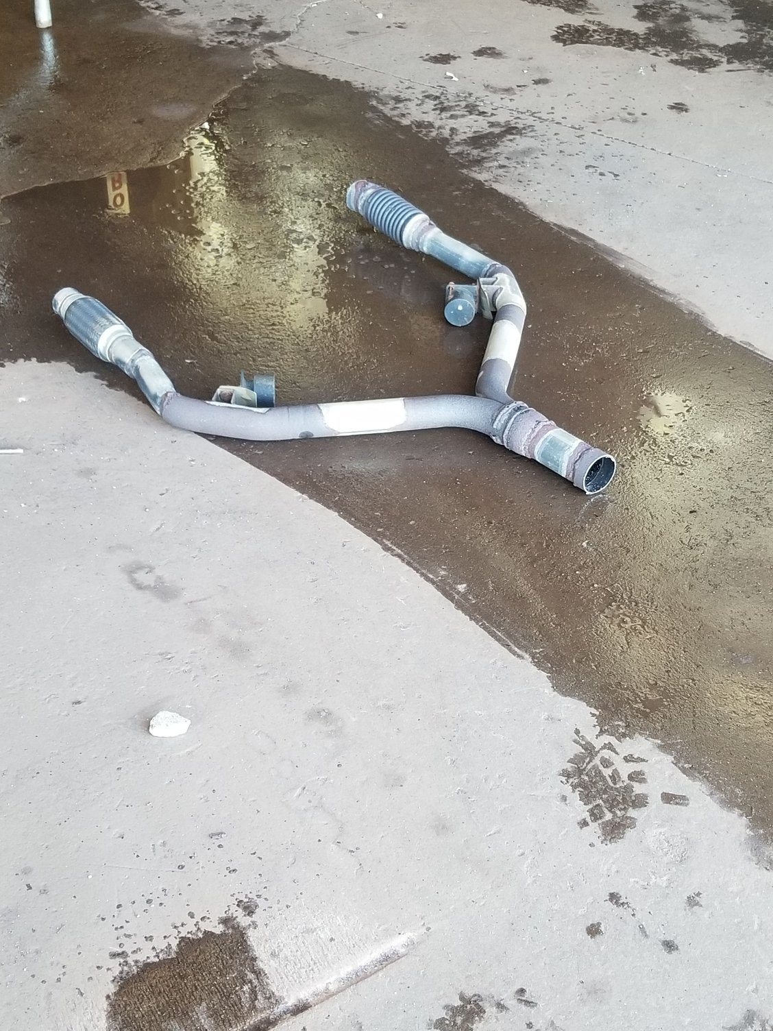

Mid 2020, started to have some Cat issues(small crack), which I think was related to some other repairs. A year later that crack got worst and CEL popped up every few 100s of miles (P2A00). Spring of 2021 had to cut the resonator in order to weld new Y pipe. End of spring, decided to order a new set of FI Cats( old ones lasted 5yrs). 600+miles later and no CEL after the new install.
Stock Y pipe🗑

Do you think the cracks in the welds had anything to do with the FI design consideration that you do away with the support brace under the transmission?
That always seemed odd to me, although I've some faith that FI knows what they're doing, and in the last 10 years here this is only the second time I've read where someone's FI cat welds cracked.

^^ I've never liked how they got rid of the cat bracing. The exhaust already doesn't have enough hangars really and then they removed the connection point to the transmission. I went with the Z1 for that reason.
I'm not sure who to blame, especially since mine were welded directly to the flex pipe after a few years and I believe the entire pipe was moved to do some repairs. A muffler shop guy, blames it on the weld design and possibly due to the way the engine shifts. IDK.
