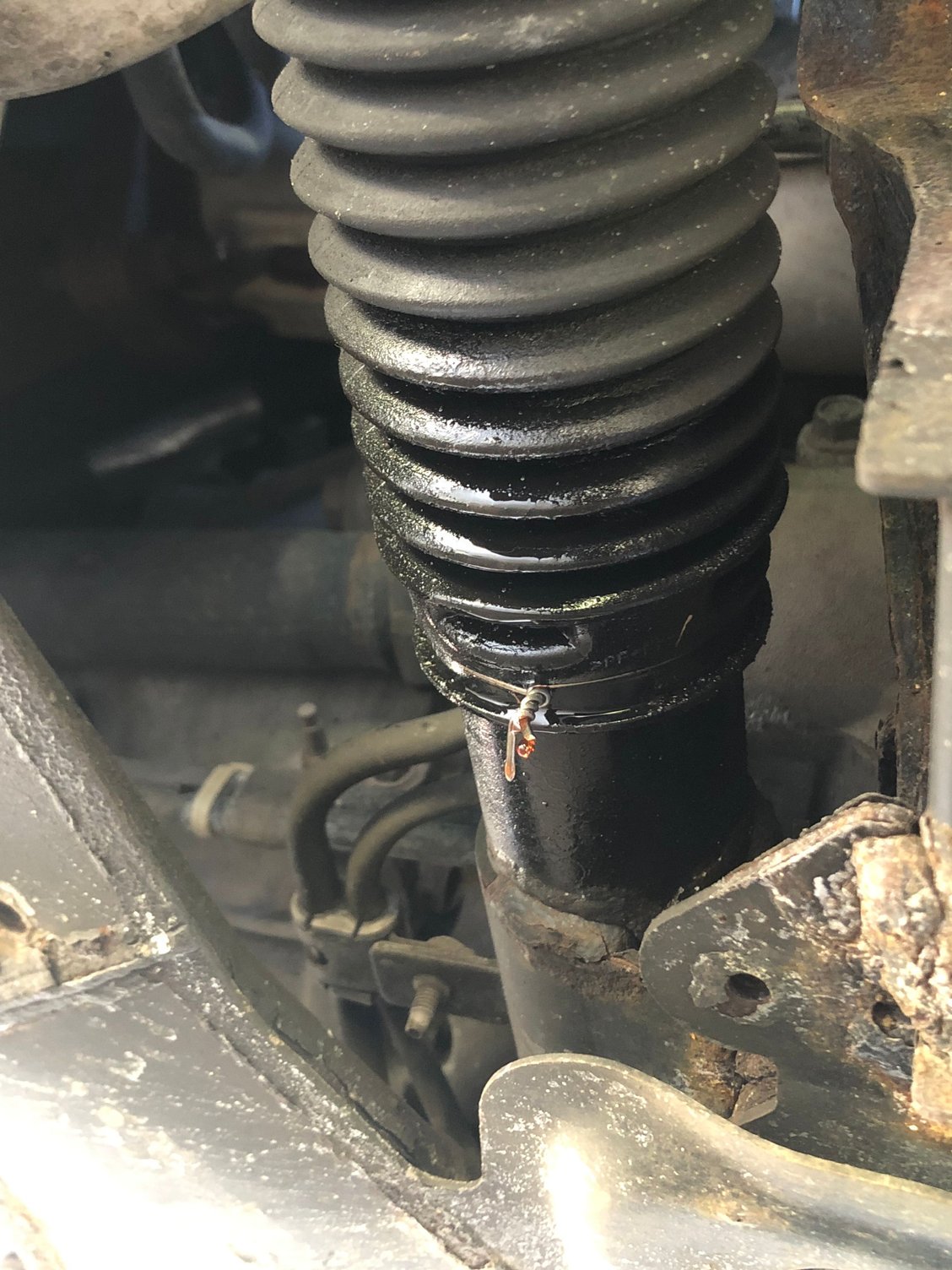

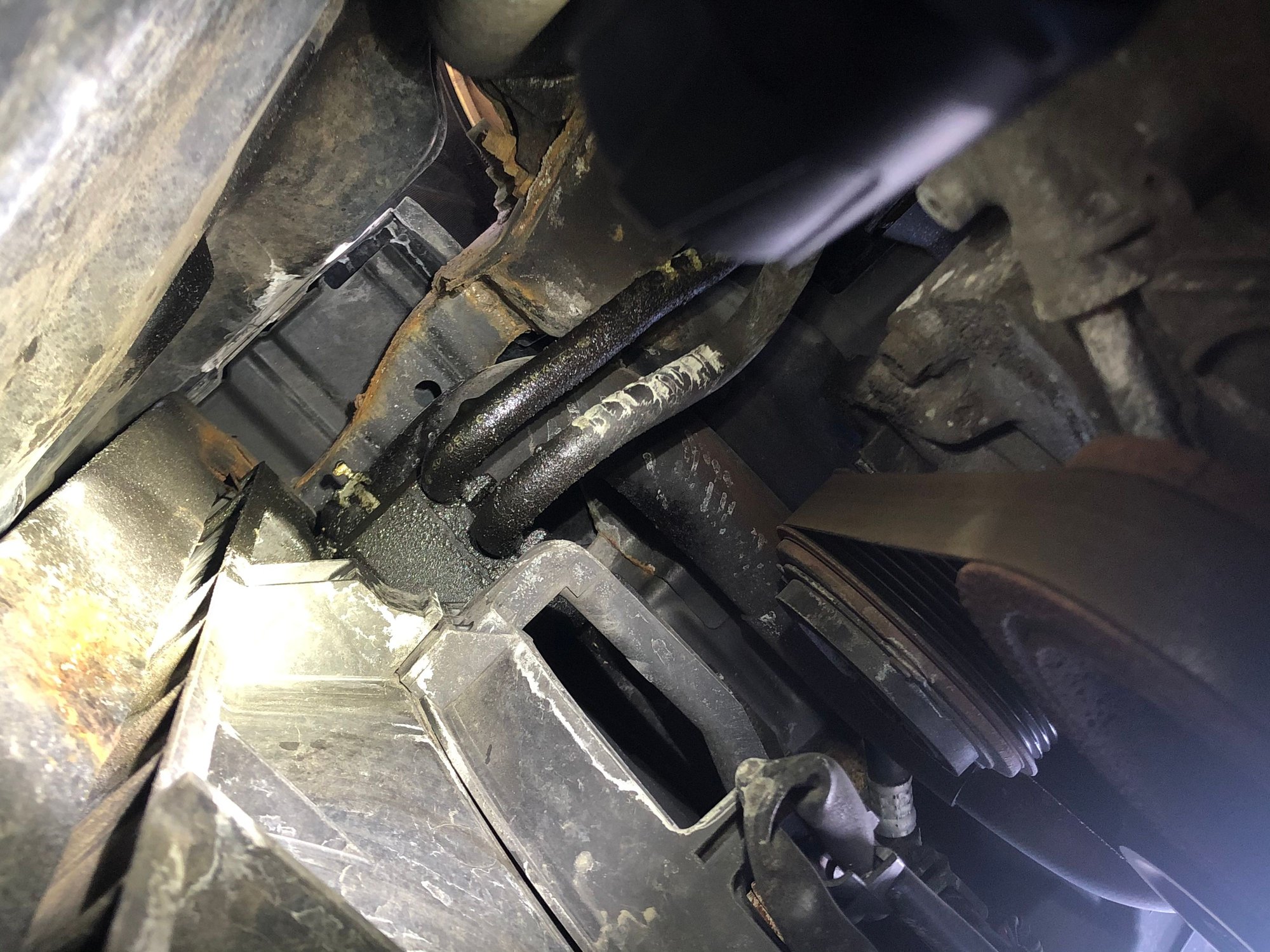

What actually is leaking?
I have 2013 G37x 120k miles now.
While I was changing my oil today, this is what I see through oil filter cover.
I cannot tell if that was power steering fluid leaking or transmission fluid leaking? I do have a small leaking power steering rack at front passenger but I just fill the fluid when it gets low. It takes like few months to get to low level.
May be I should use one of those power steering stop leak bottle?
Any advices/suggestions are welcome, thanks.

if you want to find the leak, you need to clean all that up. I mean, get the leaking oil off, the area clean, then watch it to see where the leak is coming from. Some people scrub, or use a power washer, some mechanics just use a whole bunch of bottles of parts cleaner or similar.
my understanding from the PS leak stop additives is that it swells the rubber seals, which can stop a leak - if it's leaking from one.

Our cars use transmission fluid for power steering fluid. I use Valvoline maxlife transmission fluid in my Volvos power steering and it works good for leaks.
