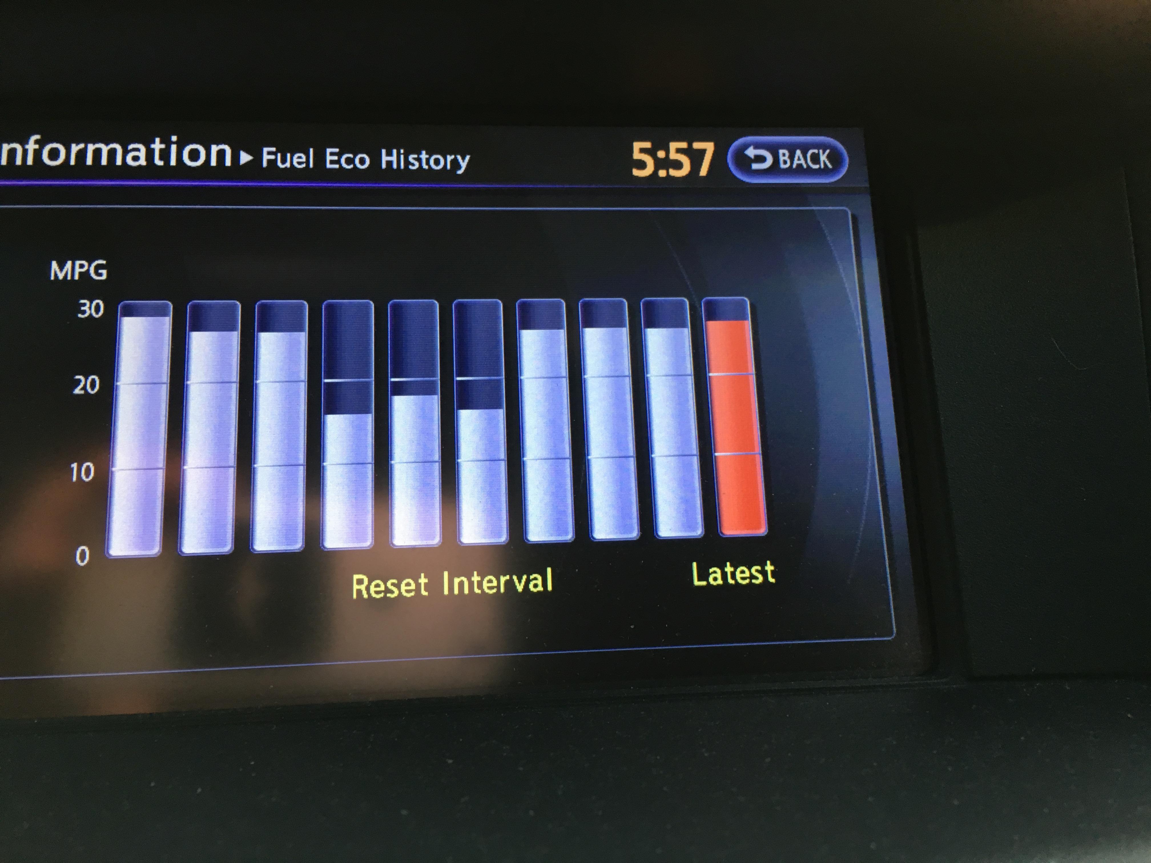

Car gets great mileage on the highway, but I’ve got about a dozen traffic lights that I always seem to be stopped at that don’t help much.
I'm on my third Infiniti since December 2005.
All three including my current Q70 get 25 MPG + on my trips from NJ to Florida.
17-18 MPG on short trips

You can see the severe drop in MPG during short frequent stops while in Florida

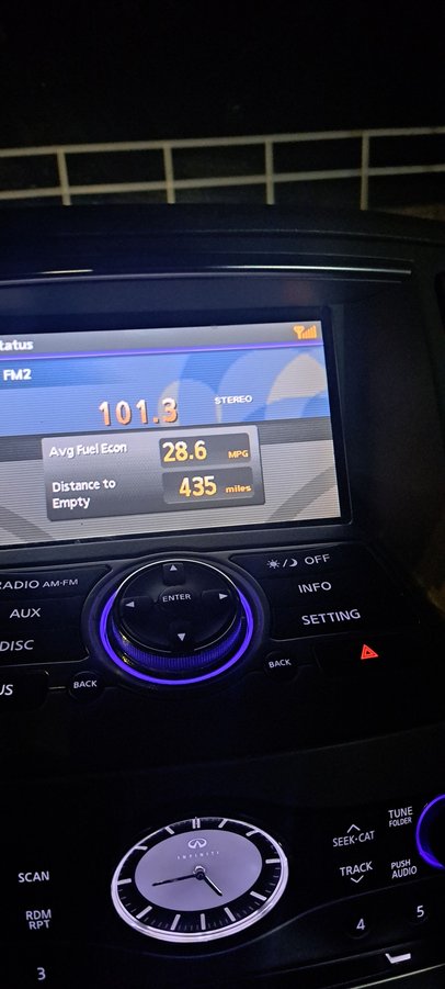

Bottom line, the g37 is decent enough on long distance highway trips. I can get 500 miles on a tank. I averaged almost 29 mpg on my most recent trip. However stop and go city driving will be around 12 mpg with conservative driving.
