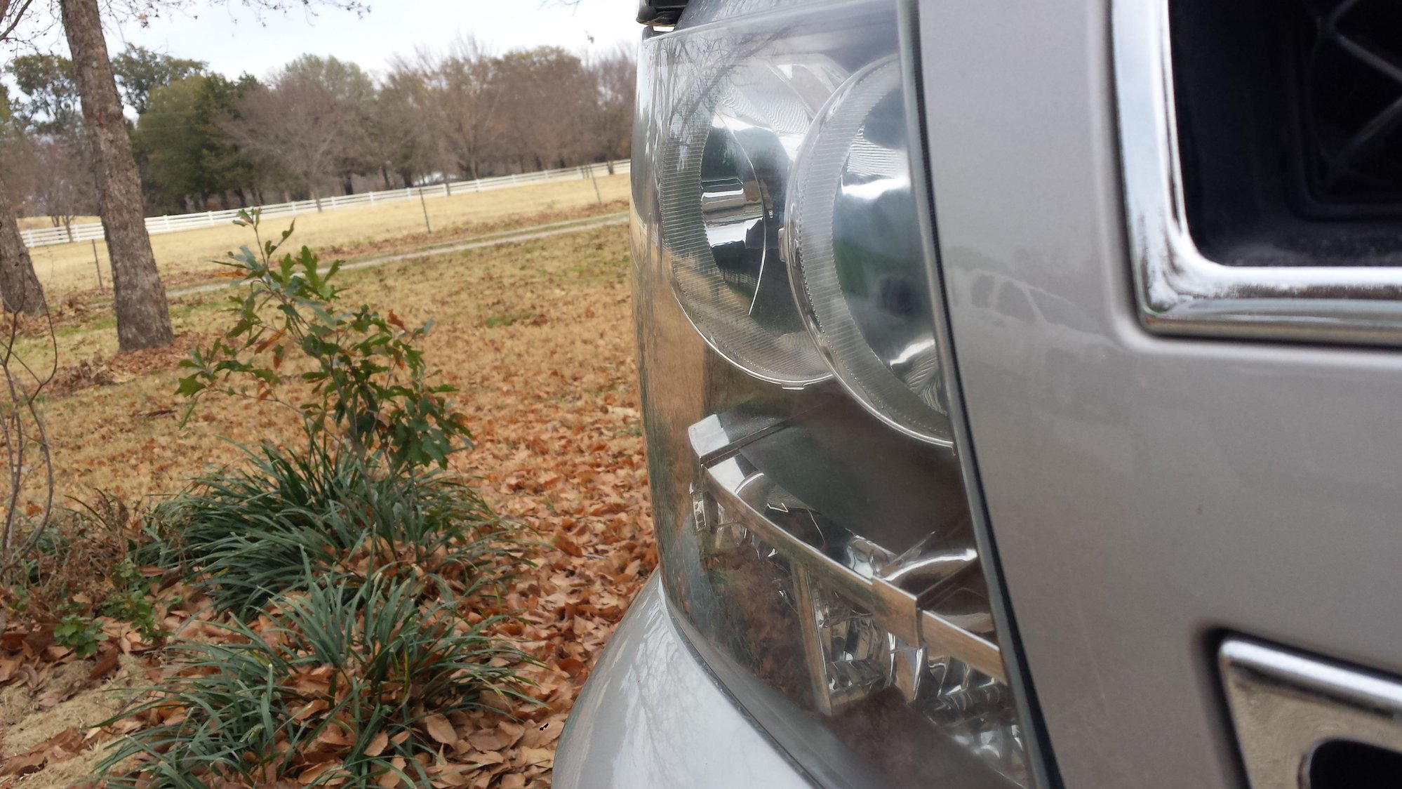

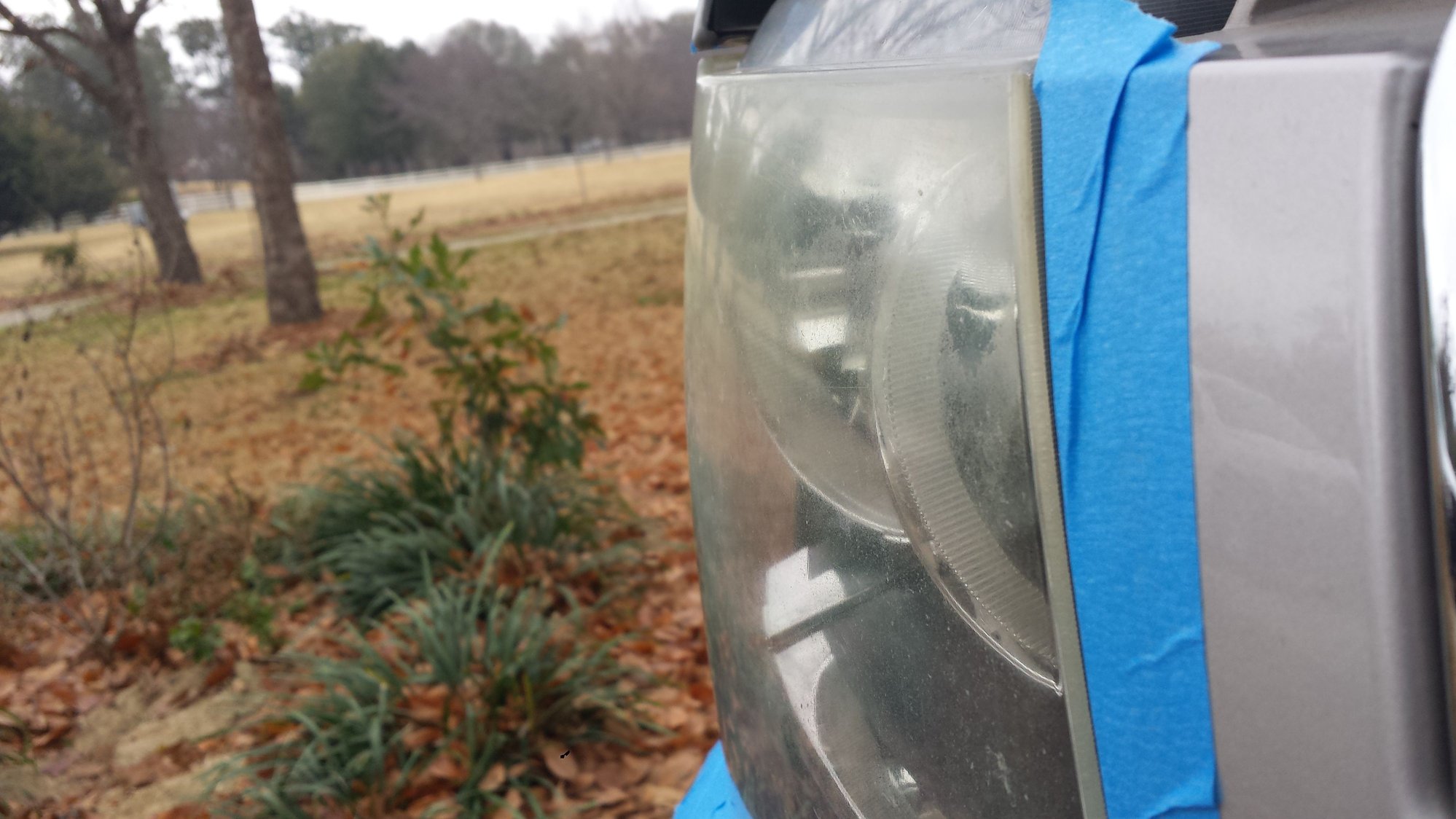

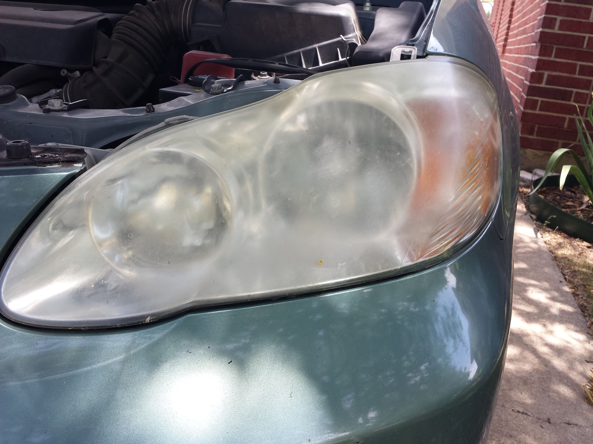

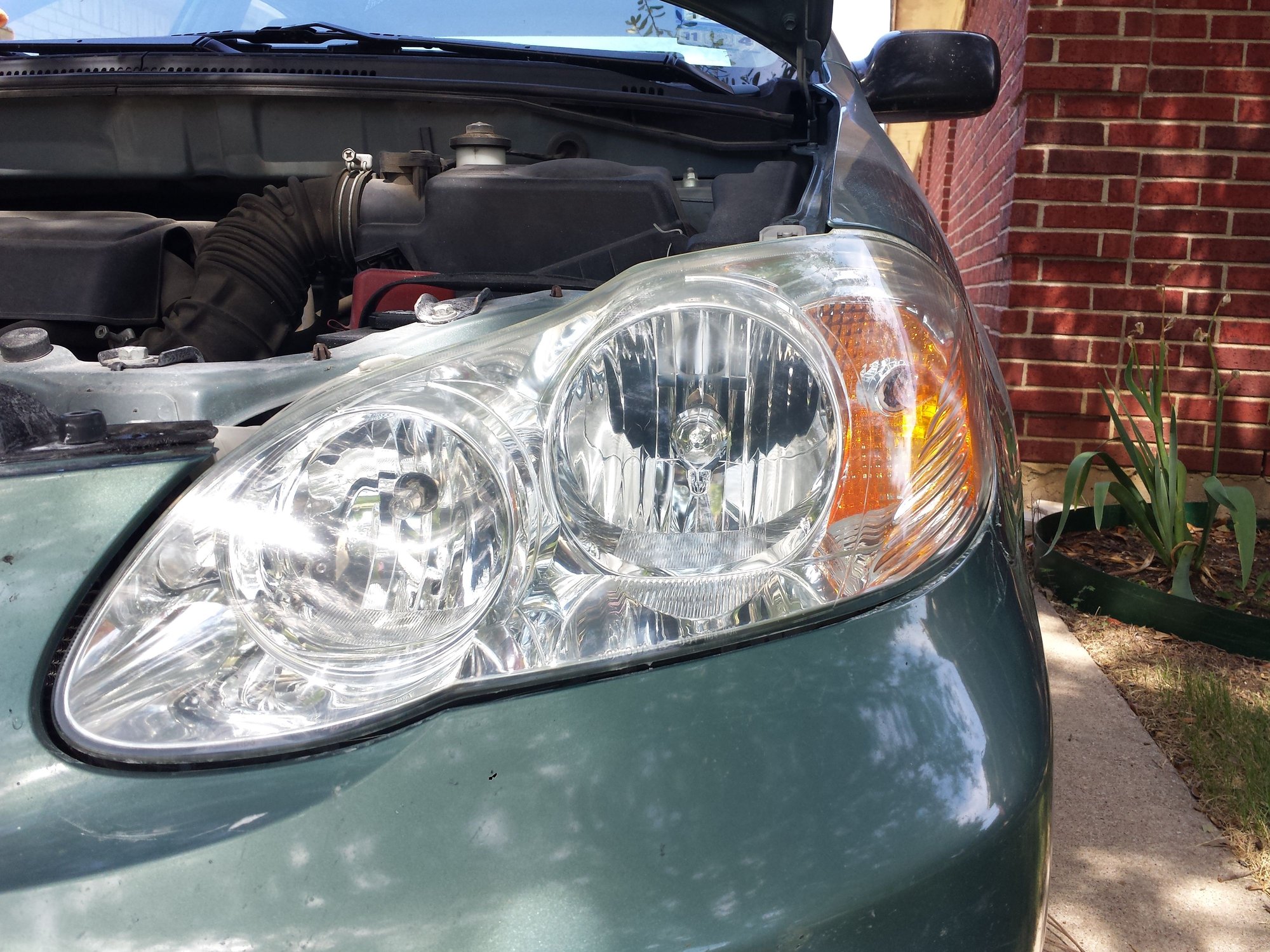

They aren't yellowing from the inside. An experienced detailer will be able to wetsand, compound, polish & seal them to look brand spanking new again. I have headlights that were re-finished in 2015 and had X-PEL film applied to them and they aren't yellow at all. The edges where the X-PEL film didn't cover is turning hazy though. That goes to show you sealing the headlights after refinishing them is #1 key to having clear headlights.
Be aware of the ****ty headlight restoration jobs that some places offer. It's usually $50-100 and all they do is take a pad and apply either compound or polish to the headlights. Sure it will look 'slightly' better but for how long? Maybe 4-6 months and they will start to look terrible again.
I work at a dealership and that's what our detailing department does.
Here are some cars that I personally did. This will give you an idea of what can be accomplished if you find the right person. Keep in mind that I am no professional and only did it as a hobby. You will yield better results from a actual professional and they will have sealant options to keep the results for years.

Corolla before
Corolla After
