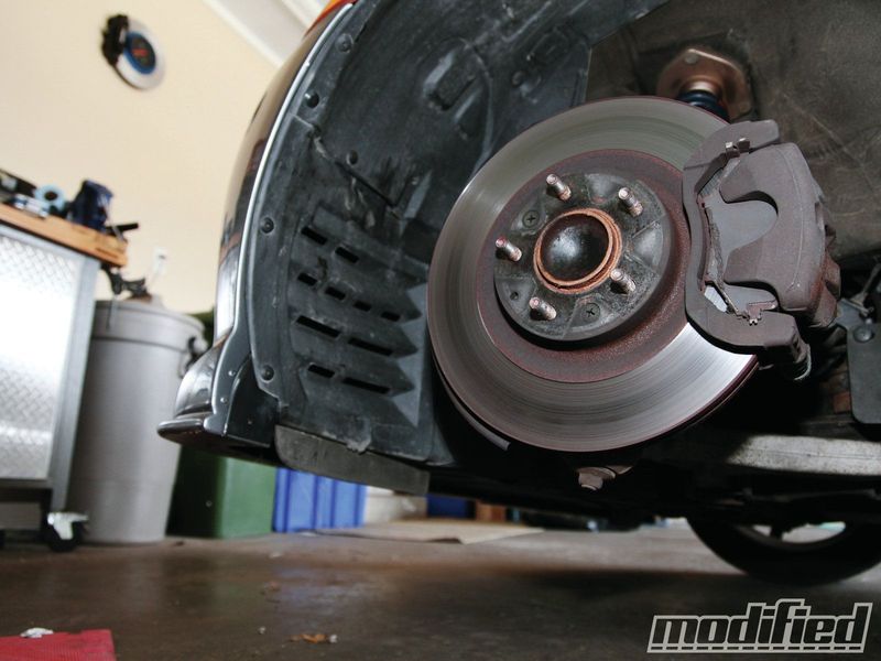

I did this with the fake mesh on my RX8 (rear bumper). You need to have someplace for the air to go. Slit vents in the wheel well liners like the RX8 would work - the '8 had the oil coolers there. Or hoses that point air to the brakes, which is probably a bigger help. I don't really have good pics of the rear cutout, but the front wheel well air exit is like so:
For the '8, I cut out the entire fake mesh and replaced with a metal mesh. I used an epoxy specifically intended for repairing urethane bumpers to glue it down at the edges after I formed a 1" overhang into something approximating the bumper shape. Then used sheet metal to make a duct/surface from rear bottom of trunk to the top of the cutout so the air would go somewhere - effectively a splitter without looking like one.

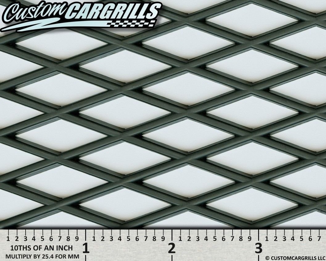

I did a custom mesh grill project before, and found that this plastic mesh closely matches the color, pattern and depth of the OEM lower grill. Not sure if practical for this project, but figure no harm in sharing.
https://www.customcargrills.com/prod..._Plastic_Sharp
