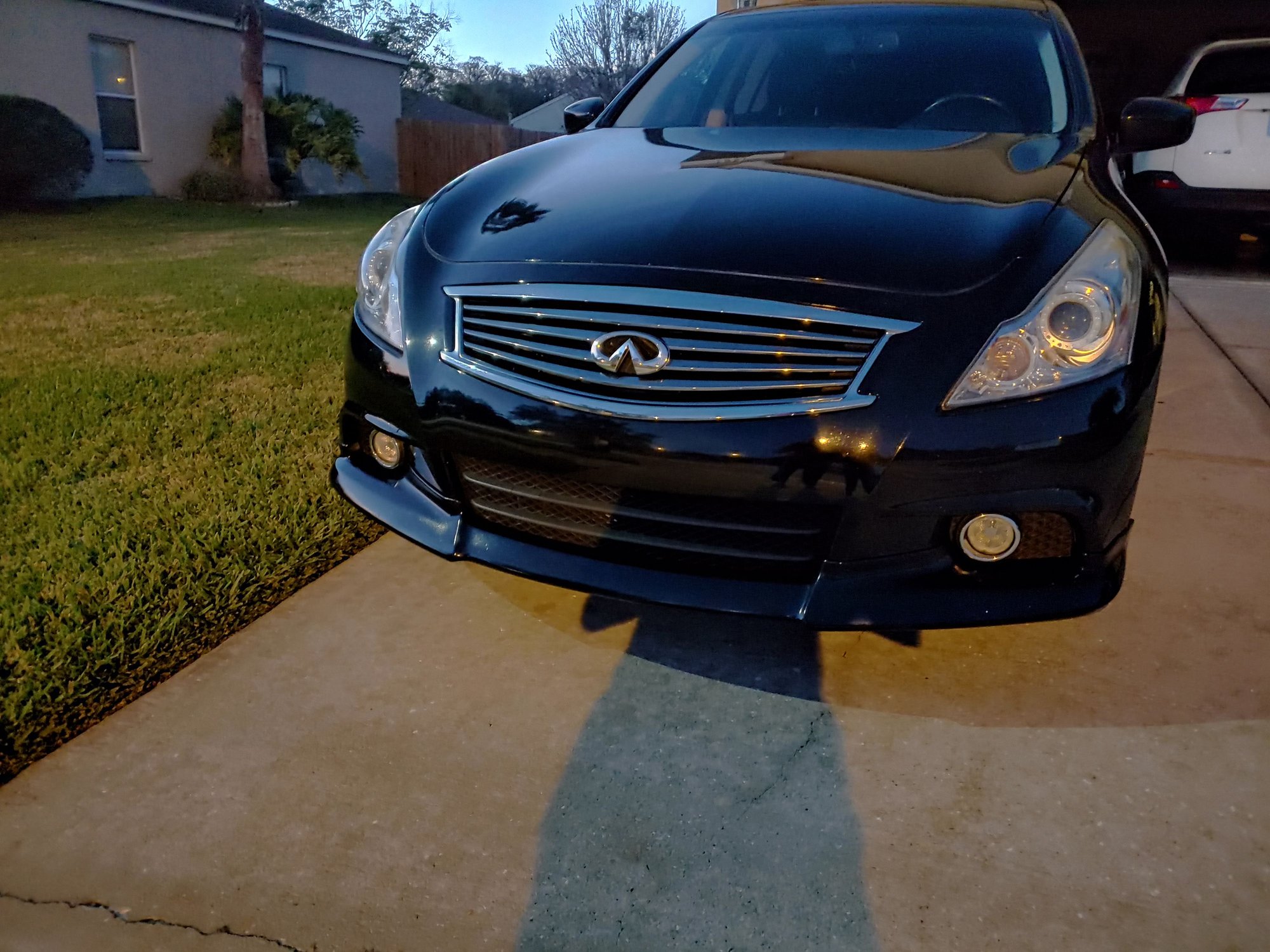

hey yeah will do, again, wish i could do an install like your altima, but even so, i don't think these would look anywhere close as that, as they are flat plastic....but yeah will post up some photos...also, maybe, thinking about something over the fog lights...the recessed location may help if its not too bright but being so close to ground and exposed....

MMmmmmm you got the sport bumper, you should try the line that curves over the fog not sure if that's what you ment when you mentioned the fogs

Yeah, that's what I meant but not on the curved part, more under the curved part...will move it around and try to figure out what works best...if any....

sweet plz send pics once you get it going n by any chance how are you wiring the leds?? I had my halos n led strips on an independent switch that was tap to the radio so as long as the switch is in the on position the lights came on once I turned the key this way I could just forget about them.

dude....thats magik i dont really know yet as there are 3 wires, so guess power to power source and the other 2 to a relay??will do some reading before i go splicing $hit and end up with a unlit car lol....

if your led strips have the switchback feature for turn signals then 1 wire is power 1 wire is ground n 1 wire is how you tap into your turn signal, should be black, white, yellow or red, black, yellow. Let me know. If no switchback feature than yea power ground relay. Let me know.

ok, it so it doesn't appear to have the switch back function...per their instructions, black to ground , red to acc source and the other do a t tap to the blinker wire...so guessing that will be my set up...that should work sufficiently, as i really wanted them more for a drl and then blinker at night, but most reviews say it isnt bright enough for drl, so going to do it without that option

if your taping into the turn signals then you have the switchback feature, which is the whole reason for tapping n you can achieve the same set up I had kinda by simply tapping into the back of you radio on the ignition wire, this way everytime you start your car the lights will come on n on a side note check this website out from my research they seem to have the brightest tube or extreamly flexiable switchback led strips n their sequential.
