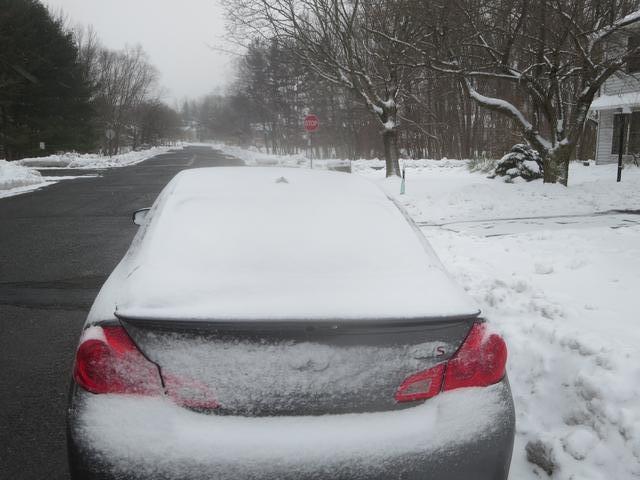

I never had a problem driving in snow with either my 06 G35 6 speed or my 2012 G37S 6 speed. I always had good Michelin all season tires and never used snow tires
Telcoman
