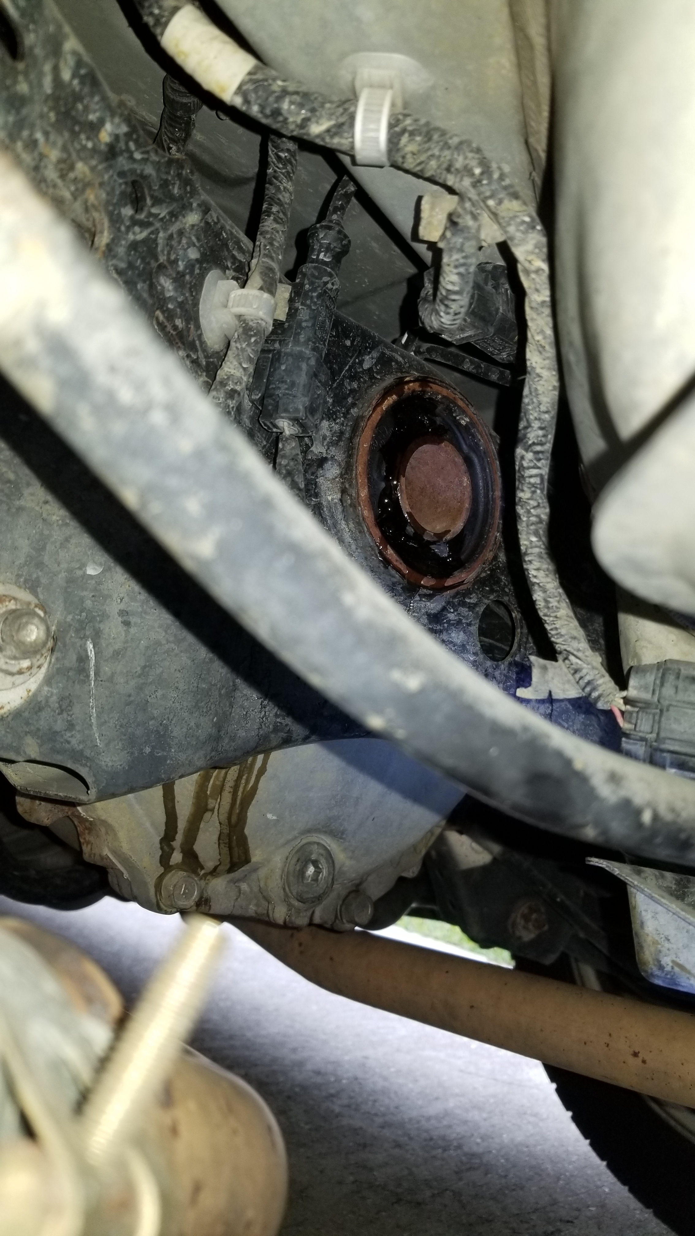

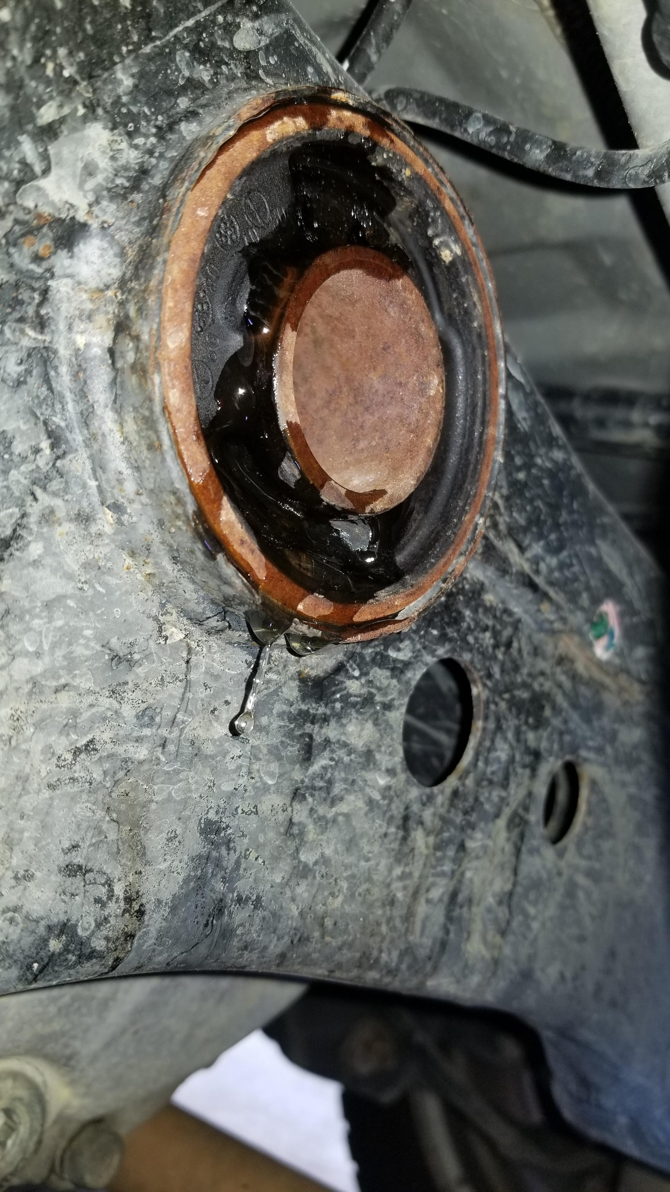

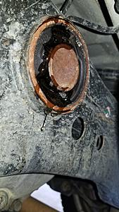

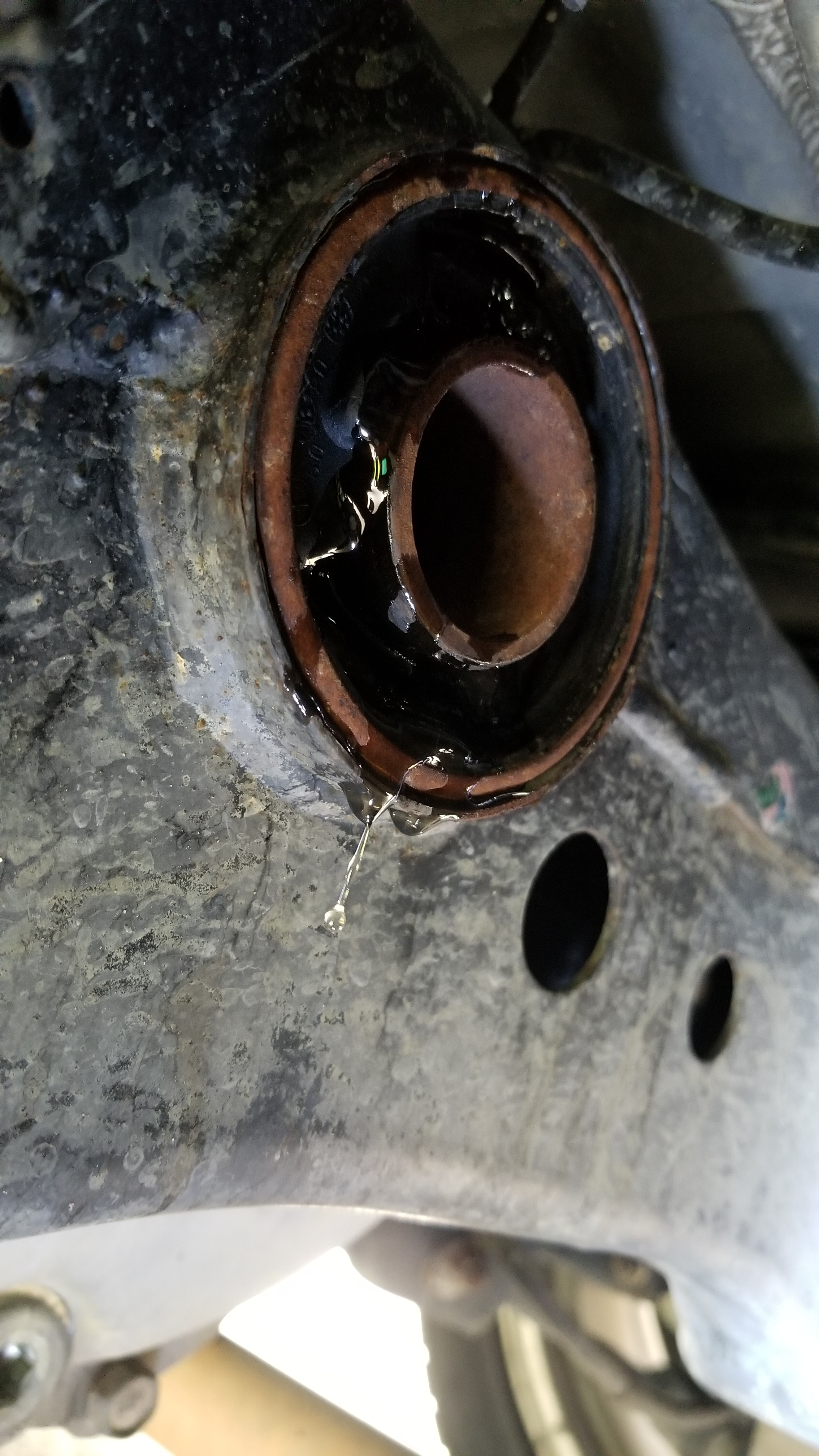

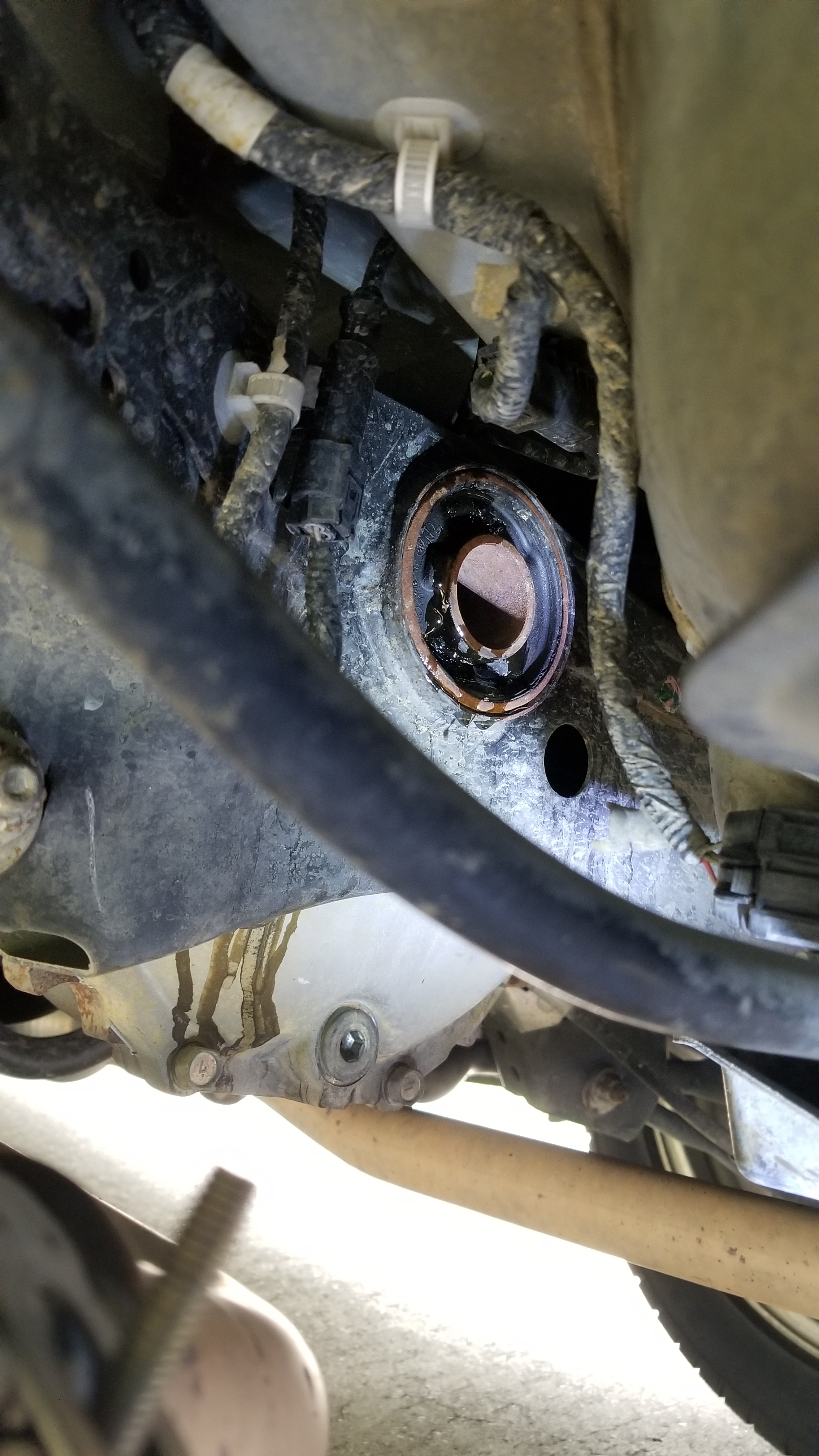

So i headed over to home depot. Picked up some JBWeld quick setting 4400 tinsel strength epoxy with mixing straw. $9.00 for 2 tubes.
I cut a hole in the cavity to make sure it was clean and empty. I also used this hole to inject the epoxy. I filled up the cavity till it leaked out, then just emptied the 2 tubes into it. I forgot to put a catch pan down, so i got a bit of it in the driveway... ooh well..
I will let you guys know how it worked out.
For me this is only temporary, till the winter when I hope Florida will be cooler so I can put the Z1 bushings in.
Thanks for all the help.

I've seen that fix before. Was meaning to do it to my own 07. From that previous post I saw, it held up pretty well with epoxy.
