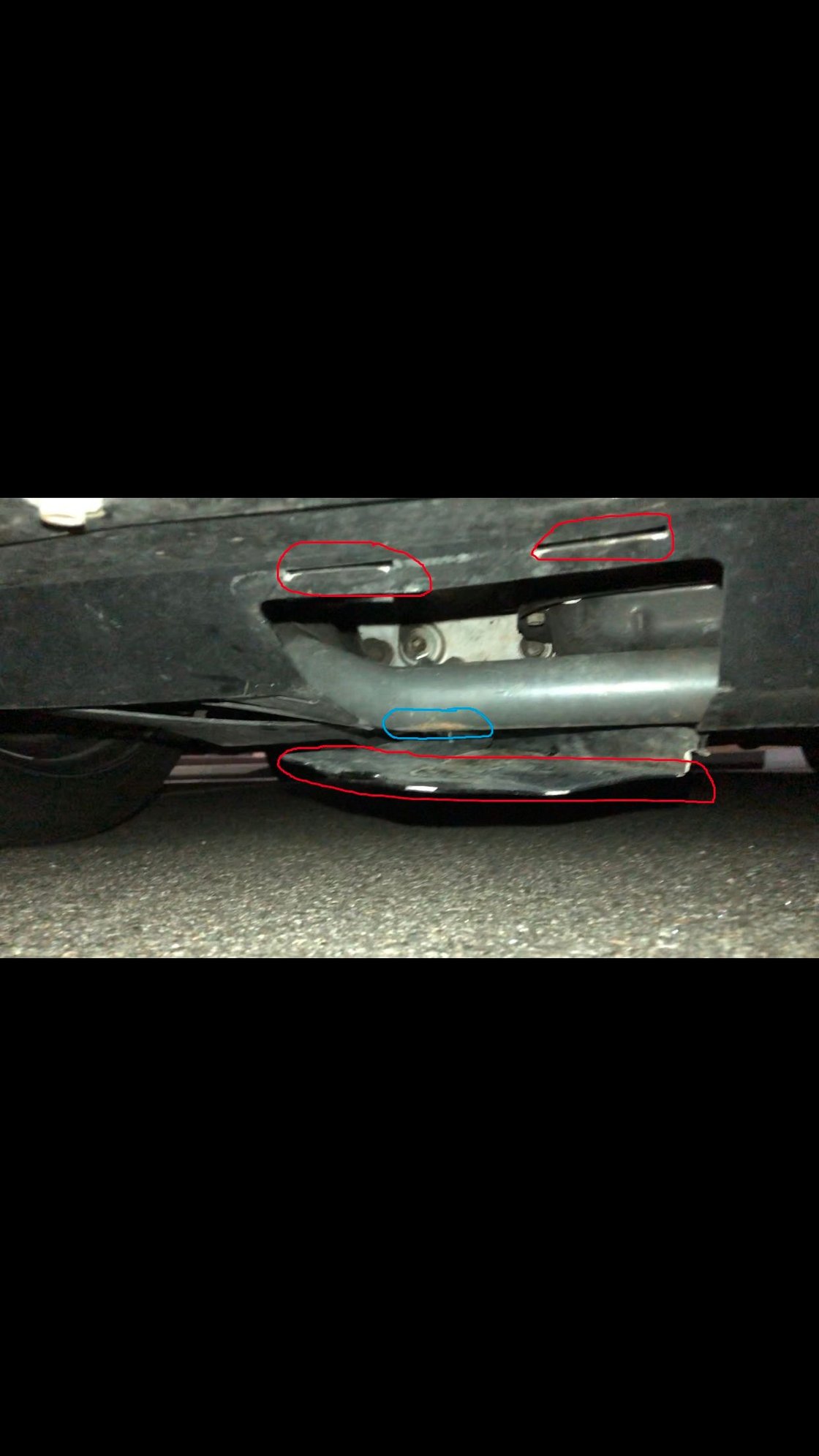

Back with visuals. The First picture and the red highlights indicate where the tray hatch holds itself and where the tray itself rests. The Blue circle indicates my first hit or scrape to my Hotchkis (1 week old, plus 2 weeks worth of rain).
The second picture highlighted in yellow is all of the bent and deformed aluminium on the tray itself after a year+, if you guys notice there is a heavy inward bend on the left side making it seem that the hotchs don't clear, then on the bottom the tray door is severely bent out of place where it will not be aligned properly to protect the hotchs. Hope this clears things up for you guys, anymore questions or concerns, let me know.

Originally Posted by c1utchh
That looks awful. Do your mounts for the Hotchkis sway bar bushings have zerk fittings and does the under tray clear them?
