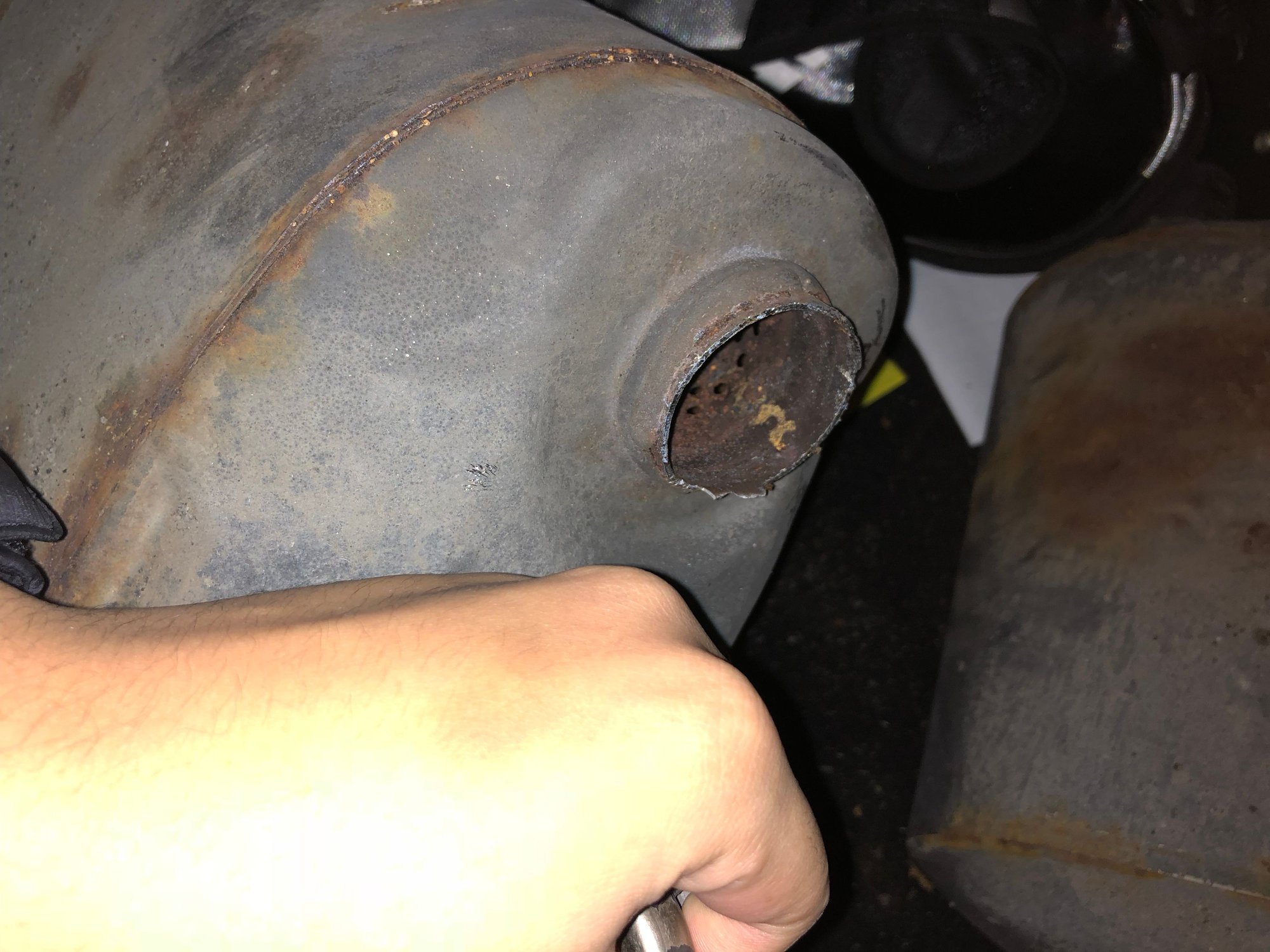

I deleted the mufflers of my 2013 G37x sedan by sawing them down. There are now only straight pipes left. I love that sound but it can no longer pass the state exhaust inspection. Is there any way to install mufflers back at relatively low cost?

Well how were they deleted? if you had done it properly it would be using the same clamp style as OEM.

I think he just sawed down the mufflers. Something like screws are still on the straight pipes. Btw, where can i get the OEM parts for the X sedan?

The mufflers are clamp on, why would you saw them off? Show a picture of what you actually have on the car right now.

Here are the pictures. The first two are what i have on my car right now. The third one is the muffler cut down. Thanks!

lmao wtf? why would anyone do that. It could have just been unclamped....
I mean I guess you can just pay someone to weld that back on...

Did you have that done at a shop? Because those whole pipes would have come off about 6 inches further up the pipe where those clamps are. If you're okay with it not being as quiet as stock, get an axleback exhaust. That will bolt right up to where the clamps are. The only way your OEM mufflers go back on is to be welded on. Otherwise you could see if anyone here is selling their OEM mufflers, alternatively they should be easy to get off a wrecked G at a junk yard.
