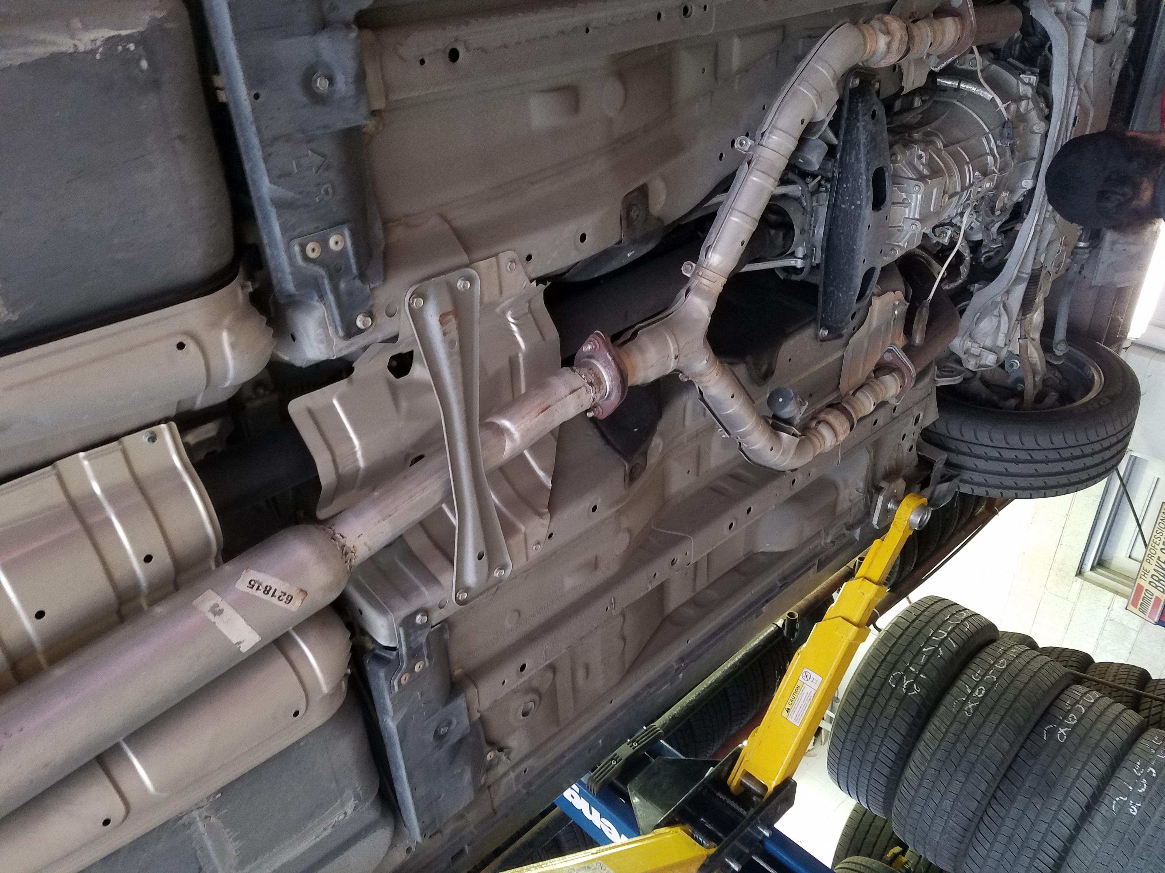

IF you want a single exit just do this. Go to an exhaust shop, hoist up the car on the lift and just literally explain to the welder what you want. I told my guy exactly where to bend it, what angle what pipe size where to weld the hangers and all that. You also get to pick your muffler which is good. I absolutely LOVE my HKS. It's huge, aggressive, quiet when cruising and I swear it screams like all hell when I let it.
edit: Also, you get to pick what resonators, what size and where and how many to include in the setup. I have one 12 inch glasspack that totally got rid of MOST of the rasp compared to other setups I've heard. Mine has rasp at a very narrow RPM band. Probably due to my ebay test pipes and stock y-pipe.

Photos of it. Little dirty and not great angles but it is what was on my phone.
